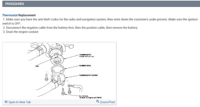

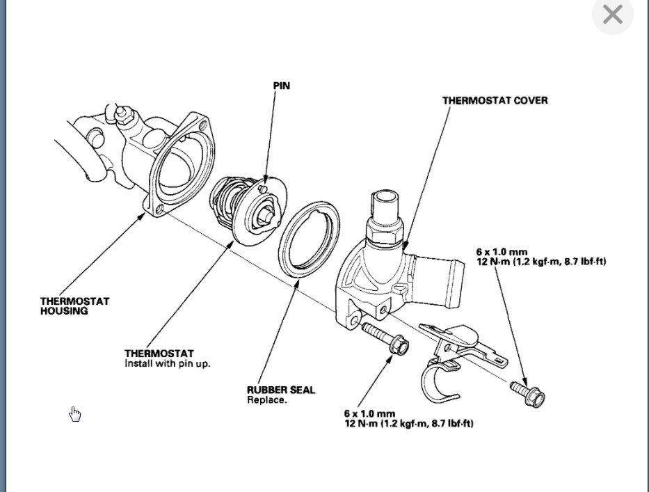

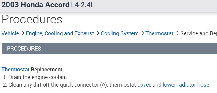

Here is a guide to help you step by step with instructions in the diagrams below to show you how on your car.

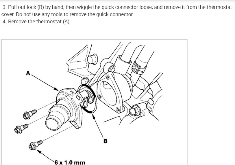

I know where the thermostat goes an the gasket. My question is where it bolts to behind that is there a gasket that goes there? there is a small opening behind that mount an i'm thinking a gasket there?
you have the water neck then thermostat then gasket then that bolts to another part. hope that helps explain.
Jul 1, 2021 at 9:32 AM (Merged)
  • CAR REPAIR CONTRIBUTOR

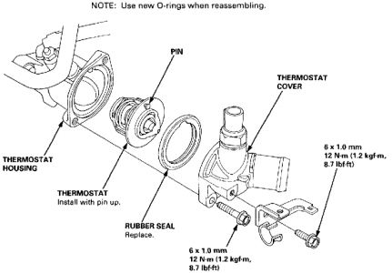

Take a look at this exploded view and tell me where you are seeing this other potential gasket.
I am just not sure exactly where you are seeing this. Thanks

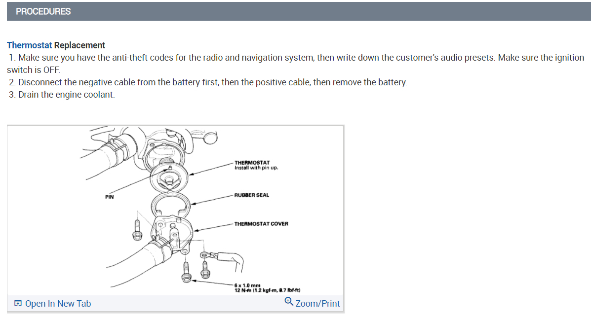

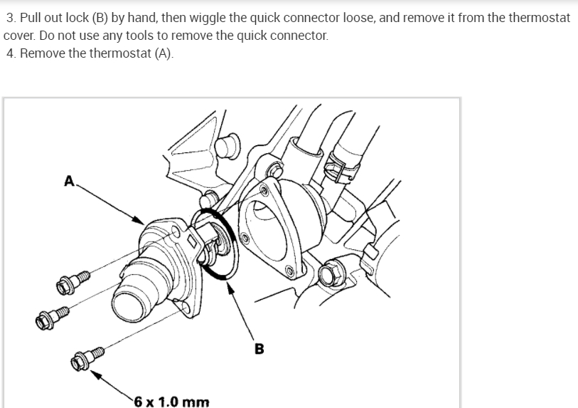

Hello, I'm Danny.

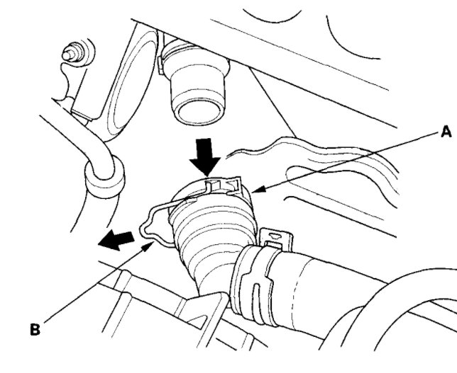

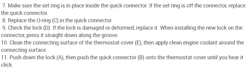

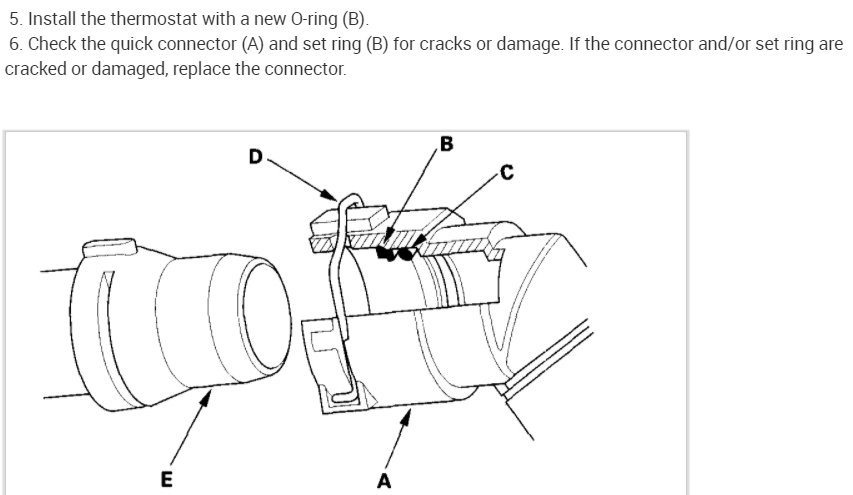

The thermostat in your car is sealed with a rubber o-ring, not a gasket. Here is a tutorial for you to view on how to change:
I've also attached picture step instructions below for your car. Hope this helps and thanks for using 2CarPros.

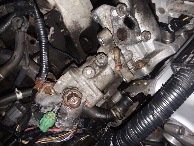

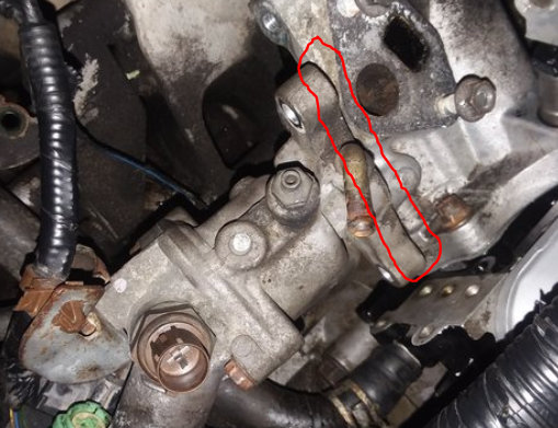

It's not the o-ring seal it's the thermostat housing parr the back side where it bolts onto that. i need to know if there is a gasket. I will try an take a pic.
All those parts in the pic bolt onto another part that's the area i'm needing to know. I will try take a picture.

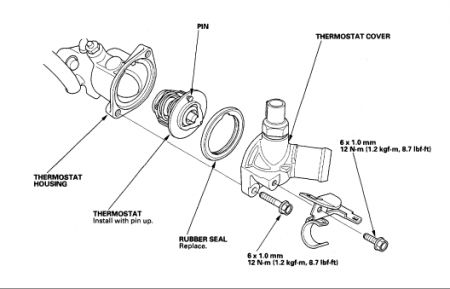

DANNY L
  • 5,648 POSTS
Hello again.
I've attached a picture from my prior post and circled an area in red.Is this what you are speaking of? Let me know.Hope this helps and thanks again for using 2CarPros.
Danny-
STACY ZIMMERMAN
  • 26 POSTS
Does not look like mine, not sure. But yes behind that housing has a opening. I will get pic to make sure and show it.

STACY ZIMMERMAN
  • 26 POSTS
Okay, got picture. It bolts to the side of where EGR valve sits.

DANNY L
  • 5,648 POSTS
Hello again.

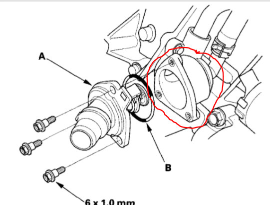

Okay, just to be on the same page I've attached your picture below.Where I've circled in red are you asking if there is a gasket or o-ring? Let us know and we'll get back to you.Thanks again for using 2CarPros.
Danny-
STACY ZIMMERMAN
  • 26 POSTS
Yes, that's the spot.

DANNY L
  • 5,648 POSTS

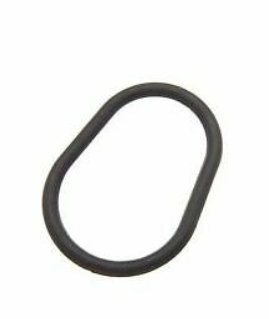

Hello again.
It shows the thermostat housing as using an o-ring to seal. I've attached a picture below as to what it looks like.Hope this helps and thanks again for using 2CarPros.
Danny-
STACY ZIMMERMAN
  • 26 POSTS
This one is used for the thermostat seal an not for the seal to the side of EGR valve?
Will check auto parts store an see if they have picture as well. thanks
DANNY L
  • 5,648 POSTS
Hello again.
That is the o-ring that goes from the thermostat housing to the EGR. The o-ring for the actual thermostat is completely round.Let me know if you have any further questions on this issue.Hope this helps and thanks for using 2CarPros.

What is the gasket if any to go between the EGR an the housing?
DANNY L
  • 5,648 POSTS
Hello again.
Both the thermostat and thermostat housing both use o-ring type gaskets.The thermostat o-ring that bolts to the head-EGR assembly which you are asking about is Honda part number-91312-P0A-000. Hope this helps and thanks again for using 2CarPros.

STACY ZIMMERMAN
  • 26 POSTS
So i have two gaskets as a o-ring one dor thermostat and then one behind to bolt to EGR valve side?
DANNY L
  • 5,648 POSTS
Hello again,
Yes, that it correct. You will have 1 o-ring to use with the actual thermostat and a separate 2nd o-ring to mount the thermostat housing to the EGR valve side.Hope this helps and thanks again for using 2CarPros.

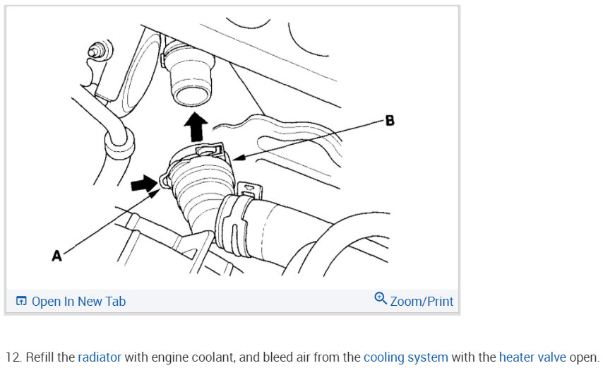

KHLOW2008
  • 41,814 POSTS
Hi Larry,
Yes, replacement is rather easy but after replacement, you must bleed the system of air locks.
Disconnect battery negative terminal.
Drain coolant from radiator by releasing the drain plug below the radiator.
Use plier to pull the lower radiator hose clamp on thermostat housing away from locked position.
Twist the hose gently and when it becomes loose, pull it out of housing.
Remove the bolt holding the ground wires. When installing, ensure this ground is secured well, failing which you would not be able to start vehicle.
Remove 2 bolts holding the thermostat housing.
Tap the housing gently and it will come off easily.
Remove the thermostat.
When installing, note the seating position of the gasket and thermostat.
After installation, loosen bleeder nut 2 - 3 turns on thermostat housing.
Turn on heater and set to maximum heat.
Fill coolant at radiator filler neck till no bubbles come out of the bleeder nut.
Tighten bleeder nut.
Fill coolant till radiator is full.
Start engine and when filler neck coolant level drops, top up with coolant.
Continue doing so till the level does not drop.
Once coolant level stabilises, and engine has heated up, close radiator cap.
Run engine and remember to check reservoir coolant level.
Wait for engine to cool down befor erechecking coolant level.
Top up if necessary.
Done.

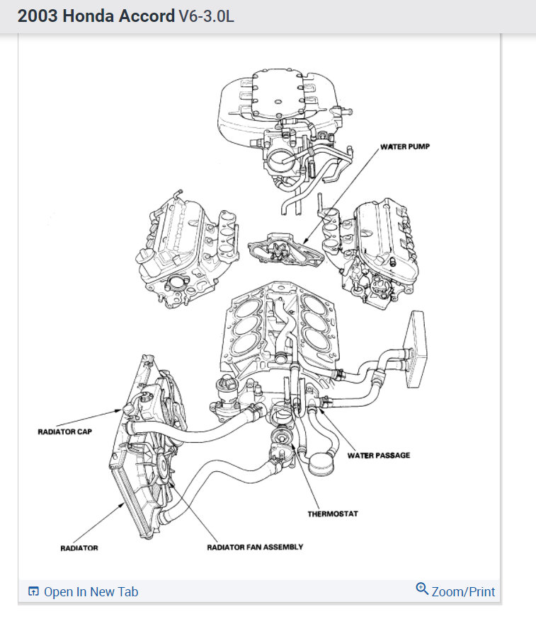

where is the thermostat
Jul 1, 2021 at 9:36 AM (Merged)
  • 75,992 POSTS
https://images.2carpros.com/forum/automotive_pictures/12900_t_12.jpg
