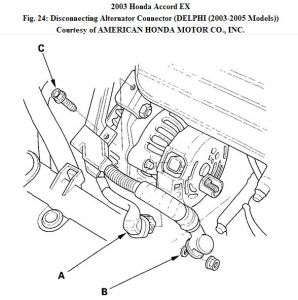

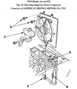

Where is the bolts for the Alternator assembly and
what tols are need.

3. Disconnect the fan motor connector (A) and compressor clutch connector (B), then remove the reserve tank (C).
4. Remove the two bolts (D), and loosen a bolt (E), then remove the condenser fan shroud.

6. Disconnect the alternator connector (A) and BLK wire (B) from the alternator.
7. Remove the bolt (C) securing the harness holder.
8. Remove the mounting bolt (A) and alternator bracket mounting bolt (B), then remove the alternator.
