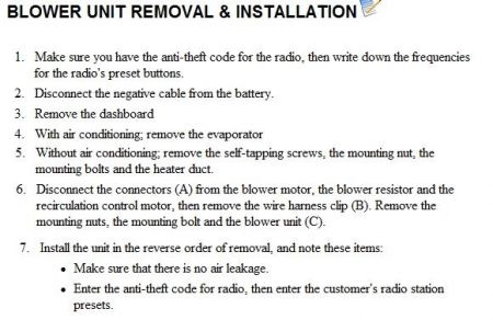

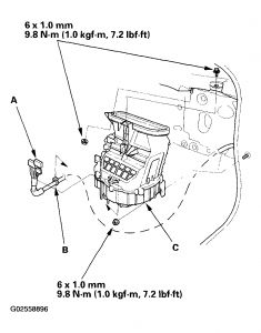

What is the replacement procedure for the AC evaporator fan or blower motor?
Wednesday, May 26th, 2010 AT 11:34 AM

Wednesday, May 26th, 2010 AT 11:26 PM
