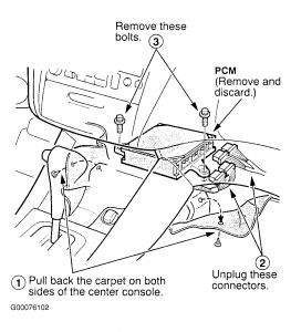

REPAIR PROCEDURE A
1998-99 ACCORD L4 (MODELS WITH A/T)
1. EX models only: Make sure you have the anti-theft code for the radio.
2. Write down your customer's radio station presets.
3. Disconnect the negative cable from the battery.
4. Remove and discard the PCM.
https://www.2carpros.com/forum/automotive_pictures/55316_accordpcm_1.jpg
5. Install the appropriate new PCM.
6. Reconnect the negative battery cable.
7. EX models only: Enter the anti-theft code for the radio.
8. Enter your customer's radio station presets. Reset the clock.
9. Store the immobilizer system key codes in the PCM with the PGM Tester; see Service Bulletin
00-049, Immobilizer System (Type 2), filed under Body Electrical.

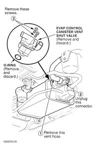

PROCEDURE B
1998-99 ACCORD (MODELS NORMALLY DRIVEN IN ANY OF THE STATES LISTEN IN "APPLIES TO" HEADING)
1. Raise the vehicle on a lift.
2. Remove and discard the EVAP control canister vent shut valve and O-ring.
https://www.2carpros.com/forum/automotive_pictures/55316_accord1457_1.jpg
3. Install the new vent shut valve and O-ring.
4. Lower the vehicle.
