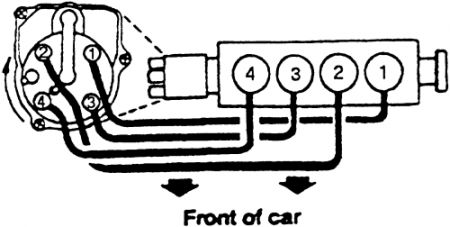

How can I put my spark plug wires in order or how do I know if they are in order
Wednesday, January 28th, 2009 AT 10:16 PM
BLUELIGHTNIN6
MECHANIC
16,542 POSTS
Firing order for your vehicle is below.
2.2L and 2.3L Engines
Firing order: 1-3-4-2
Distributor rotation: Clockwise
