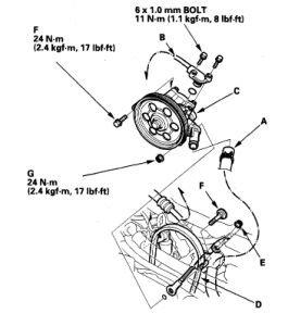

I would like to replace the power steering pump on a Honda Accord 2002 V6. My questions is where is the adjustment to loosen the serpentine belt, in order to swap out the steering pump? It is on a friends car, so technically I have not searched for an idler pulley screw of any sort yet. I just want to save time by knowing what to look for before I check under the hood. The part will be in next week.

Here is the step by step.....specifically step 5 talks about the belt. Good Luck.

https://www.2carpros.com/forum/automotive_pictures/248015_1_11.jpg
Cover the crankshaft pulley with several shop towels to protect if from spilled power steering fluid. Disconnect the pump inlet hose (A) and pump outlet hose (B) from the pump (C), and plug them. Take care not to spill the fluid on the body or parts. Wine off any spilled fluid at once.
Remove the belt (D) by loosening the pump adjusting nut (E), then remove pump mounting bolts (F), nut (G) and pump. Do not turn the steering wheel with pump removed.
Connect the pump outlet hose and inlet hose. Tighten the pump fittings securely.
Loosely install the pump in the pump bracket with the mounting bolts and nut.
https://www.2carpros.com/forum/automotive_pictures/248015_2_7.jpg
