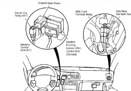

When turned off, and then try to restart it won't start after sitting there for awhile it will start with hesitation.

Check the PGM-FI main relay. The symptom fits the problem.
https://www.2carpros.com/forum/automotive_pictures/192750_PGMFIRelay97Accord_1.jpg
