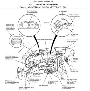

The SRS light is on. I know this is for the safety restraint system (air bag). Is there a scanner I can buy/use to scan the body control module to locate the fault code. How can I reset the light. The diagnostic connector is on the driver’s side under the panel on the right of the steering wheel. I know it is not a OBD II connection but I am not sure what type of connection it is.

The one under the driver side is the Memory Erase Signal ( MES ) connector and is for resetting the SRS light.
The SCS is under the passenger side
RETRIEVING DTCS
Turn ignition off, connect SCS Service Connector (07PAZ-0010100) to service check connector( a paper clip would do). See Fig. 1 . Turn ignition on. SRS indicator light will come on for about 6 seconds, and then go off for 2 seconds. After 2 seconds, SRS indicator light will:
"Â Quickly flash on and off (no DTCs are set in memory), or
"Â Begin flashing DTCs
https://www.2carpros.com/forum/automotive_pictures/192750_SRSComponent95AccordFig01_1.jpg

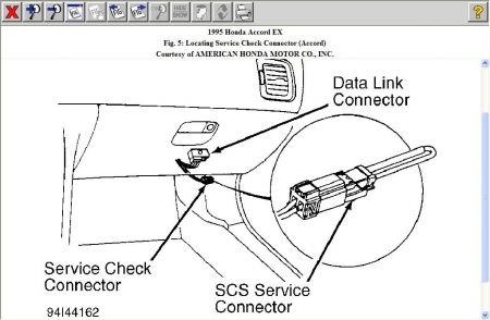

I did the two wire connector on the left (drivers side) and after the two blinks the light comes on and stays on. I tried to look behide the glove compartment and didnt see a two wire connector. I saw and red connector and blue connector.

The SCS is behind the glove box near the center console. It should be plugged into a green rubber socket. Next to it would be the DLC, a 3 pin connector. DO NOT use the 3 pin connector.
2 wire connector should be grey in color.
https://www.2carpros.com/forum/automotive_pictures/192750_SCS95Accord_11.jpg
