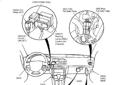

My son's honda will not start in the heat of the day. Once the day cools off, it will go forever. We were told it is vapor locking. How can we fix this.

The PGM FI main relay is known to cause intermittent non starting especially in hot weathers so I would suggest checking that first. Remove relay and check the circuit board solderd joints. If any are found to be cracked, resolder them and the problem should be resolved.
https://www.2carpros.com/forum/automotive_pictures/192750_PGMFIRelay95Accord_6.jpg
