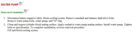

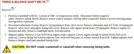

I would like to know how to replace the water pump
in a 1992 Honda Accord EX Thank You
Wednesday, September 22nd, 2010 AT 12:28 PM
BLUELIGHTNIN6
MECHANIC
16,542 POSTS
Wednesday, September 22nd, 2010 AT 3:07 PM
