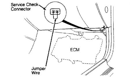

Go into self diagnostics to see if you can retrieve an codes. The D4 and MIL indicating can mean a sensor circuit is open.
Connect a jumper wire across the SCs and turn the ignition switch ON. The MIL should blink the trouble code is any is registered. Likewise the D4 would blink its trouble code.
A delay flash indicates a count of 10 while a quick flash is 1. A longer pause would occur for the next code if there are more than 1.
http://www.2carpros.com/forum/automotive_pictures/192750_SCS91Accord_12.jpg
