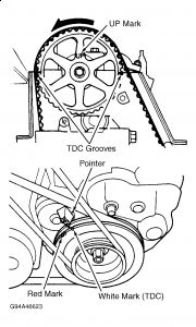

It sounds like something isn't in line. Either the timing belt tensioner wasn't all the way tensioned or the distributor is out or? I would check my timing marks first now that it is popping.
https://www.2carpros.com/forum/automotive_pictures/249564_Graphic_176.jpg
+1
Wednesday, September 30th, 2020 AT 10:05 AM
SHAWNEE99
  • 19 POSTS
I checked the distributor and it does rotate while cranking. I will check the timing marks. I just put it back together and really hate to go through that process again. I will let you know.
Thanks.
RACEFAN966
  • 5,029 POSTS
If you check out the pic I included you should only have to pull the upper cover and then put on TDC and see if the timing mark lines up and the cam marks line up and distributor is pointed to number one. Make sure you are on the compression stroke.

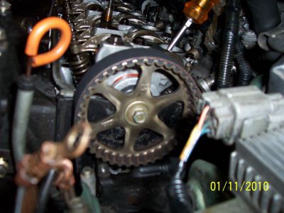

SHAWNEE99
  • 19 POSTS
I checked the TDC marking on the cam. They correct on the compression stroke with the distributor firing at #1 cylinder. The markings on pulley, balance shaft and oil pump are correct. Any other suggestions?

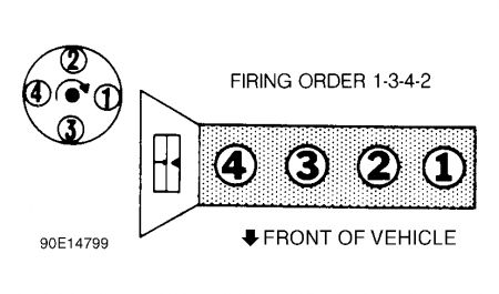

I still think that the distributor is out. I would recheck the timing alignment and then make sure you are on compression strock with both valves closed in cylinder 1 and then make sure the distributor isn't 180 degrees out, or that the plug wires are in the right order. Here is pic of the firing order and the distributor rotation. Check this first before going in to deep ok. Let me know what you find.
https://www.2carpros.com/forum/automotive_pictures/249564_Graphic_181.jpg
SHAWNEE99
  • 19 POSTS
I rotated the plugs to the correct firing order. The vehicle started but runs like it did before. Missing and boggs down with acceleration of the gas pedal. The engine light is also on while the car is running.

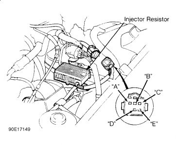

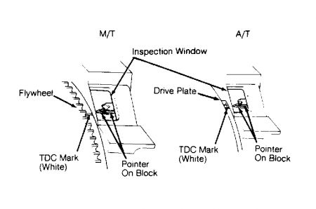

Ok great it runs again that is a step in the right direction. Now lets check the timing ok. First pull the rubber plug on the top of the bellhousing on the back side of the engine. Now remove the kick panel on the passenger side. Now you will find a two wire terminal with one orange wire with a red stripe and one wire that is green with white stripe. Make a jumper wire or use a paper clip and jump the term (see pic below). Now start it and check the timing (refer to second pic below). Let me know how it goes.
https://www.2carpros.com/forum/automotive_pictures/249564_Graphic_182.jpg
https://www.2carpros.com/forum/automotive_pictures/249564_Graphic1_29.jpg
SHAWNEE99
  • 19 POSTS
I jumped the above mention jumper, started the car and checked the white TDC line. The line stays mostly in the middle and bounced a little before or after the pointer on the block. It is running but still missing. The engine light blinks slow then rapidly.
