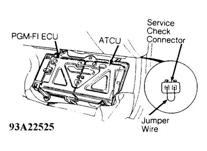

1992 Honda. Runs great sometimes.
Problem:After driving for awhile if we stop at a store, and get back in to start it, The transmission light (D4) starts blinking. The car will turn over, but not start. The shifting handle locks up and we can not even shift out of park. If we wait 10 or 15 minutes. It starts right up. Oil, water and tranny levels are fine.
Thursday, July 24th, 2008 AT 6:41 AM
12 Replies
2CARPRO JACK
  • 11,533 POSTS
That is the PCM's way of telling you it has recorded a fault in the system. Go to connector (see diagram) and install jumper wire, count flashes and get back to me with what you find. This will be the fault code. Do the brake lights work ok?
https://www.2carpros.com/forum/automotive_pictures/1639_Honda_1.jpg

I did not orginally post this question. However, I am having a very similar problem. After performing th self-diagonistics as mentioned. The results appeared to be 4 long blinks followed by 3 short blinks. These were not from the "D4" light, but from the "Check Engine" light. Any help would be greatly appreciated.
Wednesday, September 30th, 2020 AT 10:20 AM
2CARPRO JACK
  • 11,533 POSTS
A code 43 from the check engine light is "fuel system or oxygen sensor ckt. Need to check for fuel pressure next time it wont start

OK, I replaced the main relay and have not had the problem with the "D4" light and not starting for a week now. However, my son is still saying that when the car has been out in the sun for some time it appears to intermittantly want to stall at highway speeds. I did the diagnostic test again and the check engine light just stays on, it does not blink at all. Is this normal?
KHLOW2008
  • 41,814 POSTS
When the SCS connector is bridged, the Check engine will stay on without any blinks if there is no fault codes encountered.
Stalling, hesitation or loss of power at highway speed are usually due to fuel starvation if no error codes are detected. Check for clogged fuel filter and kinked fuel lines.
You mentioned code 43, is it still showing?
