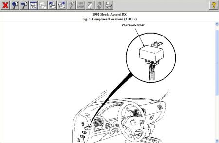

The symptoms are consistent with a faulty PGM-FI main relay located underdash. The relay is known to intermittently cause problem due to cold solders on the circut board. Resoldering the joints would usually get the problem resolved. Alternatively is to get the replay replaced.
https://www.2carpros.com/forum/automotive_pictures/192750_PGMFIRelay92Accord_8.jpg
