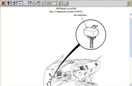

This symptoms is commonly caused by an intermittently malfunctioning PGM-FI main relay. The contacts on the circuit board is faulty and resoldering them usually works.
https://www.2carpros.com/forum/automotive_pictures/192750_PGMFIRelay92Accord_2.jpg
