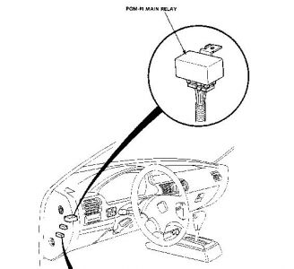

Seems you are having a problem with the PGM-FI main relay which is known to fail intermittently. If you can do soldering,remove the relay and resolder the circuit board and it should work as good as new.
https://www.2carpros.com/forum/automotive_pictures/192750_PGMFIRelay90Accord_2.jpg

Thanks a lot for your help ! Just for clarification: you mean remove & throw away the existing PGM-FI main relay, then get a new one & solder it back again?

No, resolder the old unit and it should work as good as new, maybe better. It would not fail you again.

Since I'm not very good with soldering, I replaced the relay with a brand new one bought from Honda dealer (cost me $125 CAD).
Still no luck at all. Tried several times, engine turn strongly but wouldn't start. Please help !
