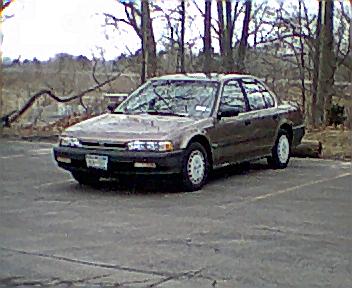

1991 Honda Accord 4 cyl Front Wheel Drive 113000 miles
indicator on dash board has rear light warning in red..all lights work..but the car sits for a week and the battery is dead..charged the battery and it reads good..can't figure it out

Dash indicator has brake bulb check indicator light with the wordings "BRAKE ". If that is the inbndicator turning on, then one of the brake bulb or its circuit is bad.
If it is a rectangle, then the rear trunk lid switch circuit is turned on.
