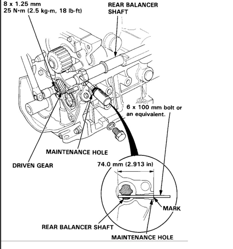

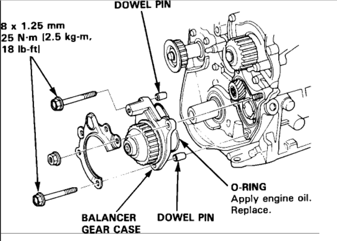

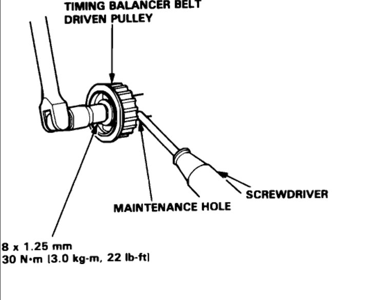

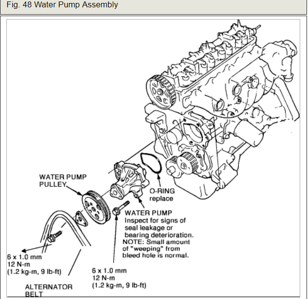

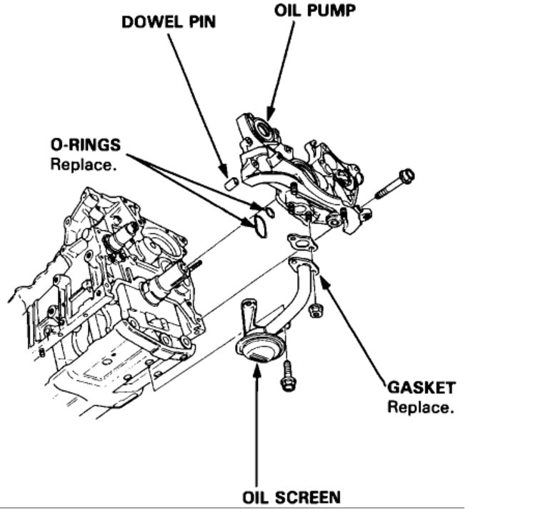

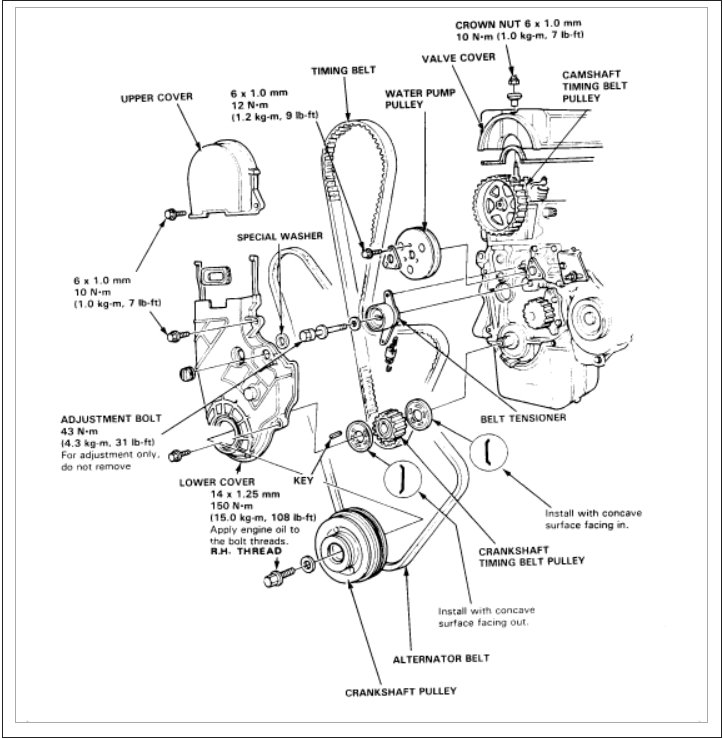

Massive engine oil leakage?
KEN L
  • MASTER CERTIFIED MECHANIC
  • 55,481 POSTS
There is an oil pump o ring seal that sits in the front of the engine just behind the timing belt. We see them leak from there all the time.
Here is a guide and some diagrams to help you get the problem fixed.
https://www.2carpros.com/articles/engine-is-leaking-oil
Please let us know what happens and upload pictures or videos of the problem.

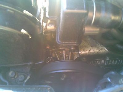

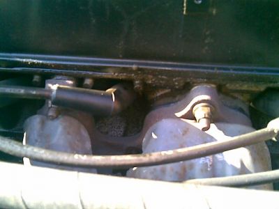

88HONDAACCORD
  • 13 POSTS
Her is to picks i took
(((number one is the driver side of the car))))
(((number two is the valve cover))))
https://www.2carpros.com/forum/automotive_pictures/64040_pick_of_oil_leak_2.jpg
https://www.2carpros.com/forum/automotive_pictures/64040_valve_cover_2.jpg
Tuesday, August 25th, 2020 AT 11:58 AM (Merged)
BRUCE HUNT
  • 3,754 POSTS
Get a valve cover gasket and pull that head off. Check the valve train assembly for any loose items and any foreign materials floating around.
