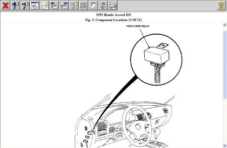

my car dosent start I would like to find out what you think. So im getting gas and spark but no gas threw the injectors?

Hi fhuston,
Check the PGM-FI main relay and fuel pump.
