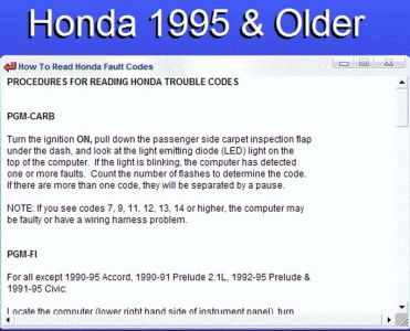

Start by reading the codes, here's how...to count the flashes, a 22 would flash 2 times then a short pause and 2 more flashes, the pauses are longer to seperate additional codes if more than one is stored
https://www.2carpros.com/forum/automotive_pictures/62217_Code_ReadingOBDI_1.jpg
