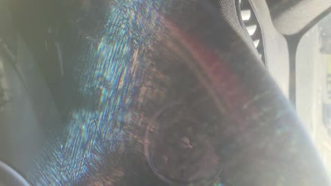

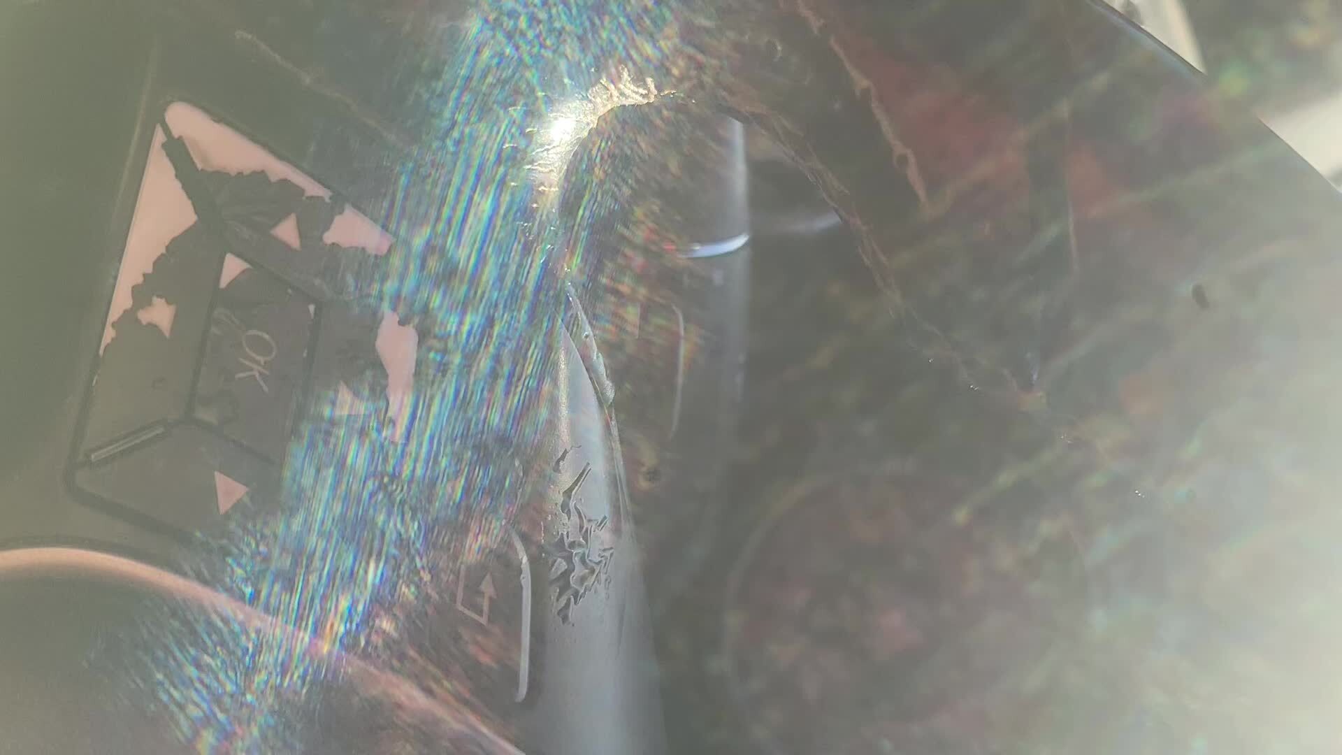

This is the best I can do. It's not very loud outside of the car. And the camera barely picks it up when recording inside car. No smoke, no burning smells or any smells, no check engine, nothing leaking. The engine is not getting hot.

Can you tell where the noise is coming from, front, rear, engine or transmission? Is the noise louder when you open the hood, will it make the noise when you are not moving, also do you have any warning light on? Sorry I could not tell much by the video.
