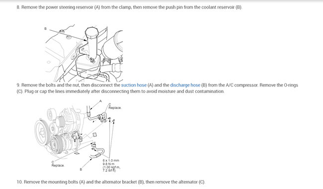

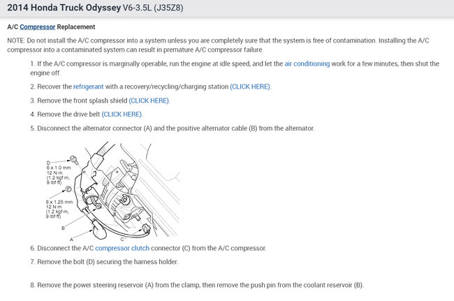

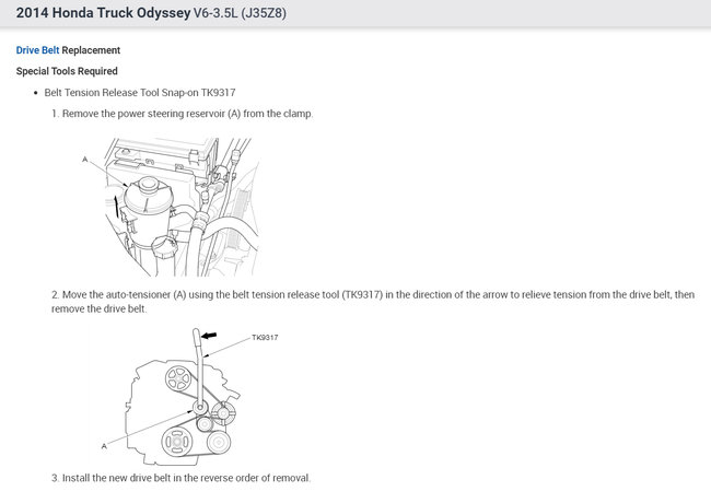

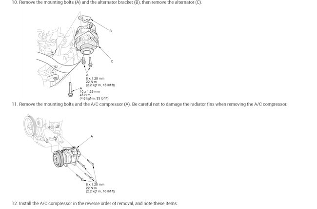

Please do not use the A/C because it sounds like the compressor is starting to lock up or the belt is bad, let's hope it is just the belt. To be sure you can upload a short video of the noise and problem. in the meantime, here is how to change the belt and the compressor out so you know what you are getting yourself into in the diagrams below.
These guides can help as well, please go over them:
https://www.2carpros.com/articles/replace-air-conditioner-compressor
and
