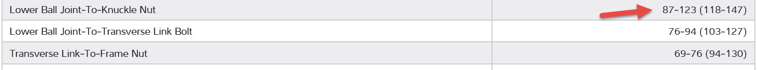

I am assuming this has stock tires or close to what came with them and not being raised with larger tires. it could be a bent wheel as well.when you say trailing arm bars I assume those are the ones in back was the pan hard bar bushings checked as well as lower links and are there any cracks on mounts of trailing arms upper and lower? how about stabilizer bar is that ok as well as links for that with no loose mounting on stabilizer anywhere. if front trailing armsor transverse links were removed were all bolts tighten with weight on them that may be the problem as it's out of whack. were wheel bearings removed and not tightened up correctly?arrow points ot transvers bars is in ft lbs first column.

normally if you hit a bump and things go crazy it's a bad ball jointjacktruck up undr ball joint and then get a bar and see if the joint moves up and dow by pressing on spindles if either side has any movement replace them.also make sure they are torqued down as well. then have the rack checked by a pro it may be that.going from 16-17" tires shouldn't do it. also the nut should be torqued down to 87-125 ft.lbs.
