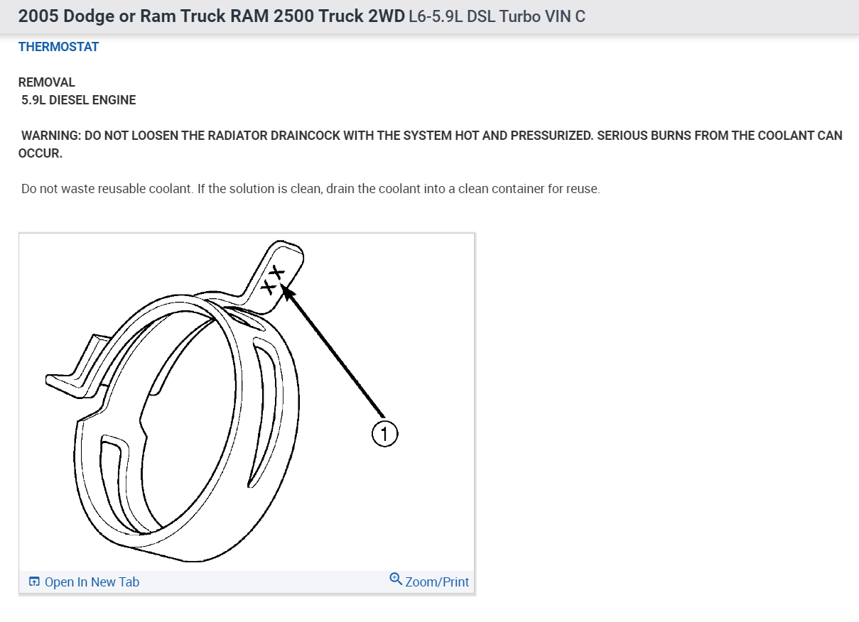

Was towing and out of nowhere engine got really hot. We dropped off the trailer but it’s still really hot. Got a light saying check gauges.

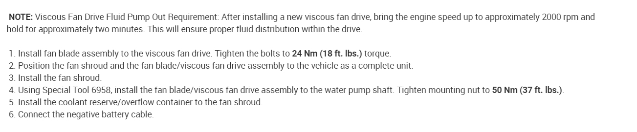

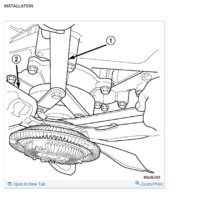

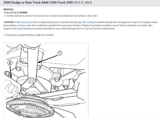

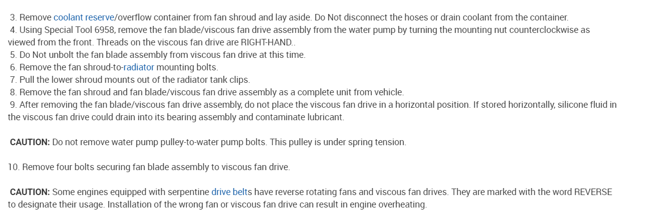

When the engine was hot did you hear the clutch fan kick in? (Airplane sound) if not, the clutch fan is not good and needs replacement here is how to change the parts out and this guide can help as well. Make sure you use a high-quality replacement, (name brand).
https://www.2carpros.com/articles/engine-overheating-or-running-hot
And this video as well:
https://youtu.be/N_-MLVlBHk8

Yeah, clutch fan is fine.

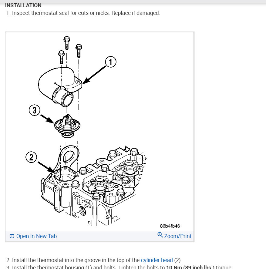

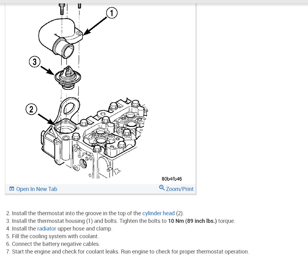

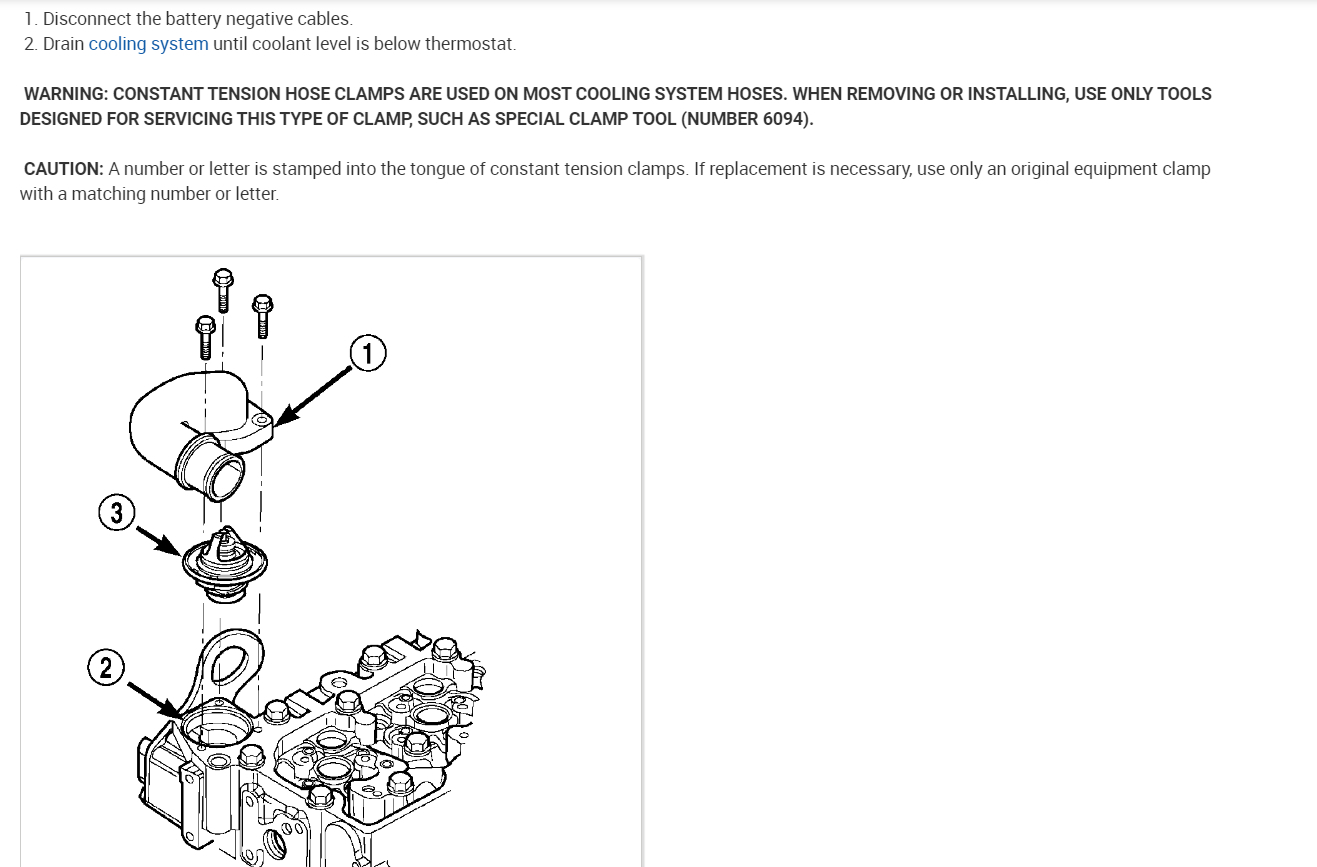

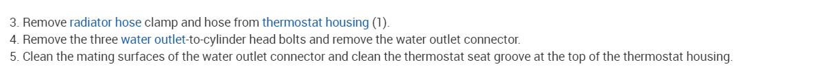

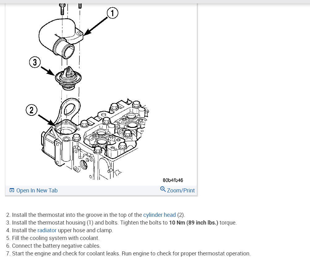

I would change out the thermostat and service the cooling system. Also, check for obstructions in front of the radiator such as a plastic bad, etc.
https://www.2carpros.com/articles/coolant-flush-and-refill-all-cars
+1
Tuesday, August 23rd, 2022 AT 11:54 AM
NATHAN100
Yeah, it was the thermostat we are going to get a new radiator and all good Cummins parts for good measure.
