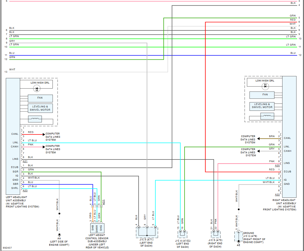

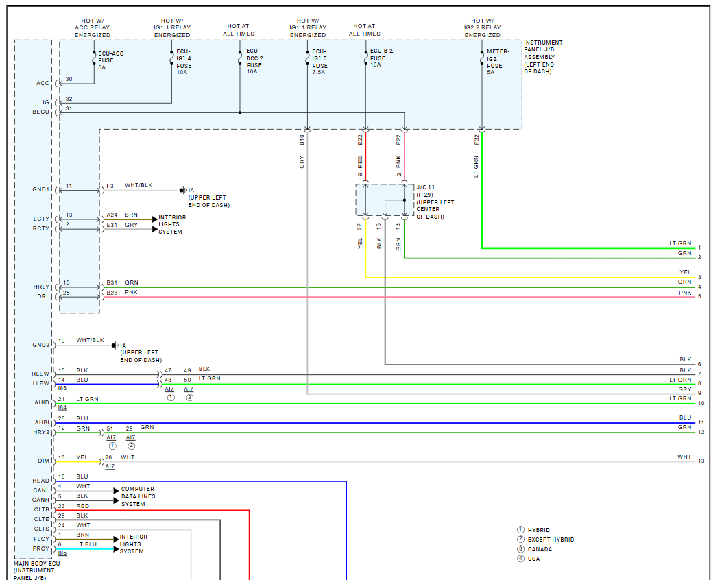

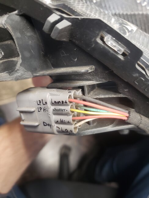

Hi, high beam in my right headlight stopped working, is a halogen lamp used for both low and high (HIR2), checked fuses 7.5A - are good and have power, I don't know if could be a relay for each headlight, headlight itself is good- my friend borrowed me his, anyone have a wire diagram? Please help! 2017 Toyota Auris (Corolla) hybrid.

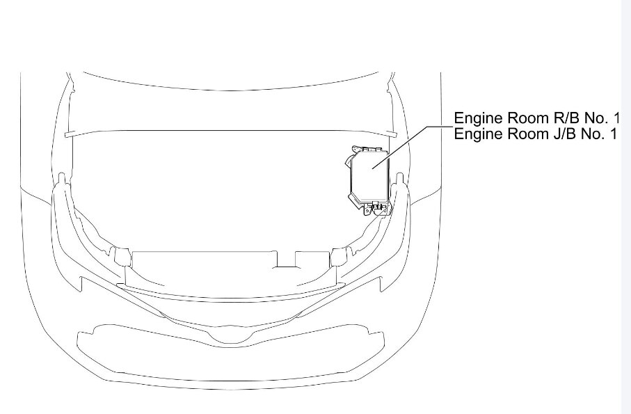

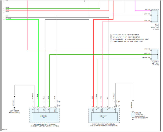

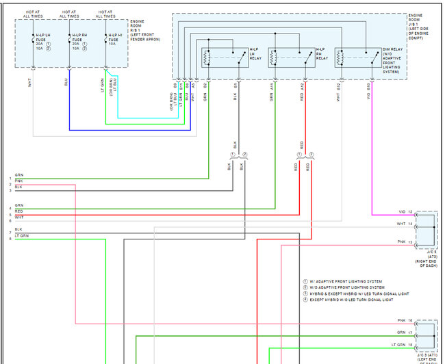

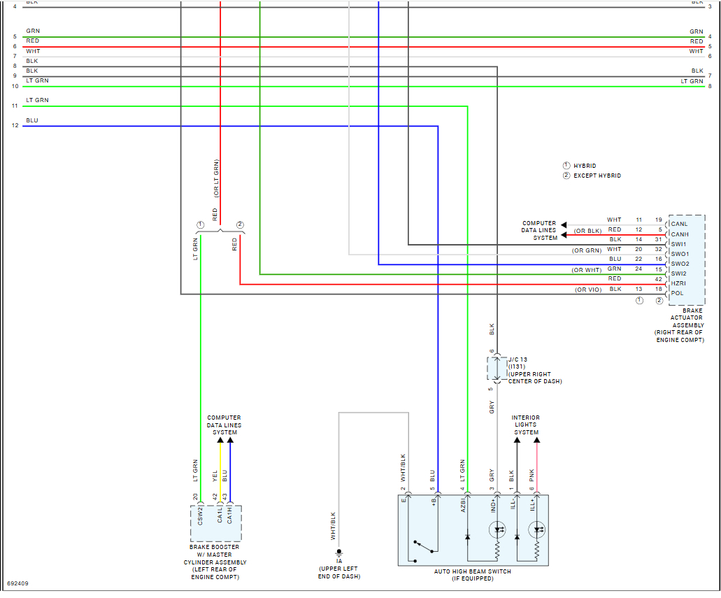

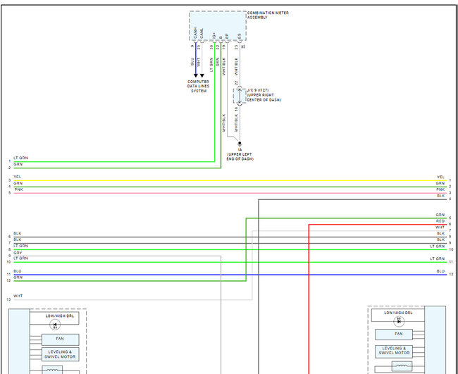

Yep, the right and left high beam uses two different relays and fuses. here are the wiring diagrams for the headlamps and high beams so you can see how the system works. I would make sure the H-LP RH fuse has power and swap the H-LP RH relay.
This guide can help:

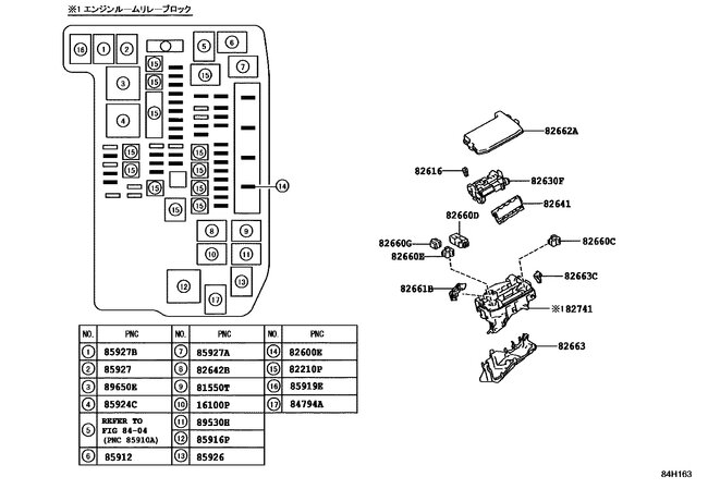

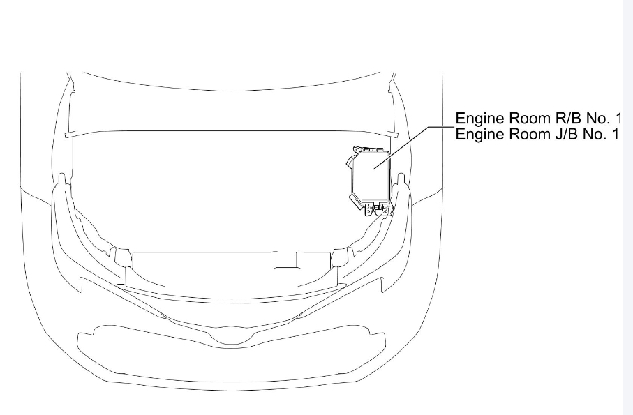

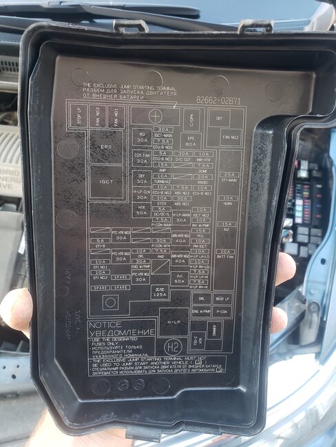

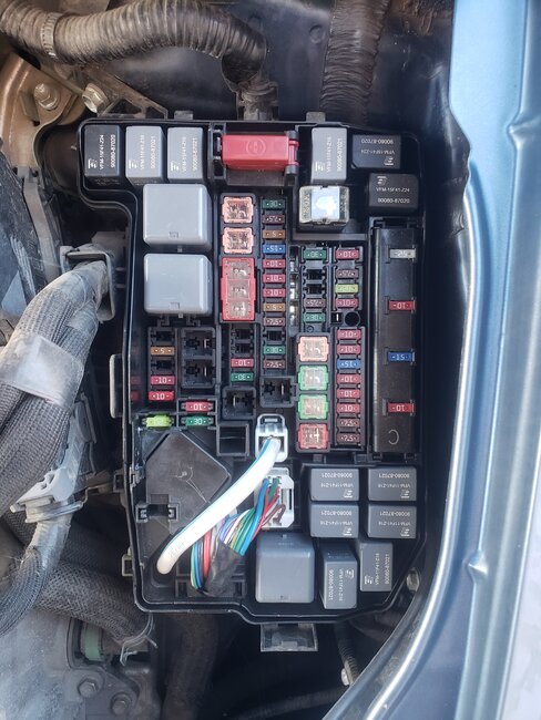

Here is the fuse and relay location as well, I would try swapping the relays to confirm the failure. Check out the images (below). Please upload pictures or videos in your response of any problems so we can see what to help you with.

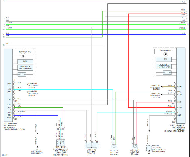

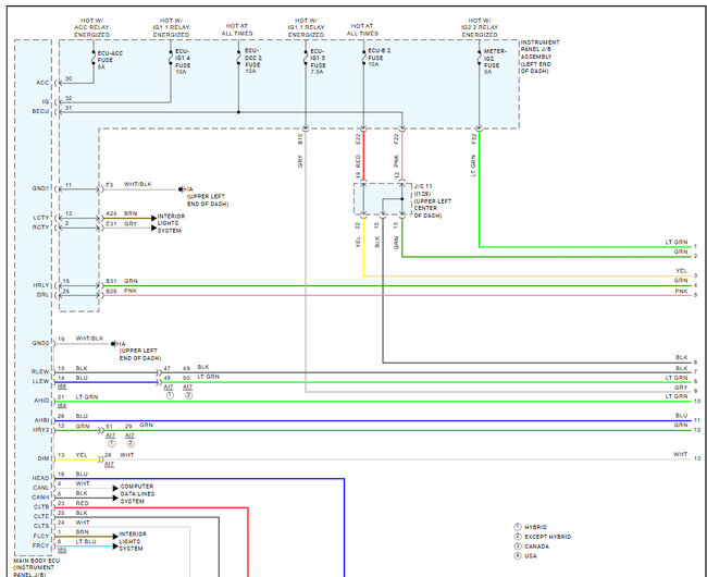

Thank you for quick answer, in my case (Toyota Auris) seems that fuse+relay box is different, I guess there is just one relay for both headlights Left and Right, and one for DRL . each headlight has its own shutter (they are good) which flips for high beam. I'll keep searching.

It is possible the colors are different because this is a euro car. I don't have info on this car in the states.
