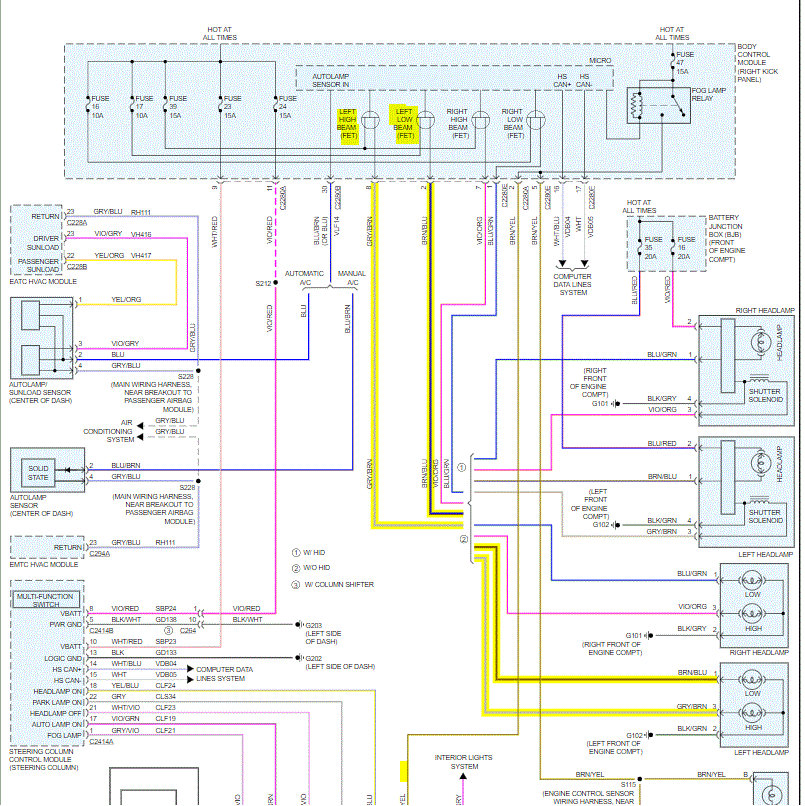

The only thing I see that can be causing it would be related to the auto light sensor in the body control module. When it turns on, do you know if it is high or low beam?
If you look at the attached pic, you'll see that the switch goes to the BCM and then it goes through the sensor (on automatic) or the sensor is bypassed and power sent to the lights. So, pay attention to which beam is turning on and try pulling the appropriate fuse to see if the light goes out. If it doesn't, then suspect a short to power in that wiring to the light. If it goes out, I have a feeling it is with the BCM. but to be sure lets do a CAN scan which is the future of automotive repair you can get a CAN scanner from Amazon for about $50.00 here is a video to show you how.

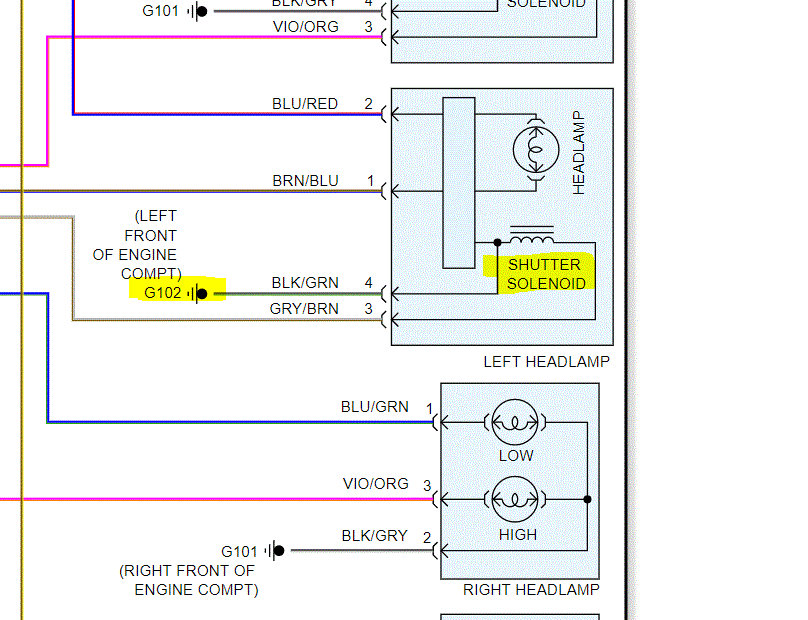

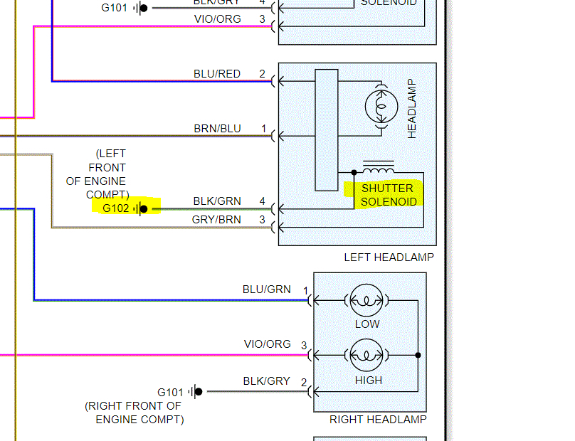

Okay, then we have a short to power after the low beam fuse. If I had to guess, it is going to deal with the shutter solenoid. I'm thinking through this and want you to confirm there is a ground to the solenoid. If that has failed, it may be back feeding power to the low beam. Please understand this is a theory at this point.
I attached a pic below and highlighted the wire and indicated the location. You are looking for a black wire with a green tracer
Let me know what you find.
