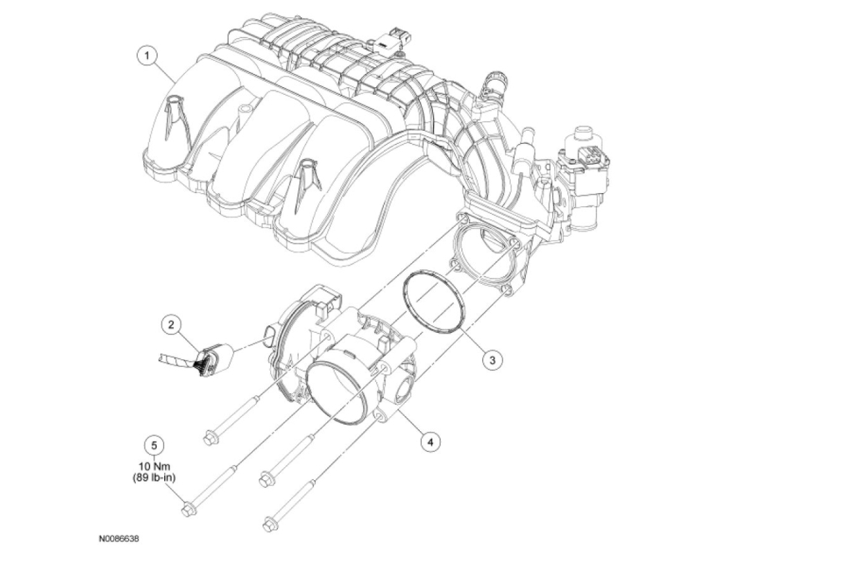

It still happened, car shuts of when rolling (foot of from gas pedal). Cleaned throttle body (replaced 12,000 mile ago with OEM). Car starts fine drives fine but when it rolling about 20-30 mph it will shut off (not every day).
Thursday, November 26th, 2020 AT 10:24 AM
  • 52,797 POSTS

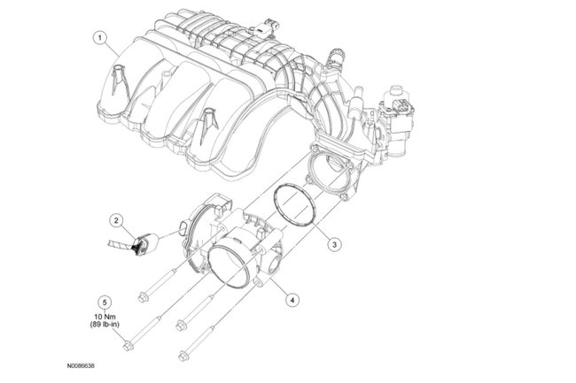

Good chance the throttle body itself may be the issue. I attached a guide for you ro review on this problem.
https://www.2carpros.com/articles/engine-stalls

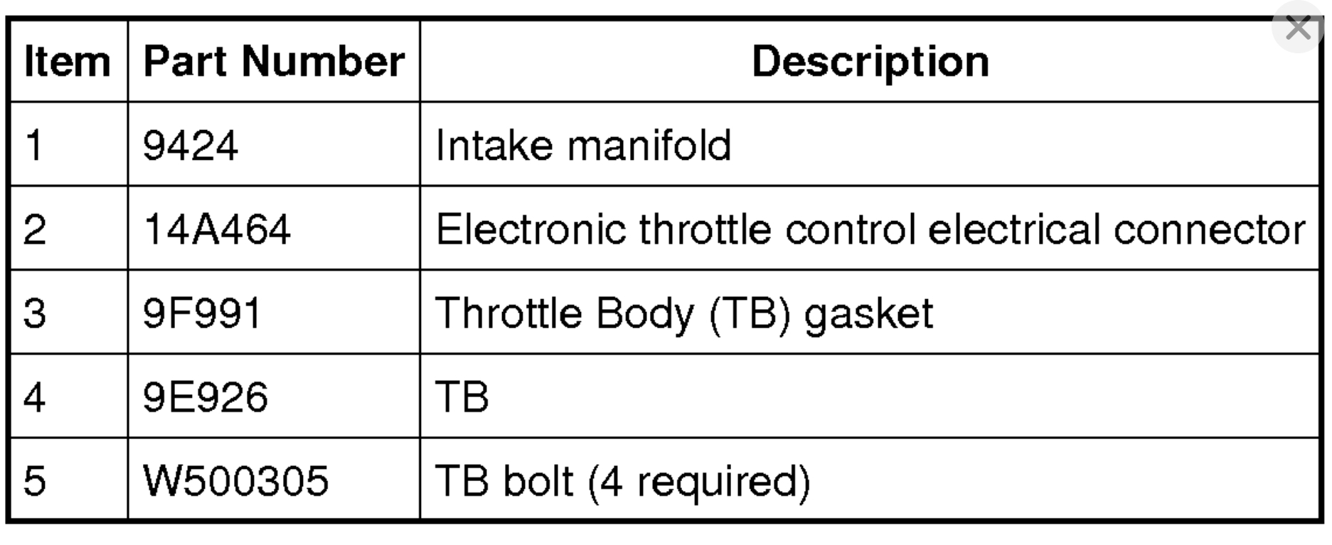

Below are the instructions and some pictures for you.
Removal and Installation
1. Remove the Air Cleaner (ACL) outlet pipe.
2. Disconnect the electronic throttle control electrical connector.
3. Remove the 4 bolts and the Throttle Body (TB).
Discard the TB gasket.
To install, tighten to 10 Nm (89 lb-in).
4. To install, reverse the removal procedure.
Install a new TB gasket.
