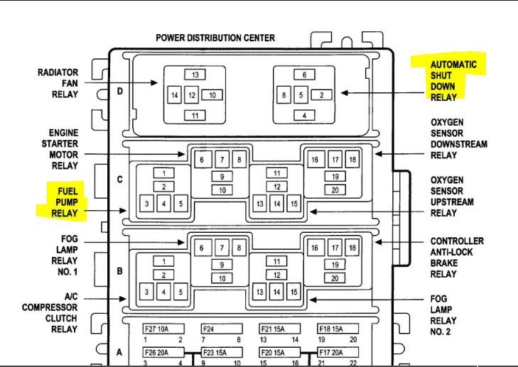

Hi:

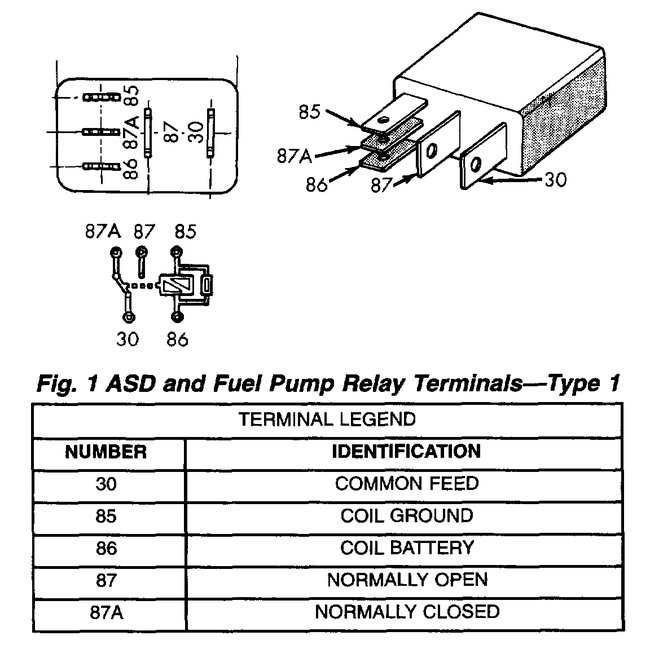

Since you sometimes get power, then I will assume it isn't a fuse. There is an ASD relay (auto shut down) which can shut off the pump and a fuel pump relay. Both are located under the hood in the power distribution box. I attached a pic below showing their locations (Pic1). I would start by checking these circuits and relays. Here are the directions for testing.

ASD and Fuel Pump Relays Test
Vehicle Powertrain Management Fuel Delivery and Air Induction Fuel Pump Fuel Pump Relay Testing and Inspection Component Tests and General Diagnostics ASD and Fuel Pump Relays Test
ASD AND FUEL PUMP RELAYS TEST
Fig.1 ASD And Fuel Pump Relay Terminals - Type 1

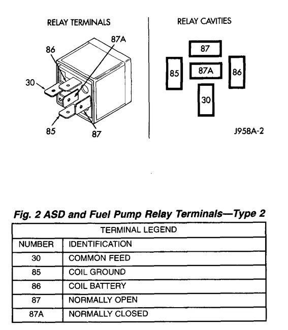

Pic 2
Fig.2 ASD And Fuel Pump Relay Terminals - Type 2

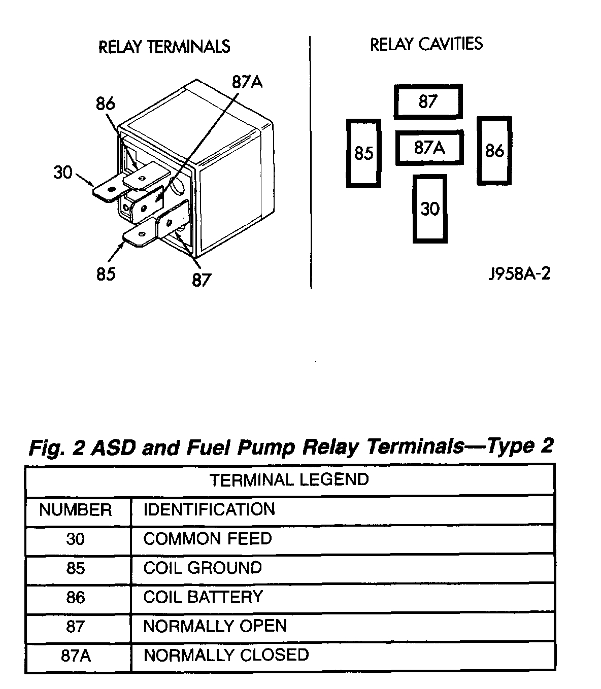

Pic 3
The following description of operation and tests apply only to the Automatic Shutdown (ASD) and fuel pump relays. The terminals on the bottom of each relay are numbered. Two different types of relays may be used, (Fig. 1) or (Fig. 2).
- Terminal number 30 is connected to battery voltage. For both the ASD and fuel pump relays, terminal 30 is connected to battery voltage at all times.
- The PCM grounds the coil side of the relay through terminal number 85.
- Terminal number 86 supplies voltage to the coil side of the relay.
- When the PCM de-energizes the ASD and fuel pump relays, terminal number 87A connects to terminal 30. This is the OFF position. In the OFF position, voltage is not supplied to the rest of the circuit. Terminal 87A is the center terminal on the relay.
- When the PCM energizes the ASD and fuel pump relays, terminal 87 connects to terminal 30. This is the ON position. Terminal 87 supplies voltage to the rest of the circuit.
The following procedure applies to the ASD and fuel pump relays.
1. Remove relay from connector before testing.
2. With the relay removed from the vehicle, use an ohmmeter to check the resistance between terminals 85 and 86. The resistance should be 75 ohms ± 5 ohms.
3. Connect the ohmmeter between terminals 30 and 87A. The ohmmeter should show continuity between terminals 30 and 87A.
4. Connect the ohmmeter between terminals 87 and 30. The ohmmeter should not show continuity at this time.
5. Connect one end of a jumper wire (16 gauge or smaller) to relay terminal 85. Connect the other end of the jumper wire to the ground side of a 12 volt power source.
6. Connect one end of another jumper wire (16 gauge or smaller) to the power side of the 12 volt power source. Do not attach the other end of the jumper wire to the relay at this time.
WARNING: DO NOT ALLOW OHMMETER TO CONTACT TERMINALS 85 OR 86 DURING THIS TEST. DAMAGE TO OHMMETER MAY RESULT.
7. Attach the other end of the jumper wire to relay terminal 86. This activates the relay. The ohmmeter should now show continuity between relay terminals 87 and 30. The ohmmeter should not show continuity between relay terminals 87A and 30.
8. Disconnect jumper wires.
9. Replace the relay if it did not pass the continuity and resistance tests. If the relay passed the tests, it operates properly. Check the remainder of the ASD and fuel pump relay circuits. Refer to Wiring Diagrams.

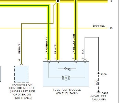

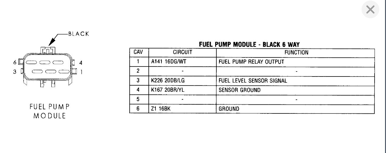

Hard wired the fuel pump to a toggle switch to the battery and fires up and runs now. Not exactly sure what each wire is for what. I tried looking for a diagram of the fuel pump wires but couldn’t find anything. Felt like it’s getting to much fuel now since I ran both grounds together and then both positives of the fuel pump wires. Did it that way just to see if it would run the pump and it did but not sure if I have it wired right.
Tuesday, November 19th, 2019 AT 6:49 PM
  • 110,192 POSTS
At the pump, the wires go to these things:
Dark green/white To fuel pump relay
Dark blue/light green To PCM (low fuel light)
Brown/yellow To camshaft position sensor, O2 sensors, VSS, battery temp
sensor, cruise control
Black To Ground.
I cut a portion of the wiring schematic for you to see. If there is something specific you need, let me know. There are several pages associated with this.
_____________________________________________________
I'm glad to hear it's running. Please keep in mind, the vehicle has an automatic shut down system that turns power off to the pump in the event of a roll over or accident. That will not happen if you have it powered direct.
Let me know if the wiring helps.

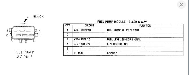

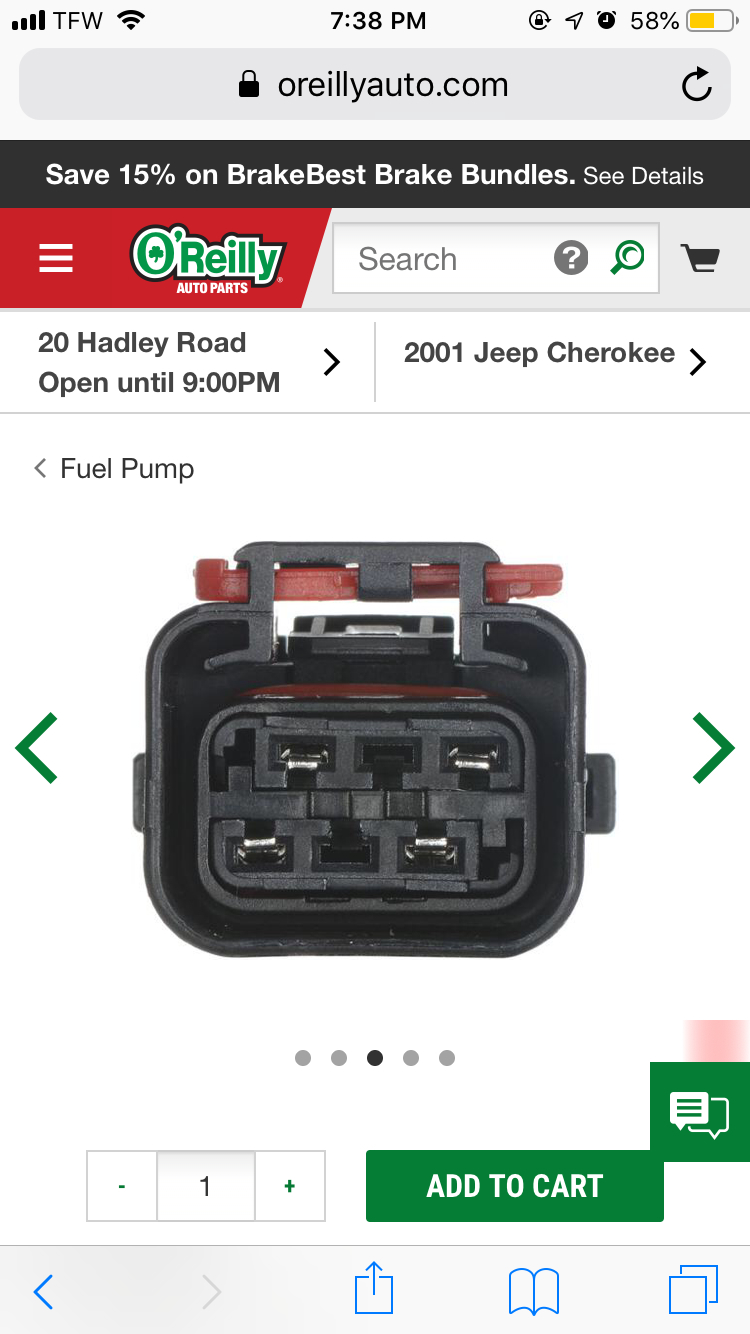

Was wondering what color is which on fuel pump connector?
Wednesday, November 20th, 2019 AT 5:26 AM
MOORE2127
  • 11 POSTS
I know there is like a 5v and 12v wire for ones priming and the other ones constant. So does that mean I would have to run 2 toggle switches? Or how would I run the switches so its not sending too much fuel?
Wednesday, November 20th, 2019 AT 7:09 AM
  • 110,192 POSTS

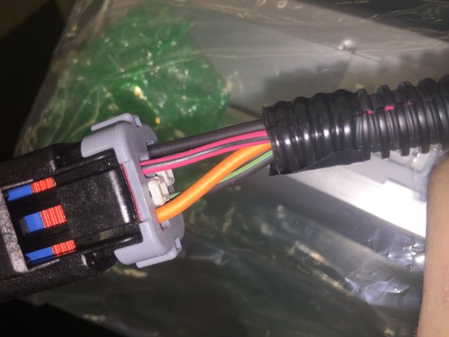

I attached a picture of the connector for the pump. It is a 6 pin connector but only 4 are used. I noticed that you have a new connector with different colors. The pic shows what each pin does. Since the wires are different colors, confirm that the pins are in the correct locations. Pins 1, 3, 4, and 6 are the only ones used.
+1

Thank you. So would putting the (orange and red/black wire together for positive) and the (black and green/black together for ground) and run it to a toggle switch and battery? Am I correct?
Wednesday, November 20th, 2019 AT 3:34 PM
  • 110,192 POSTS
I would need to determine which color wires on the new plug go to which pin. Look at the pic I attached above, determine the new colors going to the pins, and that should identify which new color should get power and which shouldn't.

Pretty sure red/black and orange are the ones on top like where the red tab is.
Wednesday, November 20th, 2019 AT 4:42 PM
  • 110,192 POSTS
Compare it to the old one and then to the schematic I attached above. I don't want to take a chance and give wrong information causing a short.

So if the orange and black wire are the 16g wires and the other two would be the 20g which would be used for the fuel sensor guage? And then the 16g would be for the fuel pump? So if that’s right then would I just need the 2 16g wires ran to the battery?
Saturday, November 23rd, 2019 AT 6:20 PM
  • 110,192 POSTS
Honestly, without being there I can't answer that. Have you tried to compare it to the old plug?

Don’t have the old plug to compare too. And also well if the two 20G wires refer to being the fuel gauge sensor and the sensor ground then I wouldn’t need those 20G wires ran in with the 16G correct? Cause I ran the fuel pump relay output wire and the fuel level sensor signal wire together as positive and then the sensor ground wire and ground wire together as the ground and ran it into my battery and switch and it kicks the fuel pump on and fired up but the inline fuse keeps blowing so thinking it’s getting to much power now. Or could I run the fuel level sensor and the sensor ground to the connector and then run the fuel pump relay wire and ground to the battery?
Monday, November 25th, 2019 AT 5:59 PM
  • 110,192 POSTS
Please understand, my schematics don't offer the wiring gauge. However, the dark green / white wire runs to the relay, so it should be powered. As far as the level sensor, it is most likely the lower power supply you mentioned. The best thing I can suggest is to follow the original layout I gave indicating what each wire does then look at the pin designation and wire those wires to the new plug based on what the pin out shows.
As far as just running power direct, I don't recommend it, but the dark blue /. Light green wire goes to the PCM, so I wouldn't recommend powering that wire. Based on what I am seeing on the schematic, if you supply power to the dark green / white (relay) wire and then ground the black wire, the pump should run.
