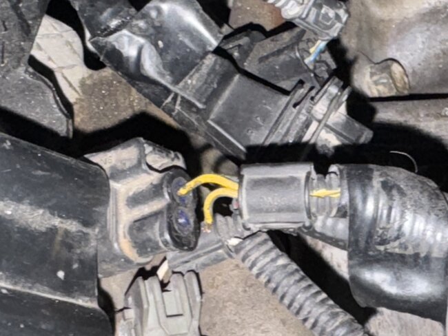

Well I found the culprit that one little wire broken off from a connector that plugs into the coil pack. I fixed the wire plug the connector back in and she fired right up.

Yep, that will do it, glad you could get it fixed, thanks for letting us know. Kind of surprised there were no codes. Please use 2CarPros anytime we are here to help.
