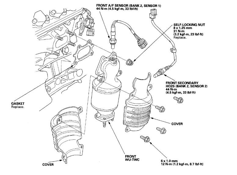

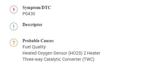

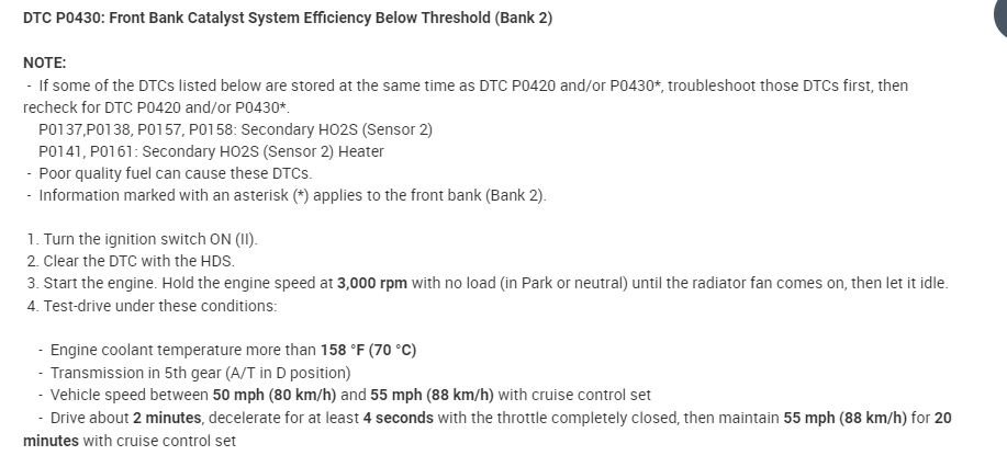

Catalyst system efficiency below threshold bank 2.
How would you start to pin-point this?
Sunday, March 1st, 2020 AT 10:32 PM
MECHANIC
52,796 POSTS
Good morning,

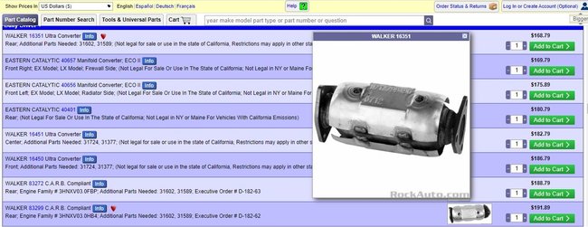

This code indicates a bad catalytic converter. The insides are worn out and it cannot process the gases anymore.
Here are some guides that will help with this.
https://www.2carpros.com/articles/catalytic-converter-replacement
This is a very common issue.
