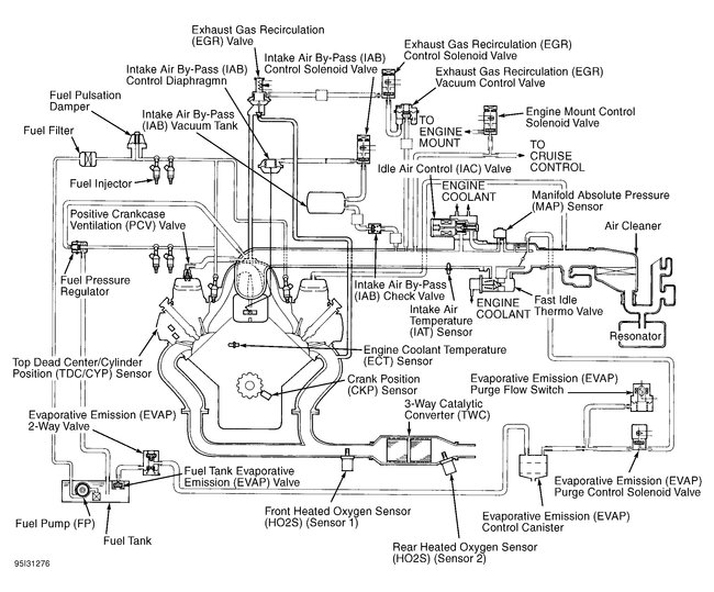

Here is the vacuum diagram.

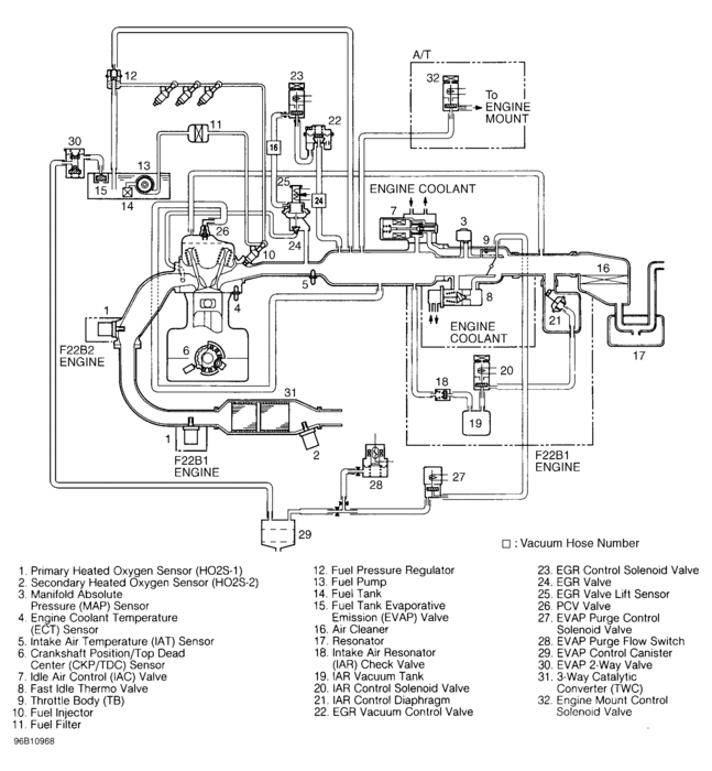

Need vacuum diagram for 1996 honda accord with 4 cyc

Here is the engine vacuum line diagrams Check out the diagrams (Below). Please let us know if you need anything else to get the problem fixed.
