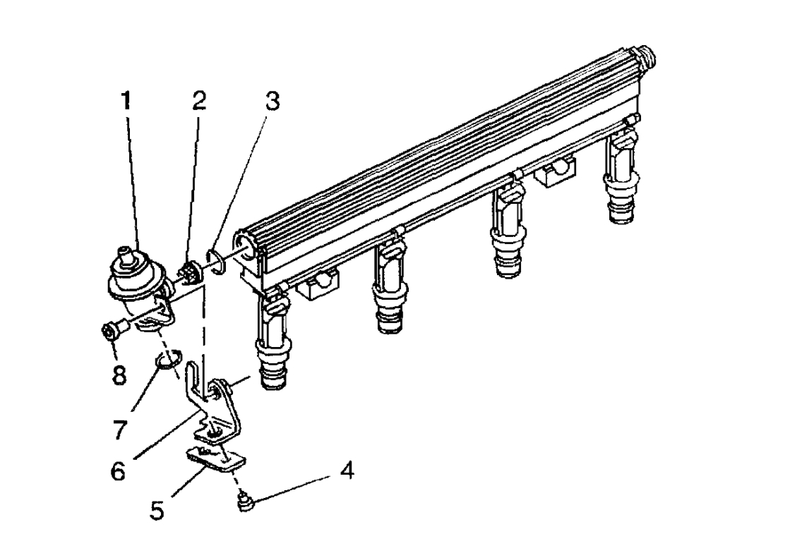

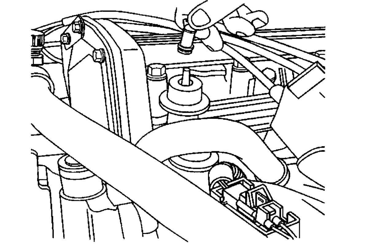

I have found that there is fuel coming out the pressure regulator not a lot but it’s coming out.
Monday, November 2nd, 2020 AT 10:04 PM
  • 52,797 POSTS
There should be 0 coming out.
Replace the pressure regulator.
1. Remove the fuel rail assembly.
2. Remove the attaching screw (8) from the pressure regulator.
3. Remove the pressure regulator assembly (1) from the fuel rail.
Twist the assembly back and forth while pulling.

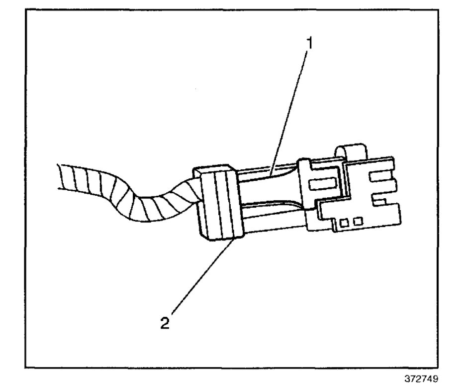

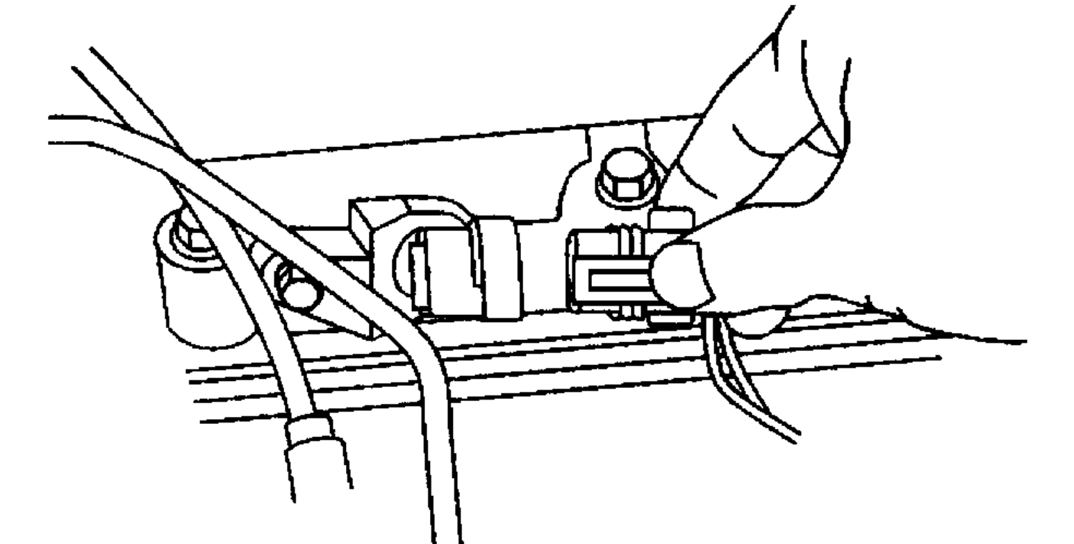

5. Pull up the lock release (2) of the fuel injector connector.
ImageOpen In New TabZoom/Print
6. Depress the lock tab (1) and lift the connector from the injector.

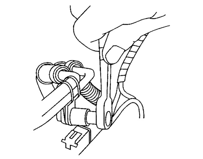

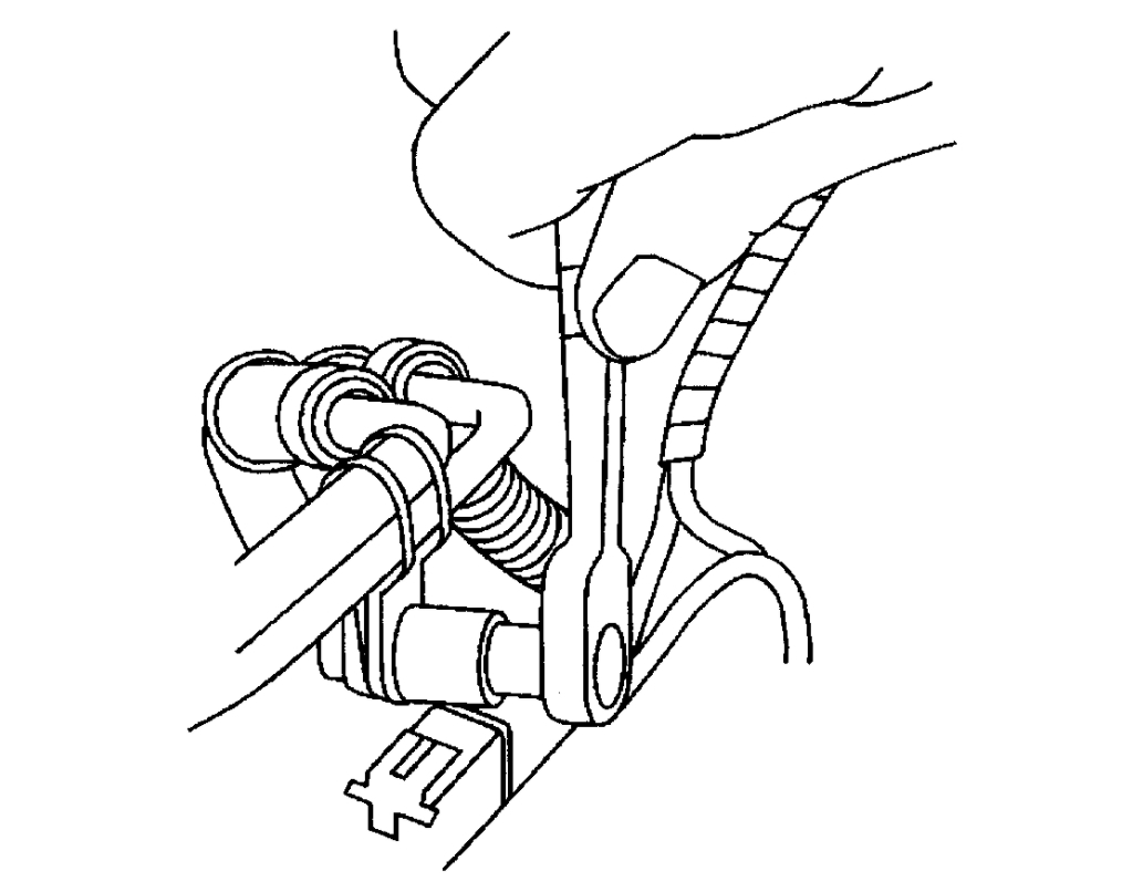

7. Disconnect the fuel feed pipe from the fuel rail. Use a backup wrench on the fuel rail inlet fitting to prevent the fitting from turning.

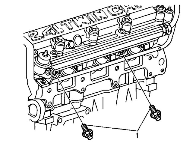

9. Remove the fuel rail attaching bolts (1).

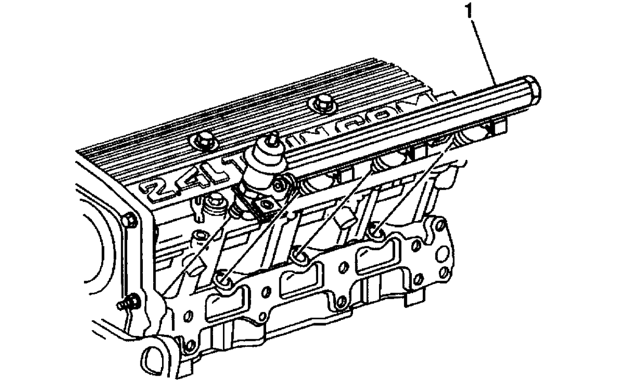

10. Lift the fuel rail assembly (1) from the cylinder head.

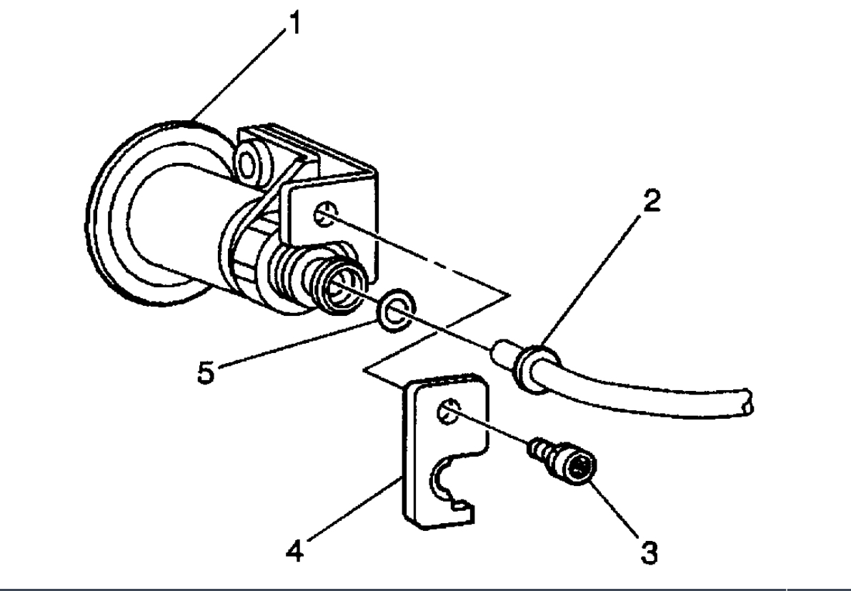

12. Remove the fuel return pipe bracket screw (3) and the bracket (4).
13. Remove the fuel return pipe (2) from the fuel pressure regulator (1).
14. Remove the fuel return pipe. Discard the O-rings.
15. Remove the fuel pressure regulator.
16. Remove the fuel injectors.
