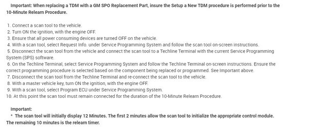

Replaced ignition in it now it won't start. What else can go wrong?
Wednesday, February 26th, 2020 AT 3:36 AM
MECHANIC
52,796 POSTS
Good morning,

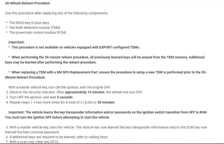

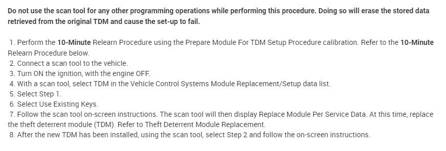

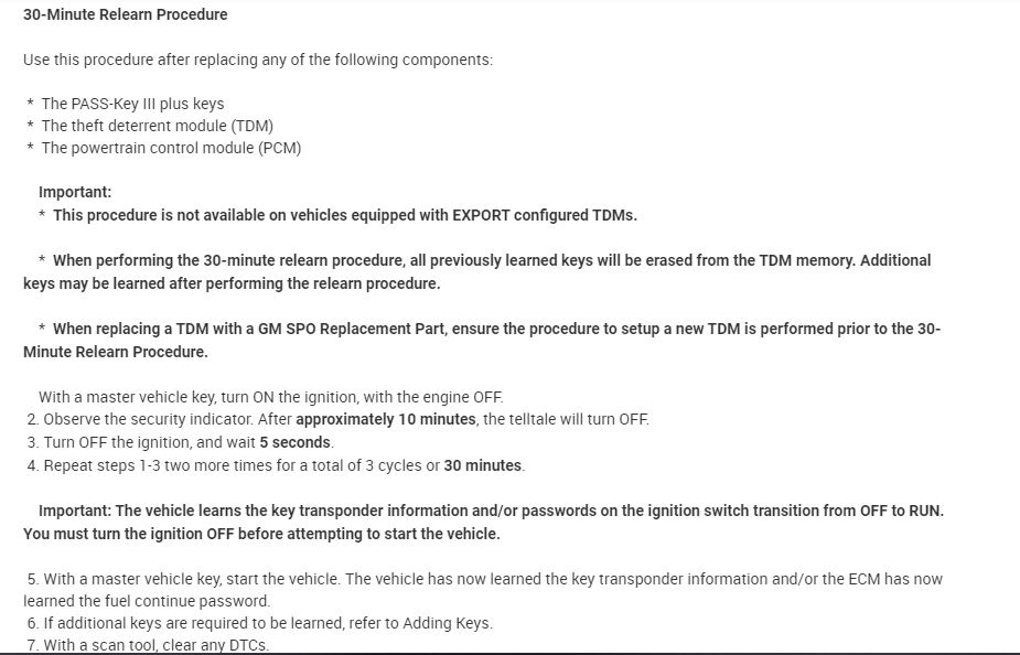

Did you replace the ignition switch or the key? The key will require a relearn procedure.
There is a 10-minute procedure and a 30-minute procedure post below.
