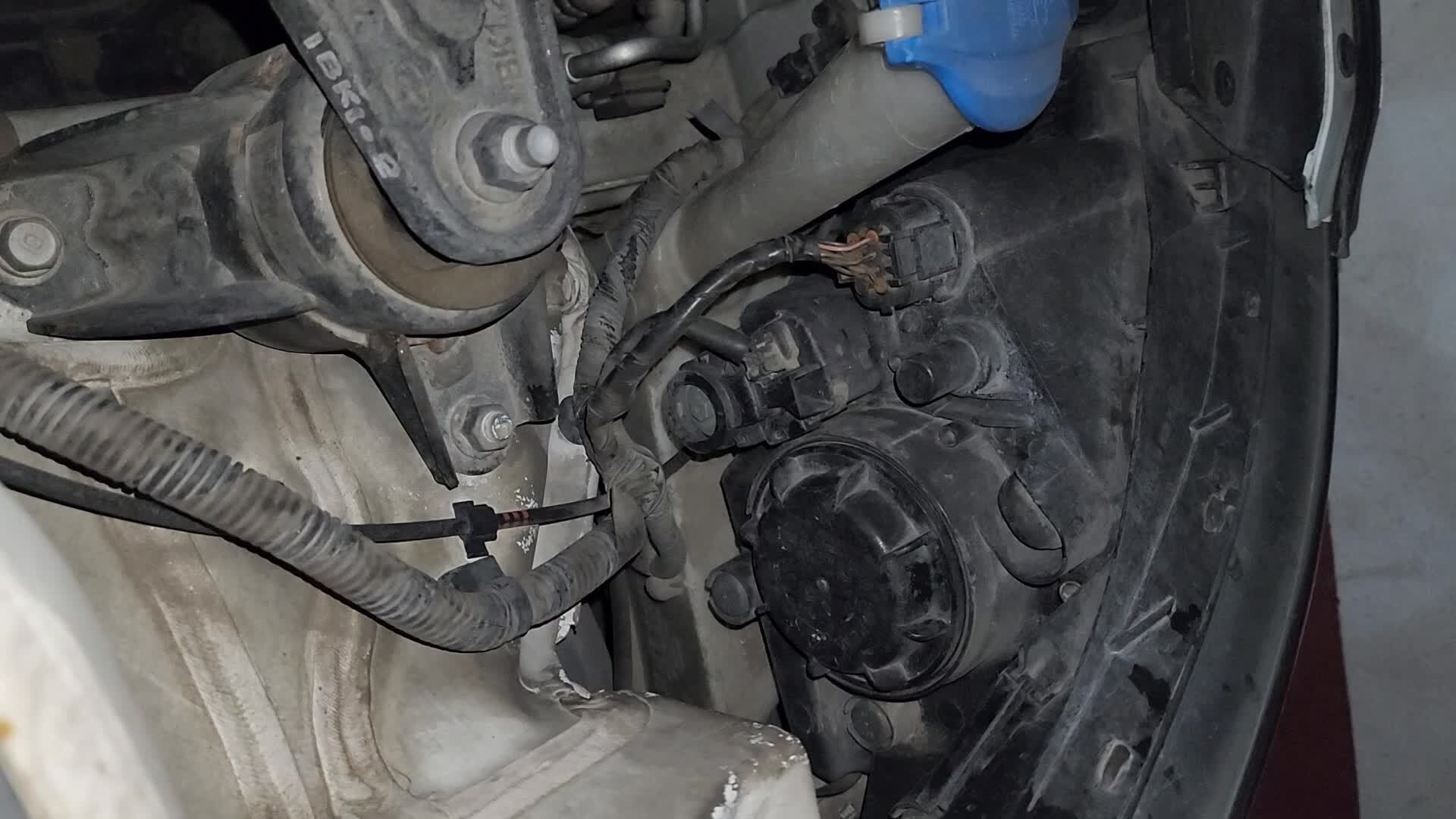

Hello, I wanted to what is this rattling noise it's i20 petrol 1.2 manual sorry it's not 10110kms and miles. It has done 100100kms.

Where does the sound seem to be the loudest? When listening to the audio, it sounds more like a top-end noise. For example, it sounds like it could be lifter noise.
Does the sound change with engine speed?

Have you checked the oil pressure at idle? At first, I thought it was a lifter noise. If it lessens when you rev the engine, oil pressure is also increasing which may explain why it gets quieter.

Possibly yes to the noise, but if the oil pressure is too low, it will cause damage. Have you had a chance to check the oil pressure?
