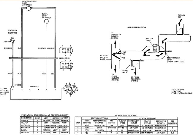

Under dash diagram for heating hose

There are no heater hoses under the dash, did you mean the vacuum control lines for the HVAC system perhaps. Attached is a diagram for those as well as how the system operates.
