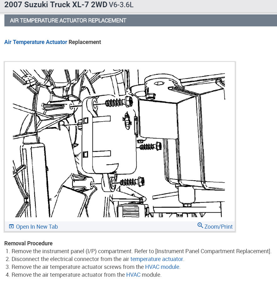

When driving the air blow cold in the packing heater is fine. My mechanic replace the heater core then water pump but still no heater.

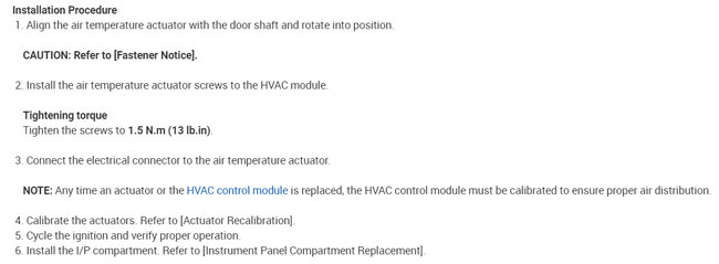

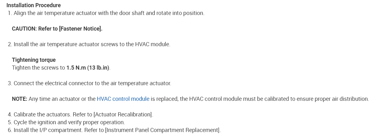

It sounds like you have a temperature blend door actuator that is not working here is a guide to show you the steps and the location for your car is below.
This guide can help as well.
Check out the diagrams (Below). Please let us know what you find. We are interested to see what it is.
