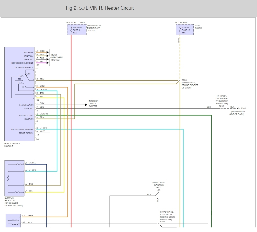

I have changed the relay. I have checked the blower motor and that works when power to it. I have checked for power when I switch between off and high and I get some power like five volts at the motor itself. So I changed another relay I found behind the glovebox. Also on the heater control head the lights do not come on when I push the AC or recirculation buttons. Could this unit be the problem or should I change the resistor? One more thing there are three different controls in the car and none of them work. And yes I did look for bad fuses.

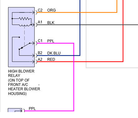

At the relay with blower on high, check red wire to see what voltage is then check purple wire to see what that voltage is that should be 12 volts. On both red is input and purple goes to motor. If not the relay is not working. Was it another relay or a new one. The orange wire comes from the switch. Blue goes to resistor on lower speeds.

Ok I checked the power. 12 on red 5 on orange 0 with purple and blue with the switch on high. What the heck could it be beside that darn control head? Hey thanks again for your help here. Getting it to a mechanic is not an option where I am at, so your all I have on this.

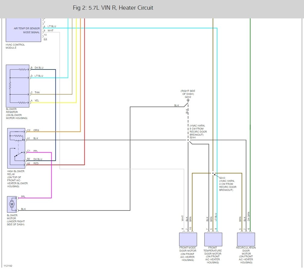

I found the complete wiring diagram for you so you can test for the voltage drop.
Please run some tests and get back to us so we can continue helping you.
Best, Ken
Saturday, November 26th, 2016 AT 8:20 PM

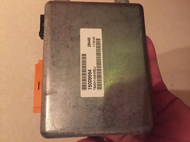

Ok so this part here I do not know what it is but it has been making a clicking noise all the time and when it does the lights go on for the heater control and four wheel drive. It appears the wires go from this being the power for the heater when key is on? Maybe this is the underlying problem? Please let me know also what it is.

That is a transfer case module and has been updated to a 12577421 part number. But I would try unplugging the transfer case actuators before replacing that because that can cause the module to act up.

Thanks for the quick response. So this could be my problem is that what your saying? At one point awhile back I was messing with wires for the stereo under the dash and grounded it out so I might have blown this box. Possible? Anyway I re plugged the connections and still have the same clicking.

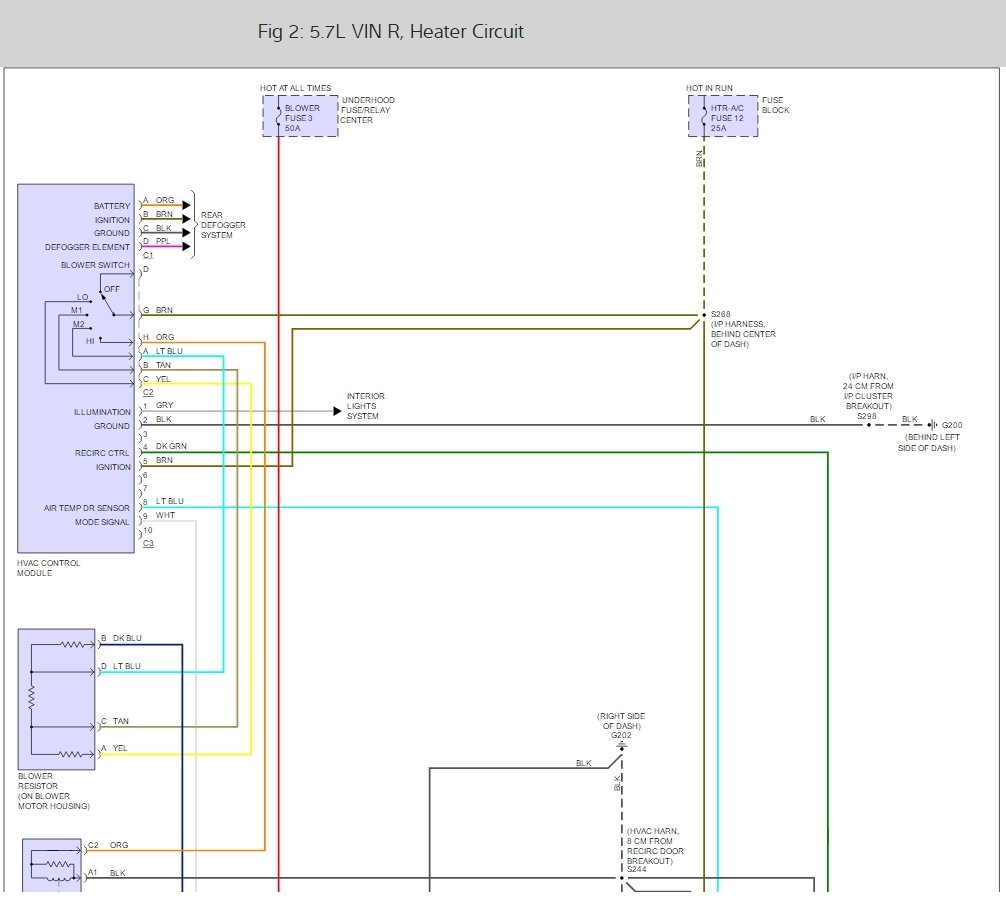

The voltage going into the control head is only 5vols when ignition is on. Any thoughts?
Monday, November 28th, 2016 AT 1:44 PM
HMAC300
  • 48,601 POSTS
Check fuse 12 with ignition on to see how many volts are going through it if still 5 volts check your ignition switch orange wire with key on if low voltage your switch is bad.
Monday, November 28th, 2016 AT 3:55 PM

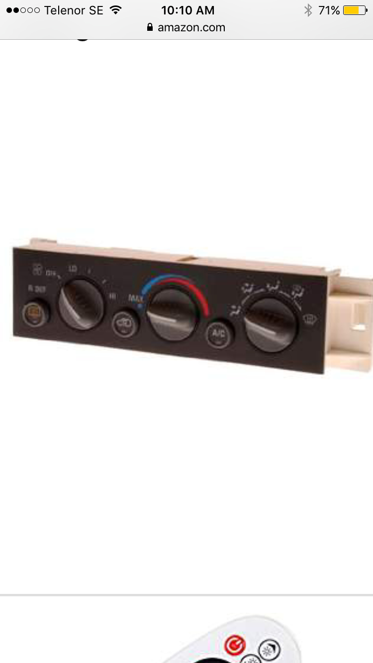

Ok I'm back to thinking it's the control head though all the information I'm getting checks out good but still no working blower. I also cannot hear the door opening and closing when going from floor to defrost plus rear defrost light does not come on

Yep it sounds like its the control head, let us know what happens.
