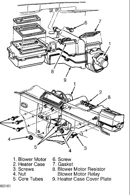

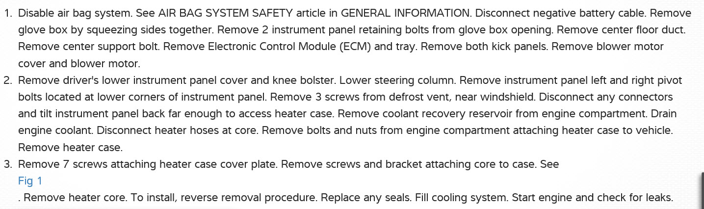

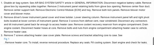

Can I pull the heater core thru my glove box, and can I cut the bracket that holds dash together
Thursday, April 21st, 2016 AT 4:12 AM
HMAC300
MECHANIC
48,601 POSTS
The dash has to come out then hvac unit has to come apart for a heater core removal. You also have to evac and recharge a/c system. See pics
