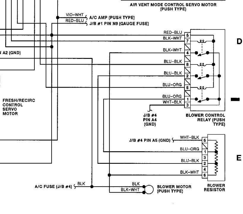

Got the new one back in but cannot figure out the wiring.

Not sure what you want, but this goes from relays to blower. See picture.
Image (Click to make bigger)
