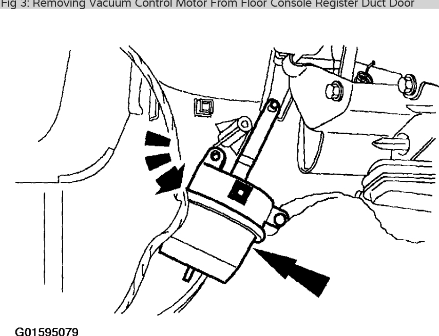

Have heat and cold air but doors will not move from defroster two air vents on dash.

Check for a vacuum leak at control head or one of the vacuum motors. See picture can be a line has fallen off or a leak.
