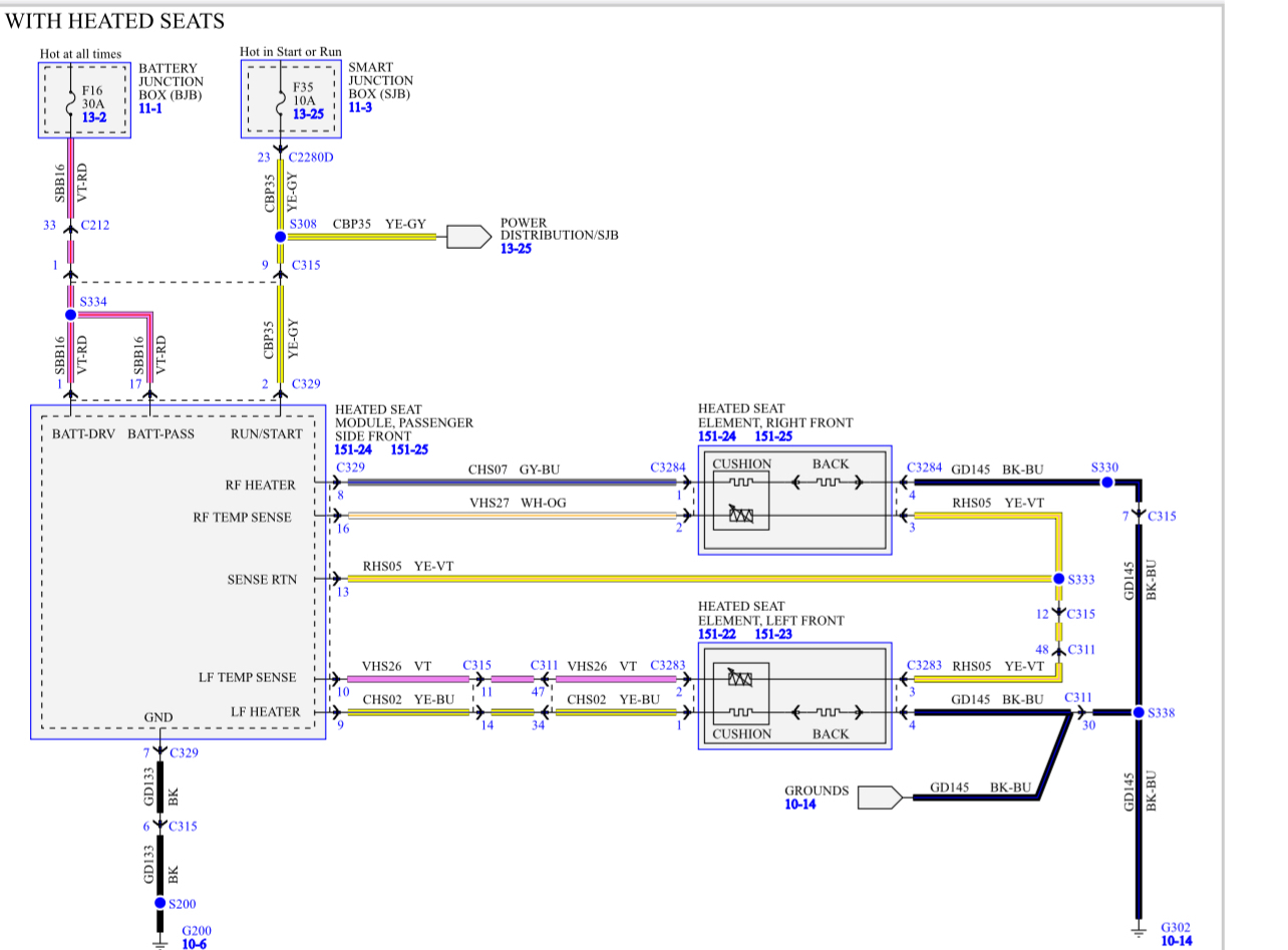

Heated seats not working.

Hi Rob here. Was there any work or add electronics prior to this happening and have you checked under your seat to make sure no wires are damaged? There are many issues with the switches failing on these vehicles as well as the heaters embedded in the seats as well.

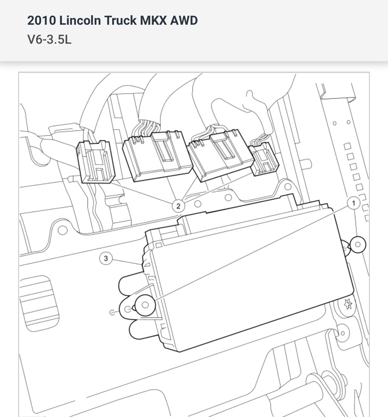

If all the wiring is okay and fuses check out, then the most common issue is the module under the driver seat these fail and causes the problem you were having. This will control cooling and heated seats. I would check this next. If you want to try to test the module yourself, I do have the test procedure but will need a meter and be able to use it properly to diagnose this.

Yes I will test the module. Please send me the procedure. I am very familiar with the use of a multimeter. I pulled the connector from the module under the passenger seat to check a common issue of the ground burnt. It was okay. Fuse #16 in engine compartment and fuse #35 in vehicle both tested okay. Neither were open.

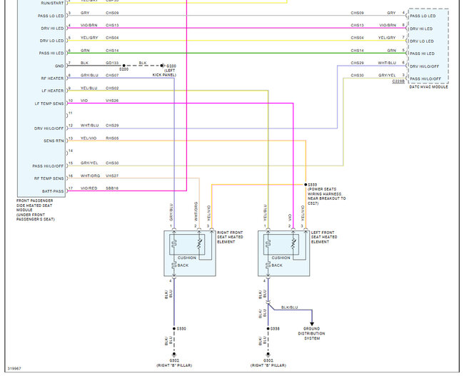

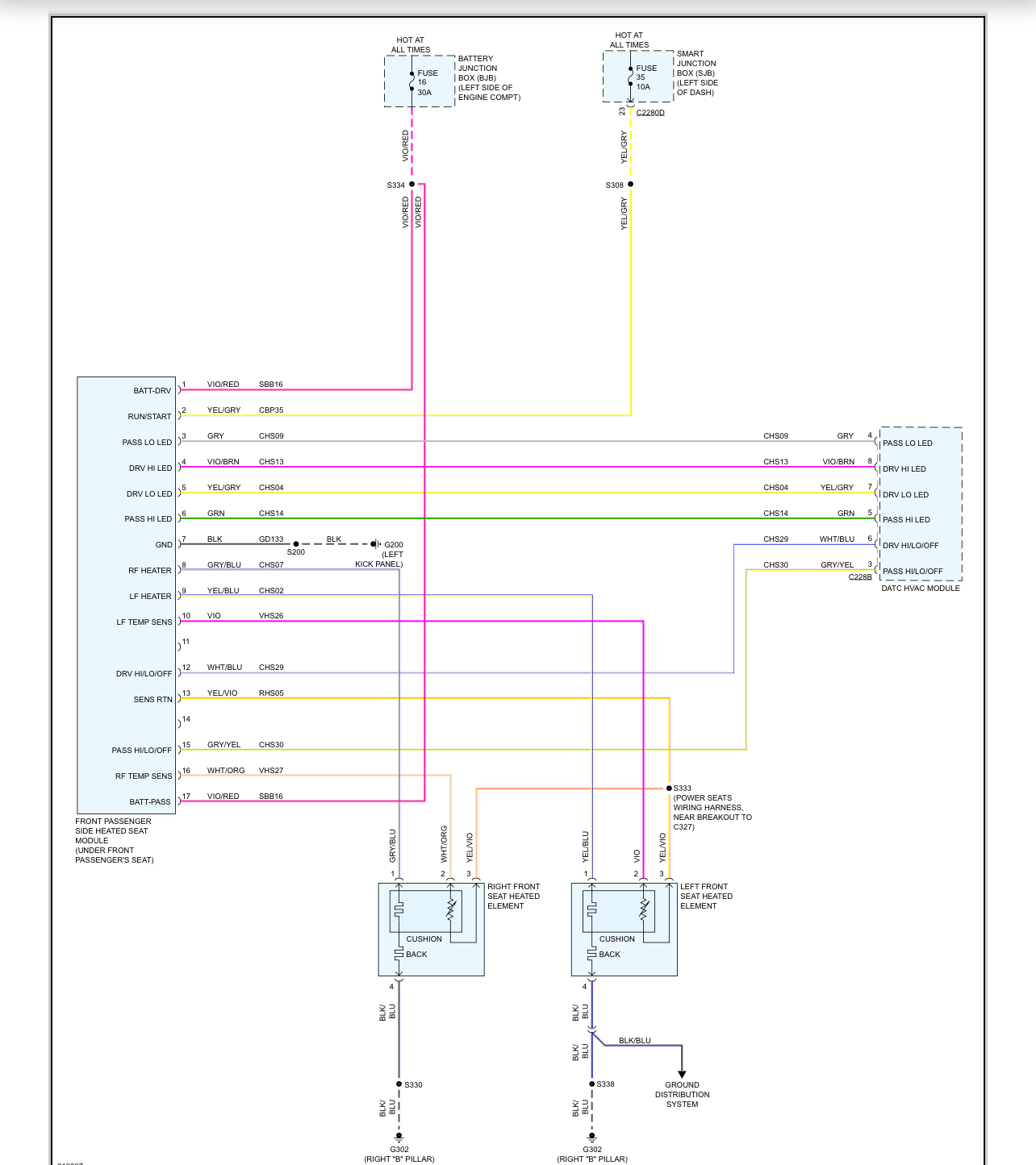

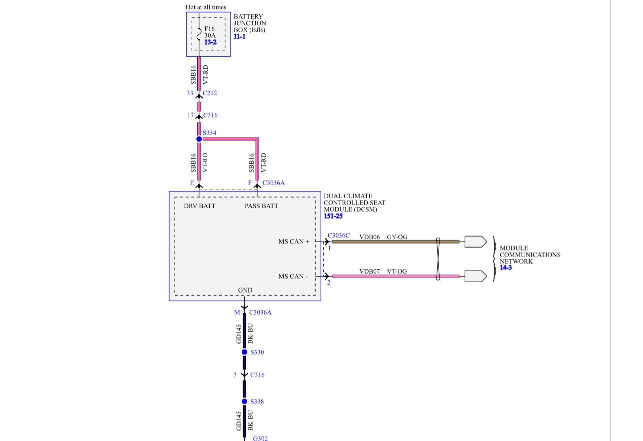

Check the wiring connector for the passenger side module you replaced. Usually, the black ground wire on the connector heats up and melts int the connector.
There is a fuse that runs the system #12 - 30 amp in the fuse panel under the hood. Here is a guide to help you test it and the fuse location in the diagrams below:

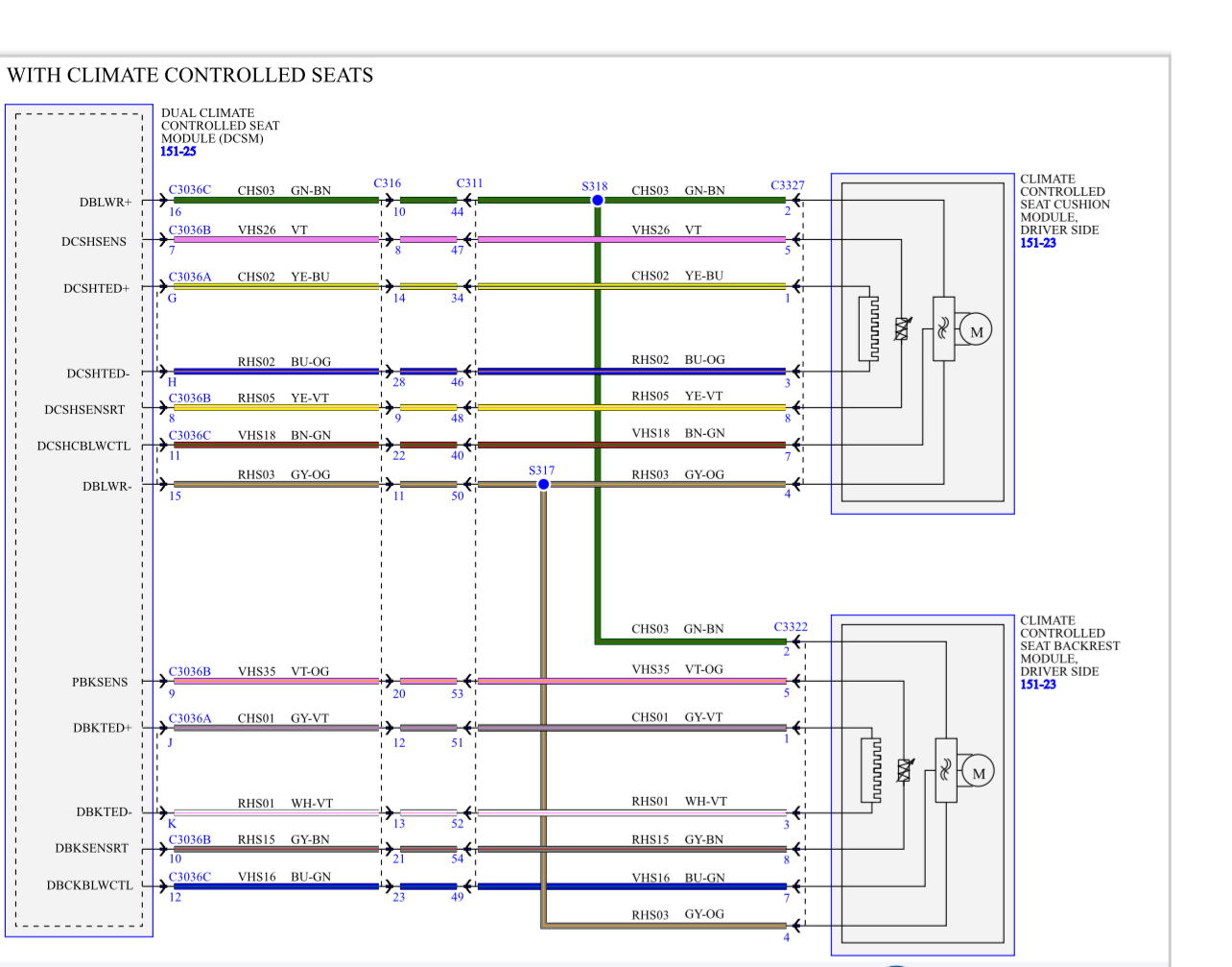

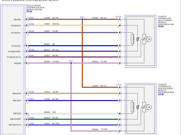

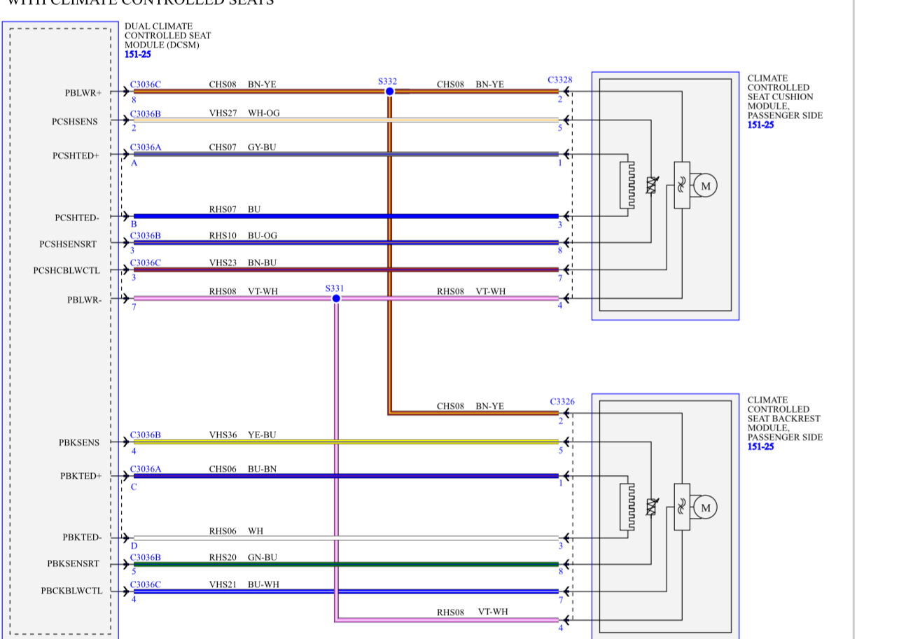

These will help as well.

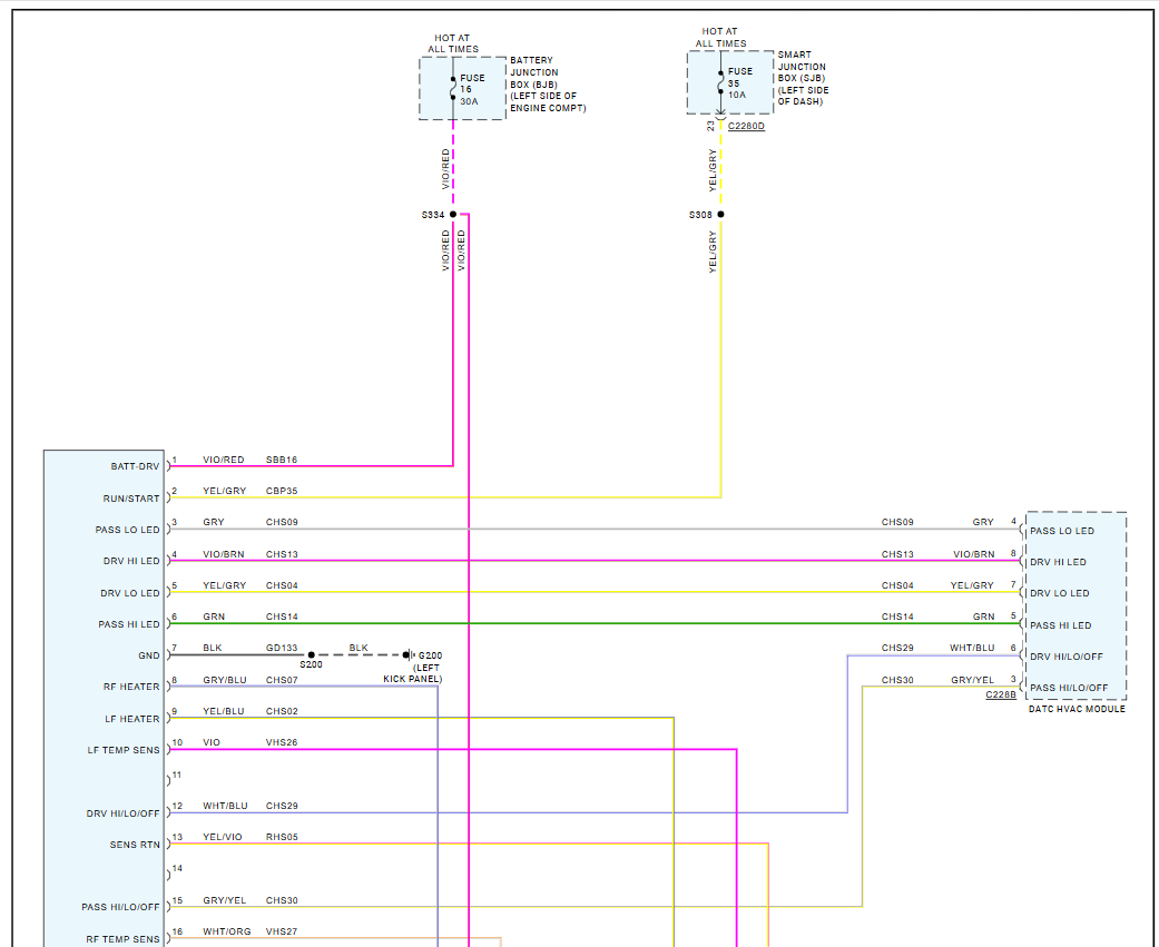

The only fuse under the hood that has any relationship to the heated seats according to the wiring diagrams appears to be #16. Please correct me if I'm wrong. One issue that I noted with the use of a test light is that I don't seem to have any power at fuse #35 in the inside fuse box which shows hot at all times on the schematic.
Feb 7, 2025 at 8:10 AM
CARDOCTOR74
  • 62 POSTS
Yes, if that fuse is not blown that smart junction box has failed most likely.

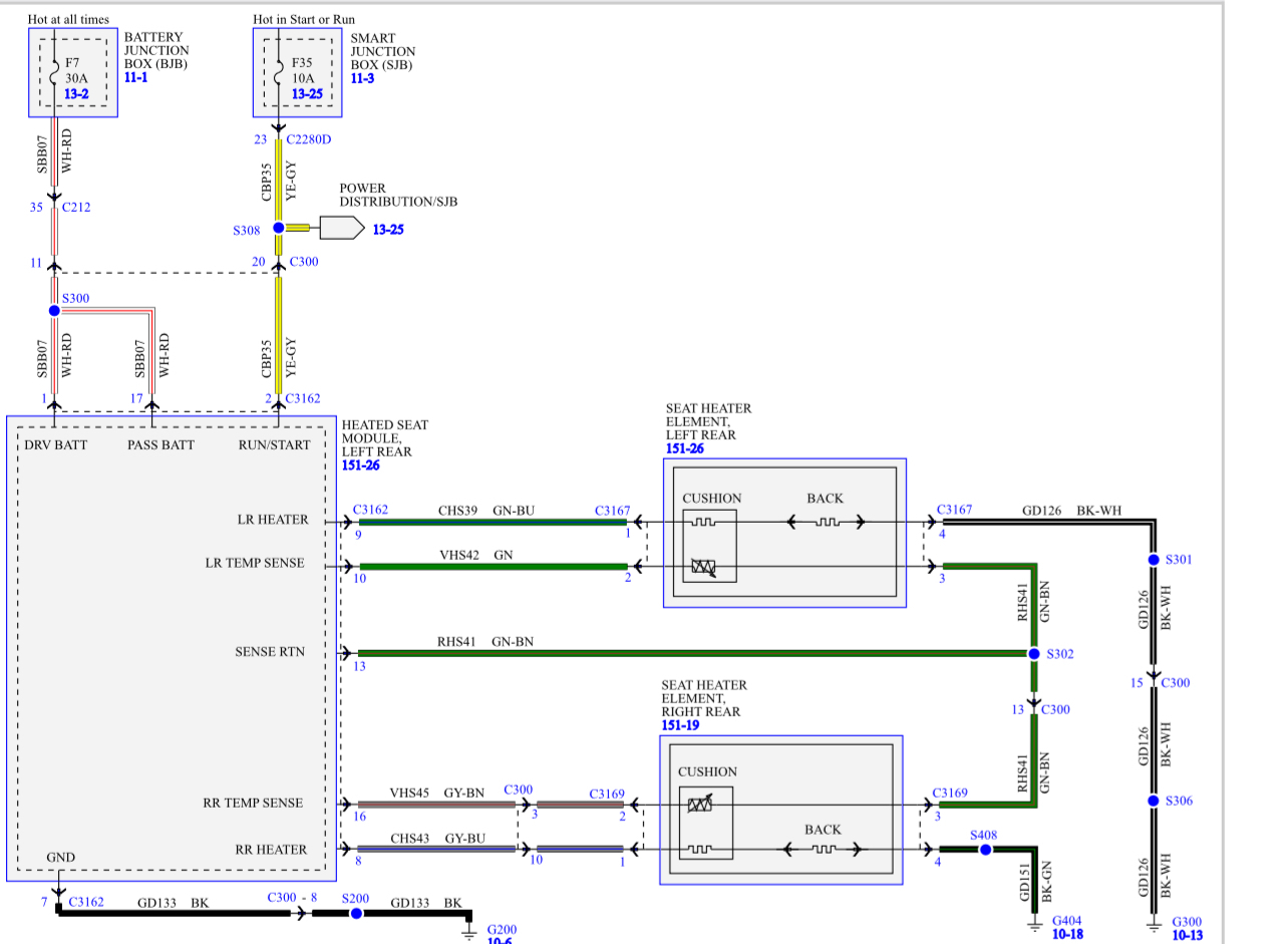

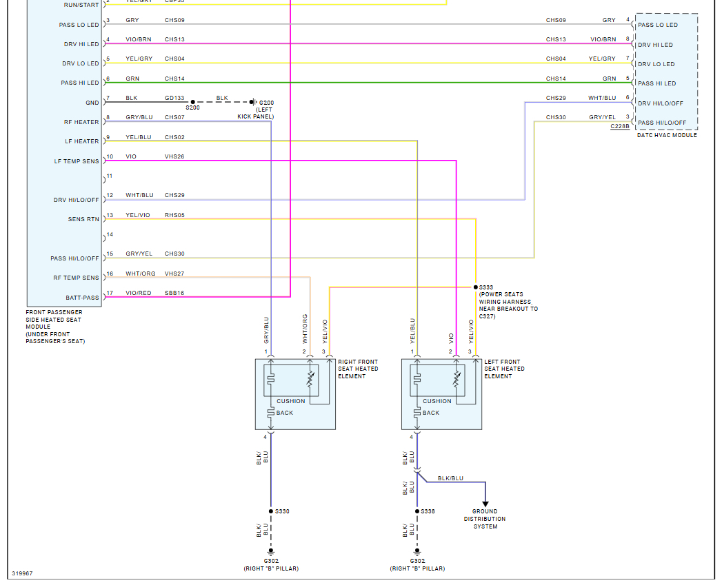

I have seen both the module go out and the heating element go to open circuit. Can I ask if the light goes on when the system is on? If so, I would use a test light to see if the yel/blu wire has power.
This guide can help:
Here is the wiring diagrams for the seat heaters a little larger so you can read it. Also, I would double check fuse #16 in the under hood fuse panel and fuse # 35 in the smart junctions bow with the system on. This can help eliminate the SJB. Check out the images (below). Please let us know what happens.

The light goes on only for a short time when you turn the switch on and then shuts off so it would seem that the yel/blu wire only gets power during that time. I don't have the car available right now so I can't do the other checks. Would the SJB be an issue if the other fuses in it are, okay?
Feb 10, 2025 at 2:46 PM
  • 54,503 POSTS
The yel/blu must have power all the time so we should test this, if so, the problem can still be the module or the heating element.
