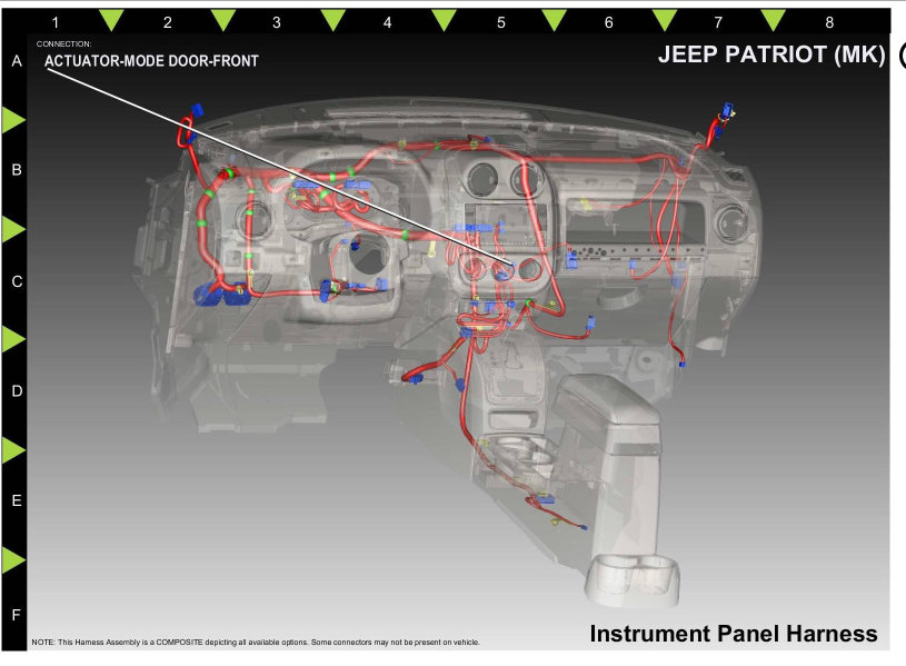

I can get semi-warm air through the vents. We have changed the thermostat's and are bleeding out the radiator system. When we switch it to defrost the air instantly is cold no matter what temperature you have a car set on.
Aug 22, 2017 at 4:36 PM
  • 54,494 POSTS

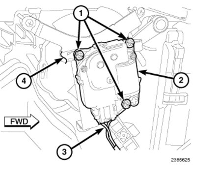

It sounds like you have a blend door actuator that has gone out.
Here is a guide to help you see the problem and some diagrams (below) so you can get the problem fixed on your car:
