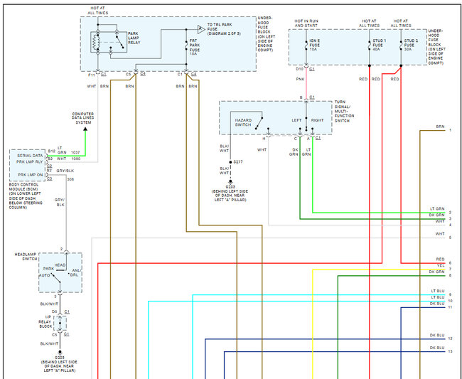

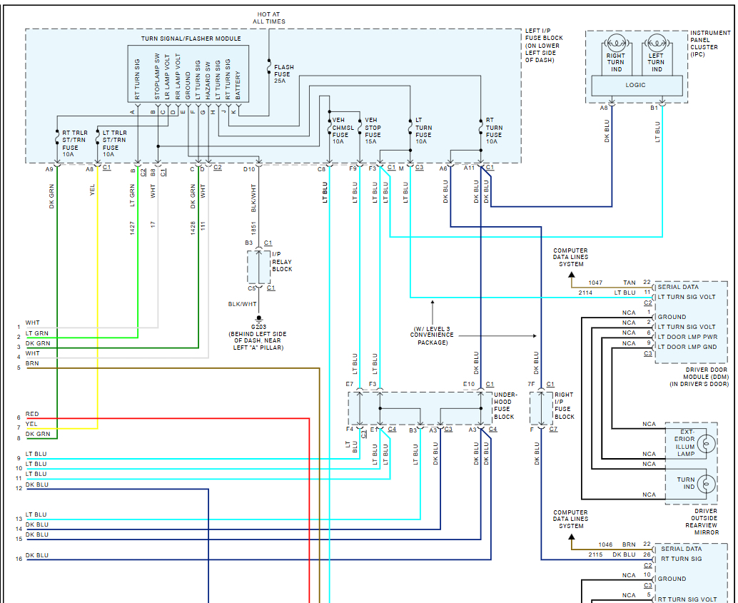

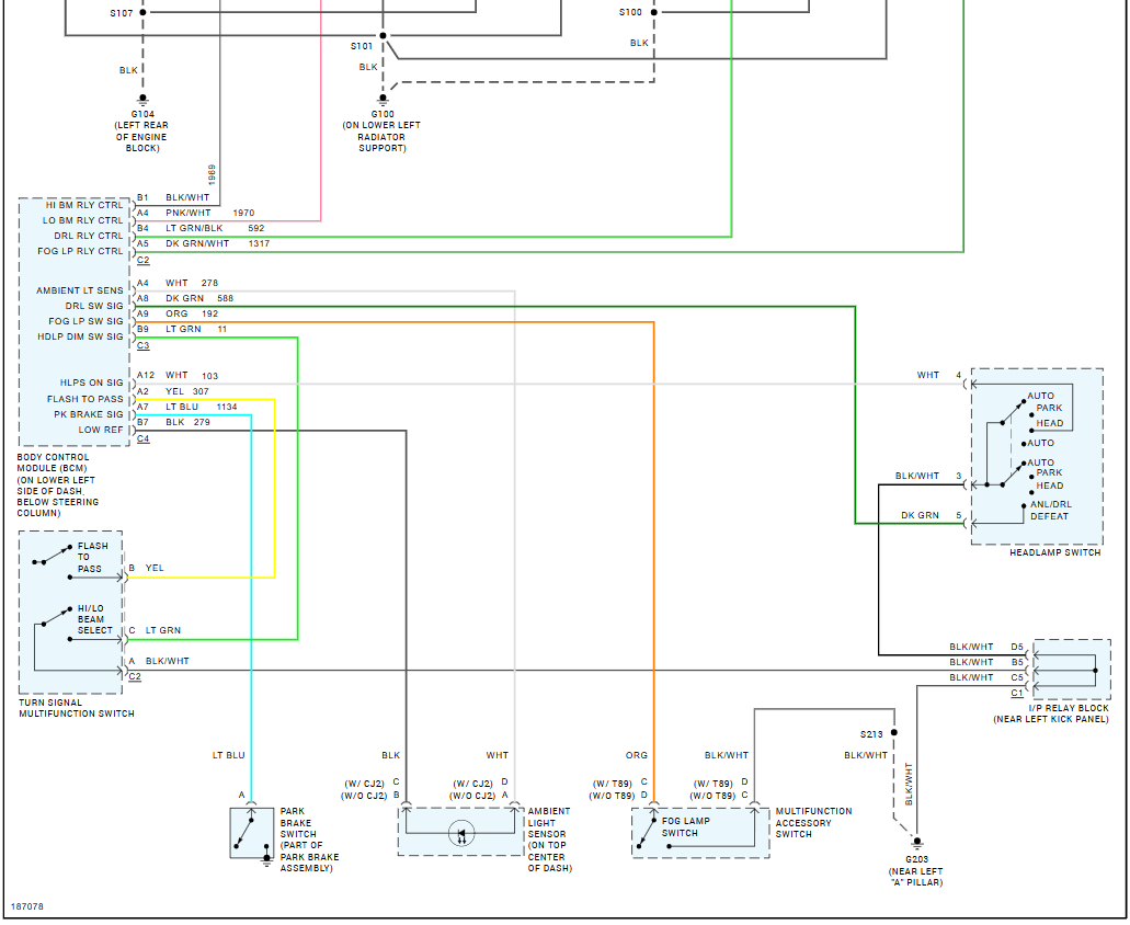

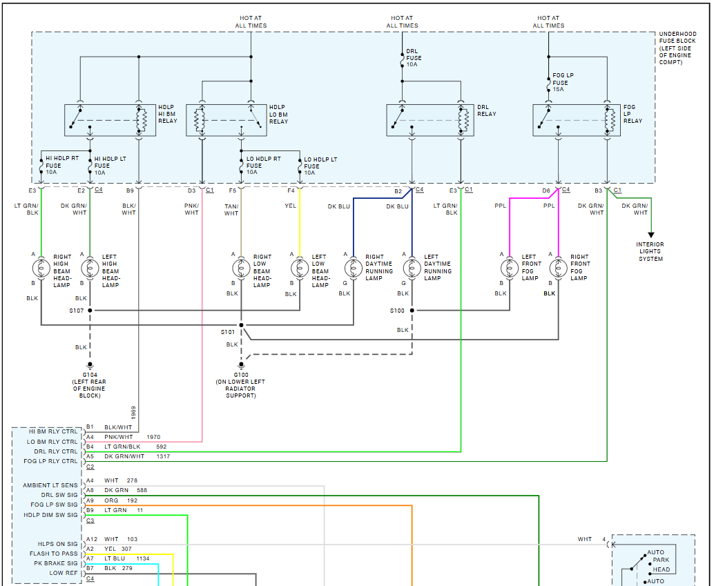

Hello, my headlights seem to not be working correctly, and I think it might be the switch. I just purchased this car a week ago and need to fix it ASAP. I think the switch might not be making a good connection. A wiring diagram of the front headlight system would be greatly appreciated! Thank you.
Apr 28, 2025 at 6:23 PM
  • 54,503 POSTS

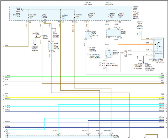

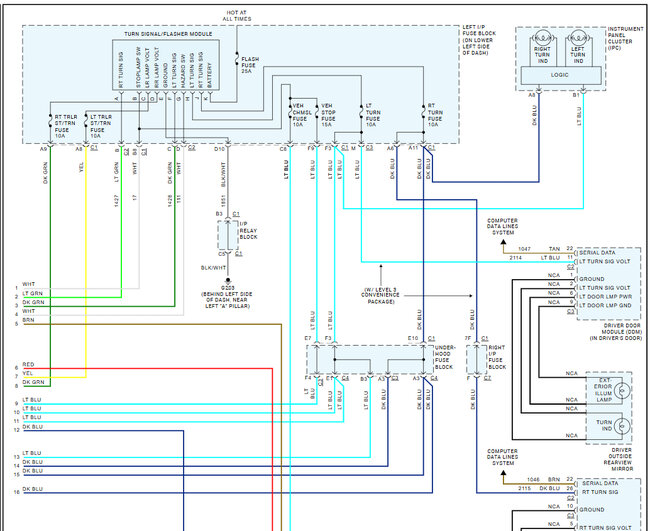

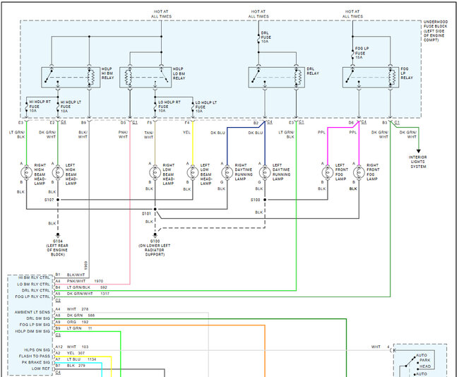

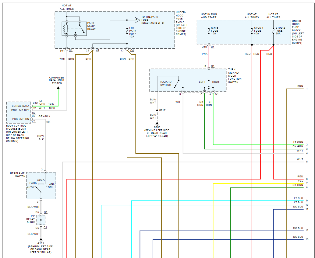

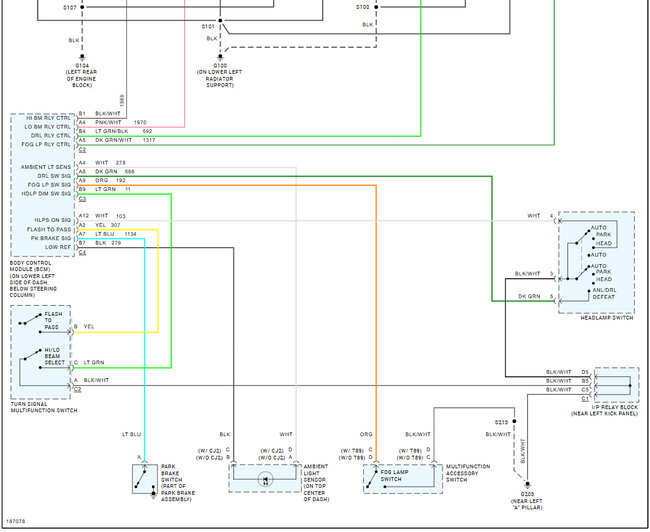

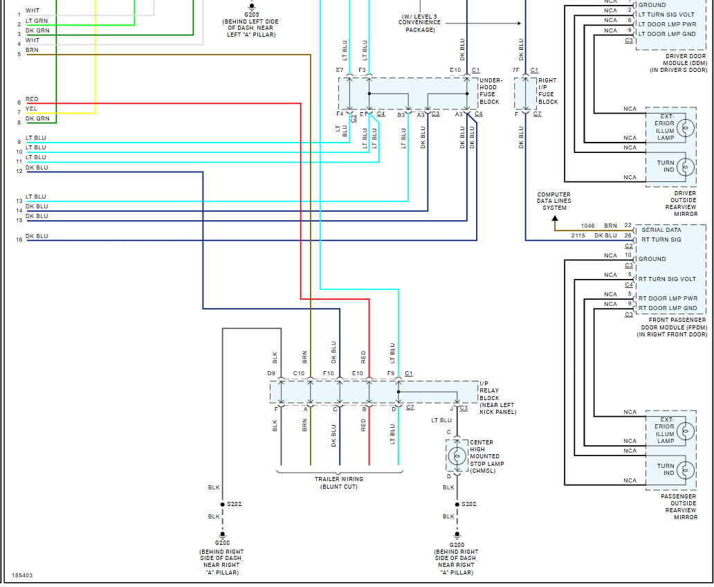

There are 6 fuses, four relays and the BCM that controls the headlamps, I would check these first, here is a guide to help you test the fuses and I have included the headlight wiring diagrams to show you which fuses and relays to check.
Check out the images (below). Let us know how it goes, please get back to us!

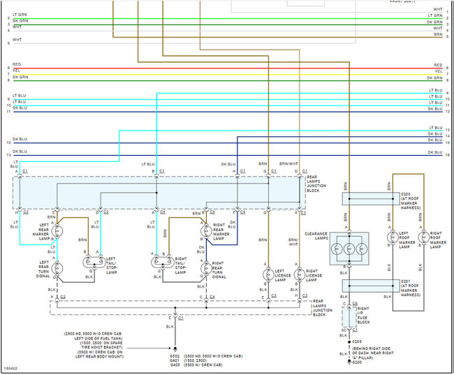

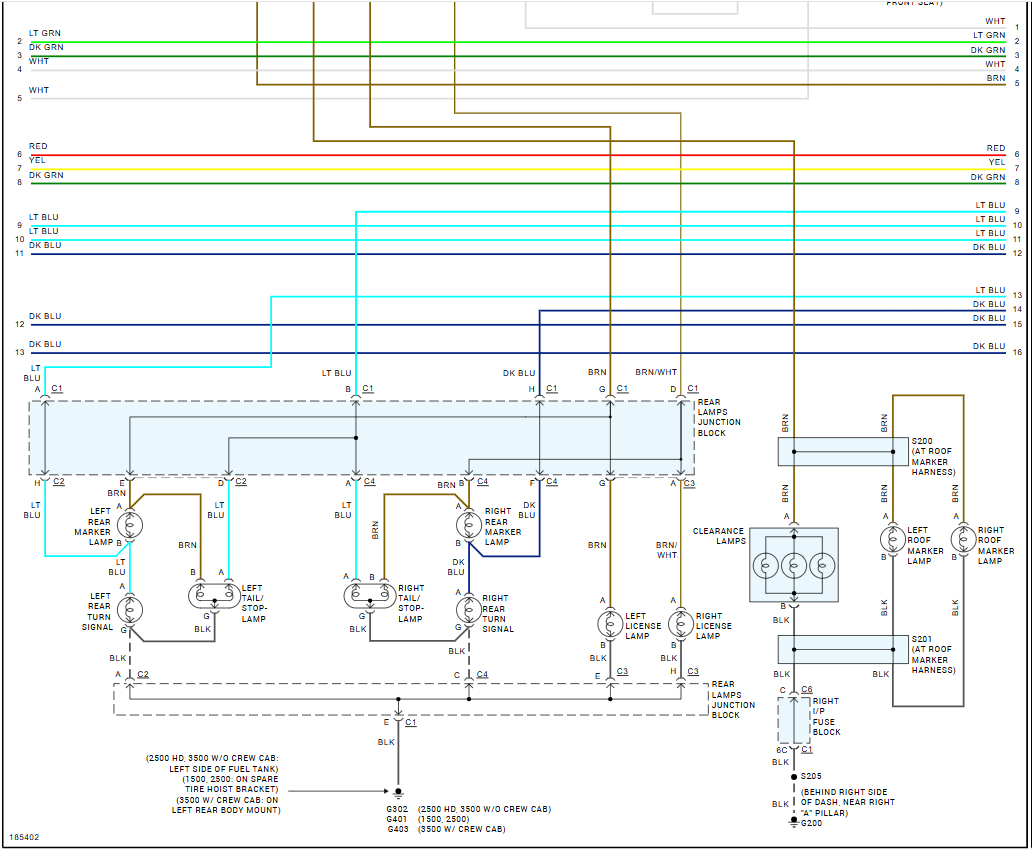

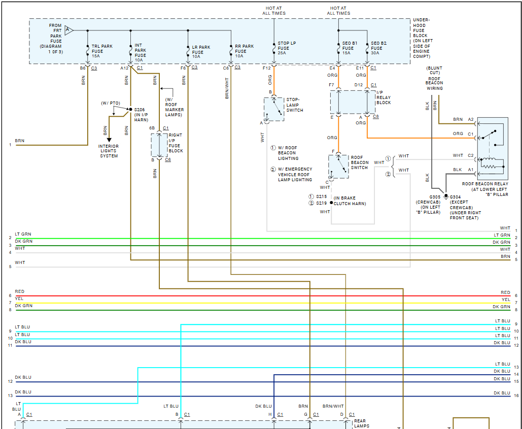

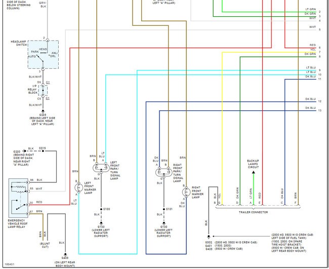

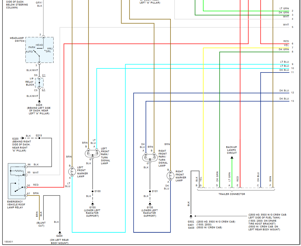

Thanks. Just so i can get a better visual, is there one on the parking lamps/side markers as well?
Apr 29, 2025 at 12:52 PM
  • 54,503 POSTS
Sure, here is the running light wiring diagrams as well. Let me know how it goes.
Apr 30, 2025 at 10:19 AM
