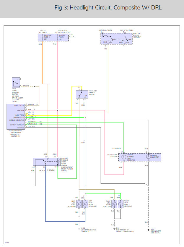

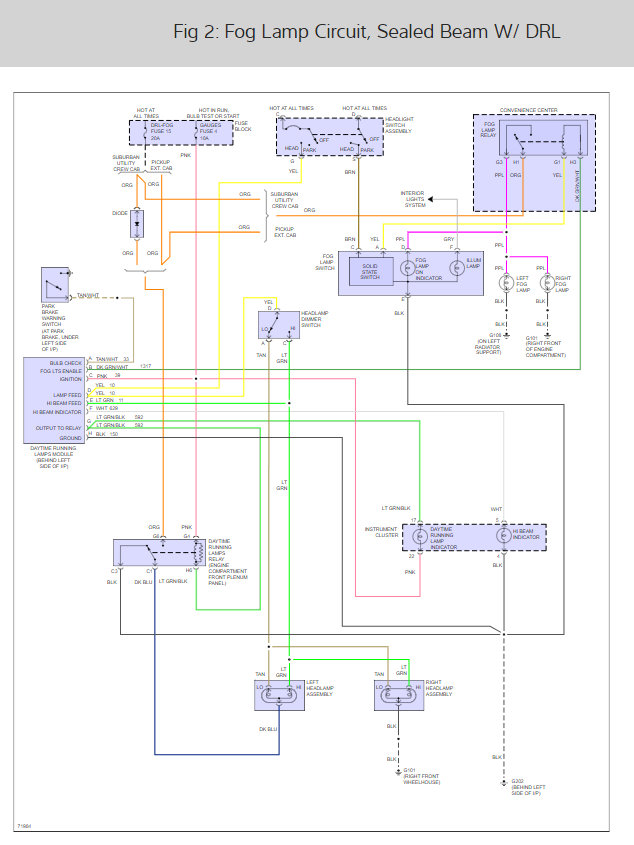

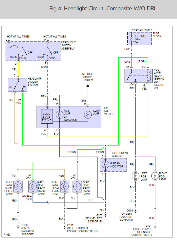

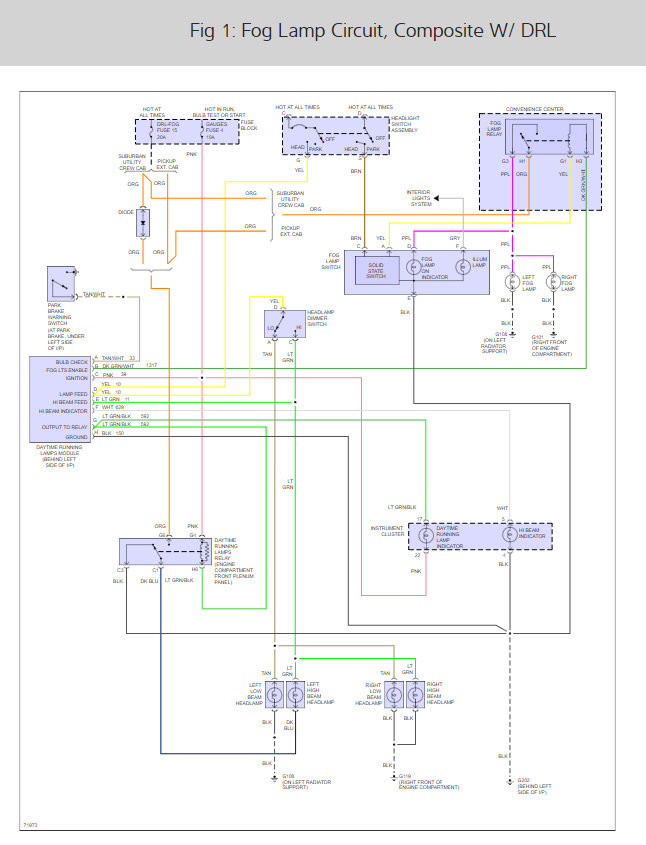

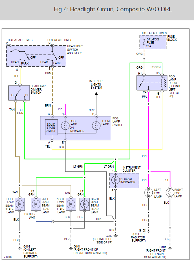

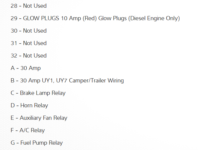

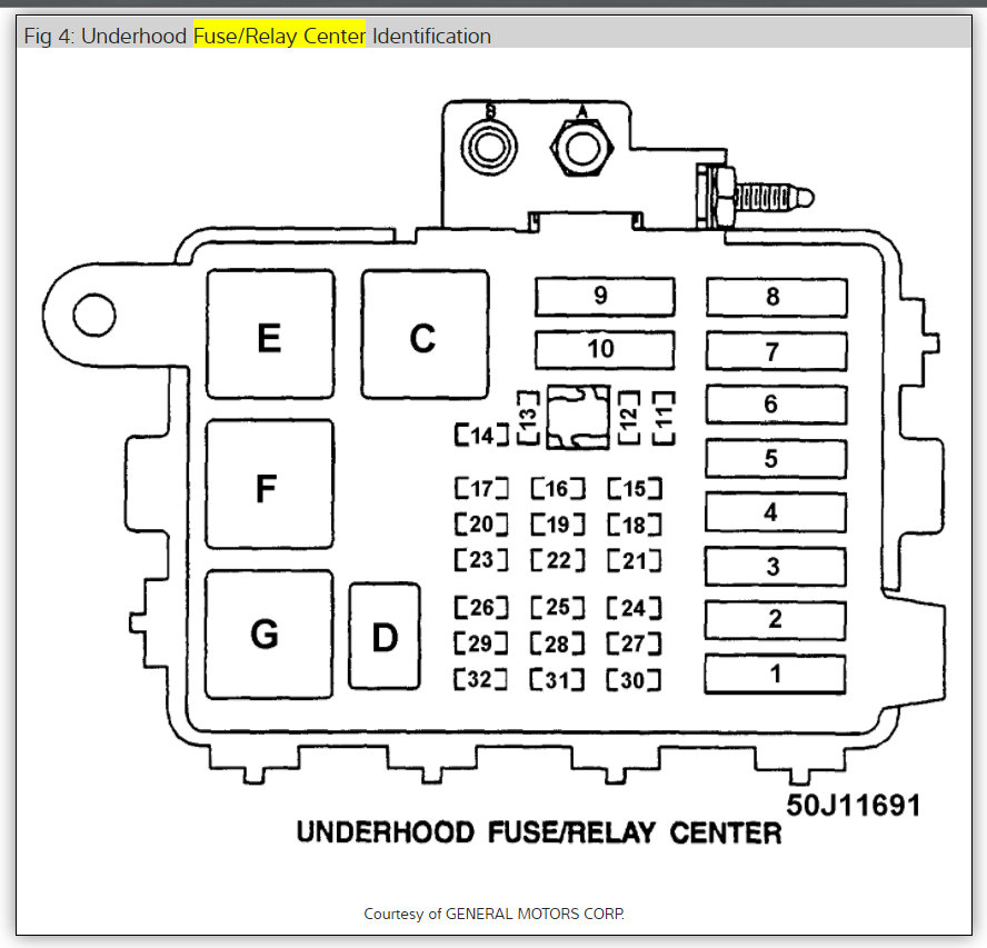

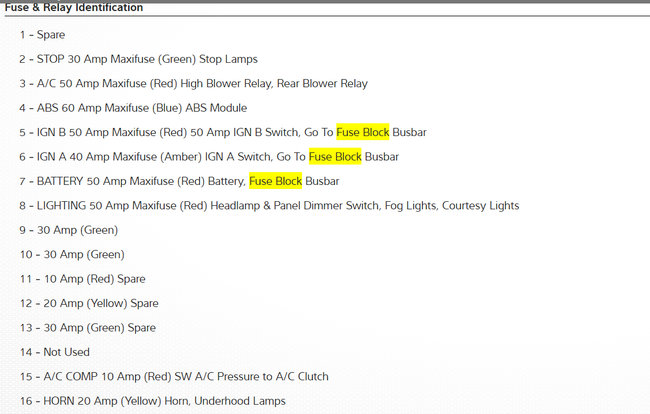

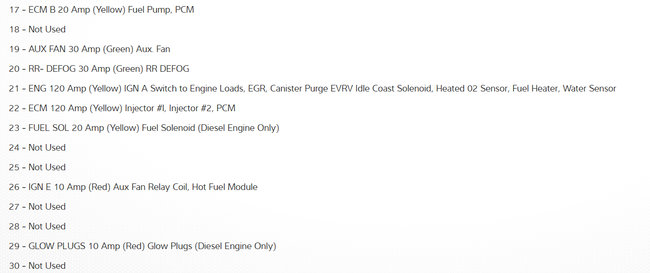

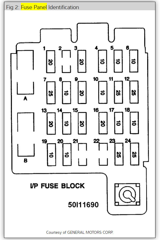

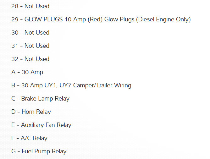

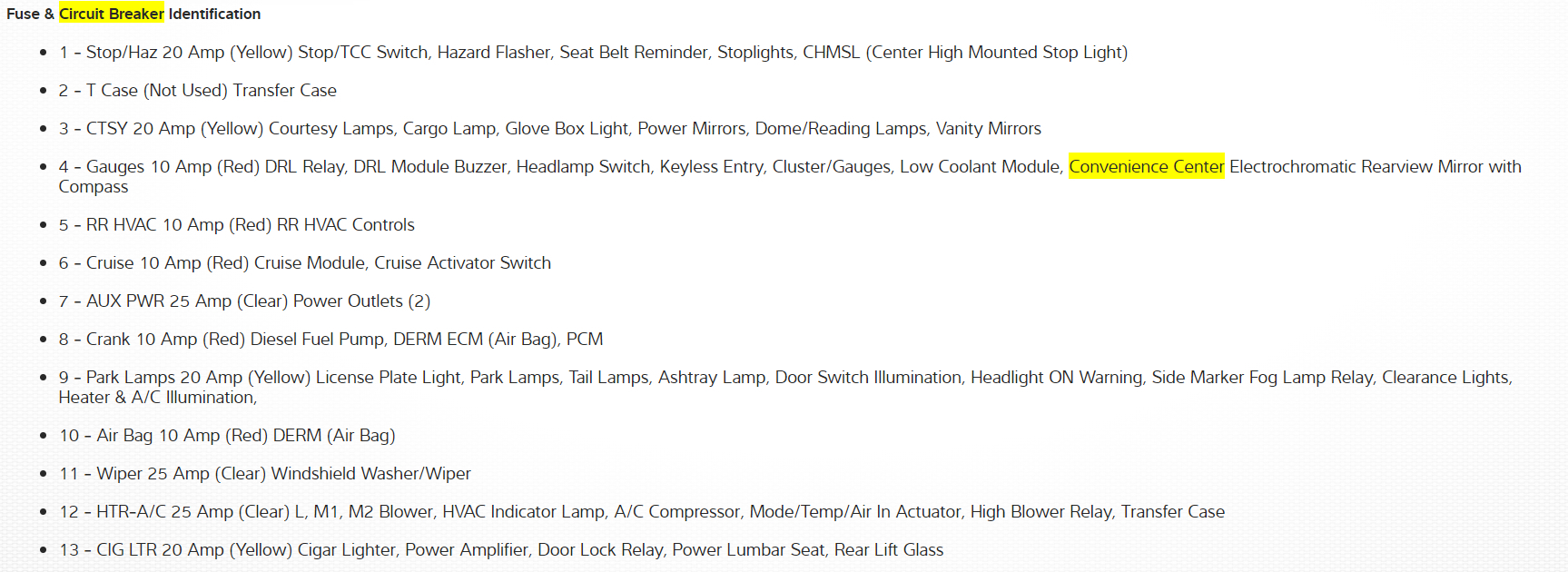

All lights working except the headlights.
Monday, April 9th, 2018 AT 12:13 PM
KEN L
MASTER CERTIFIED MECHANIC
55,064 POSTS

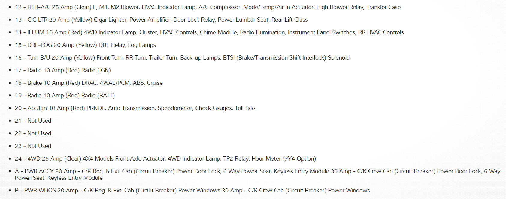

It sounds like both headlight bulbs are out. Here is a guide to help you see what you are in for when doing the job:
https://www.2carpros.com/articles/how-to-replace-a-headlight-bulb
If the bulbs are okay then lets use this guide to test for power at the switch there are wiring diagrams below to help us see where are are loosing power. Also check the fuses.
