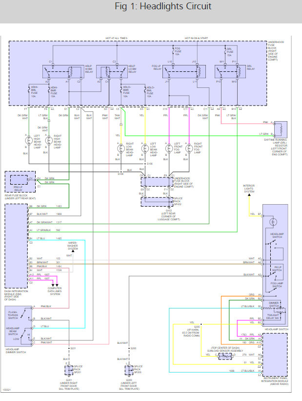

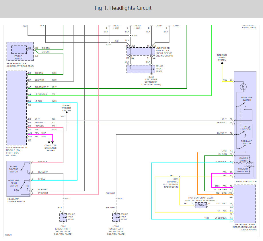

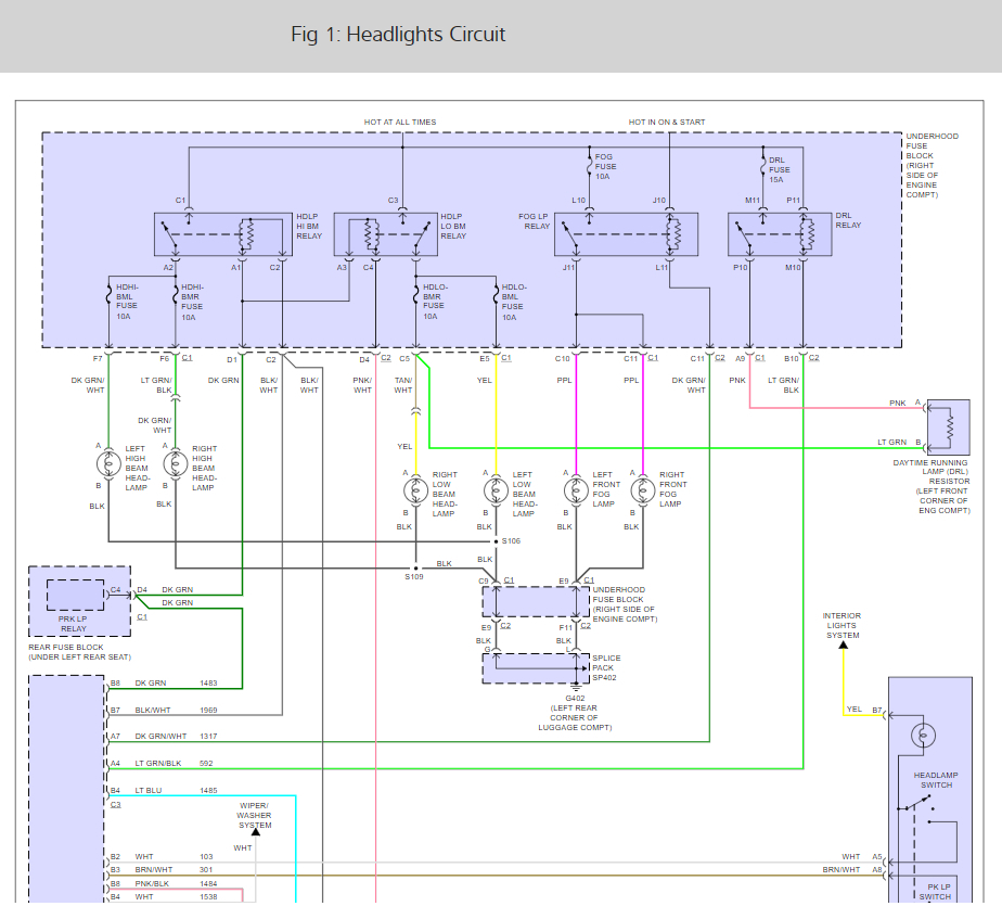

Headlights inoperative
OWEN ARMSTRONG
MEMBER
2003 CADILLAC DEVILLE
160,000 MILES
Headlight switch testing information needed.
Wednesday, April 4th, 2018 AT 8:26 AM
KEN L
MASTER CERTIFIED MECHANIC
55,488 POSTS
Here is a guide to help you see how to test for power lose and the headlight wiring diagrams as requested:
