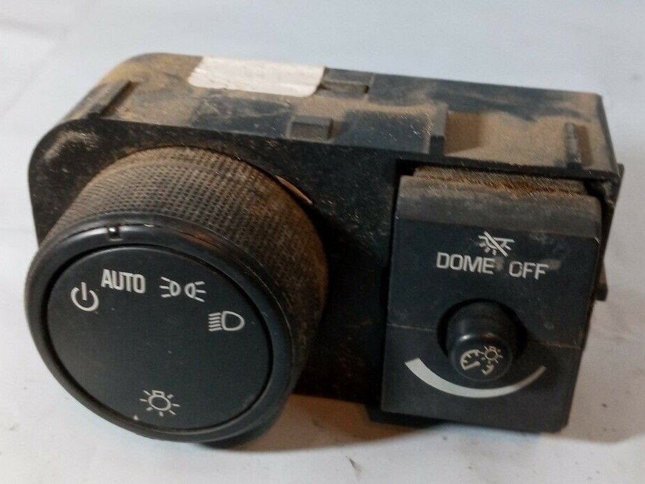

I am looking for a wiring diagram for the headlight switch located in the dash. I am trying to retrofit this module into an older truck.

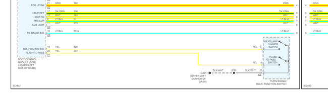

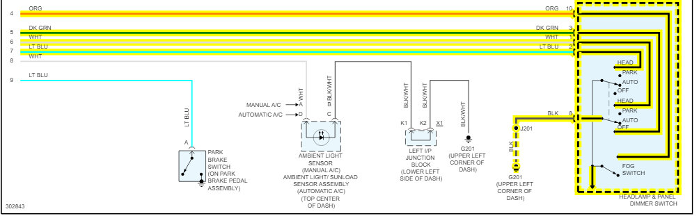

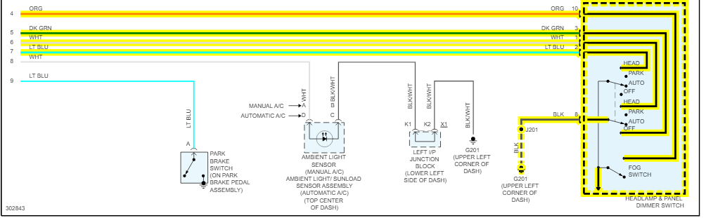

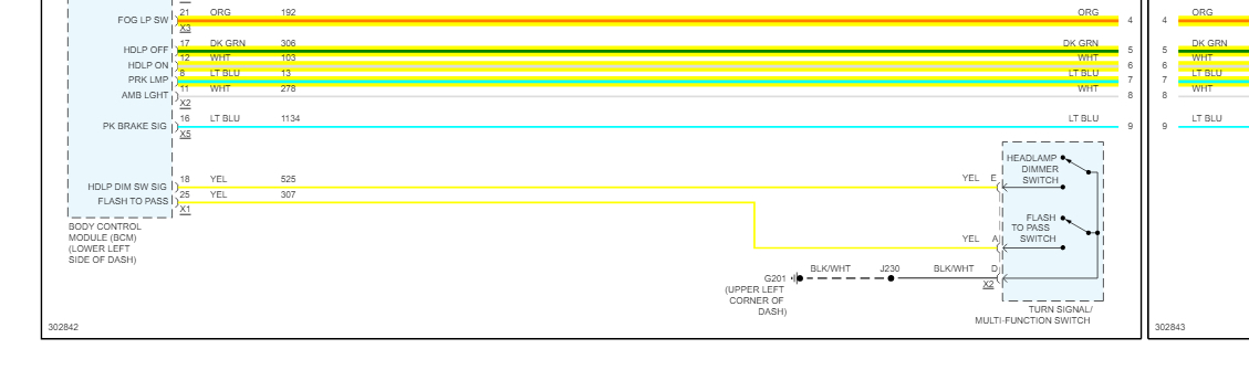

I have attached the wiring schematics for the headlight switch below.
