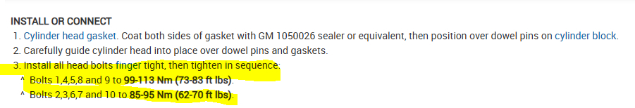

Long bolts 73 to 83 short bolts 62 to 70. If so, what increments should I use?
Dec 1, 2024 at 5:33 PM
  • 54,520 POSTS
Tightening in Increments:
Long bolts (73 to 83 ft-lbs): Tighten in 3 stages.
First stage: 25 ft-lbs
Second stage: 50 ft-lbs
Final stage: 73 to 83 ft-lbs (to spec)
Short bolts (62 to 70 ft-lbs): Tighten in 3 stages.
First stage: 20 ft-lbs
Second stage: 40 ft-lbs
Final stage: 62 to 70 ft-lbs (to spec)
Let us know if you need anything else.

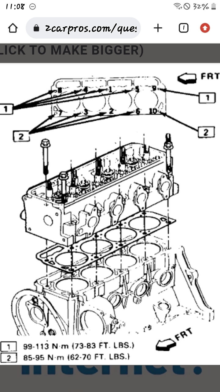

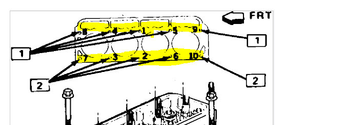

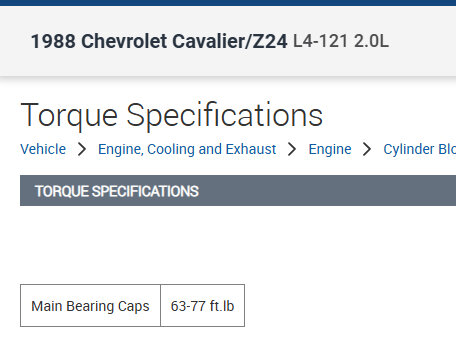

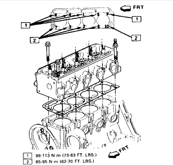

I need crank bolt torque specs and head bolt tightening sequence.
Apr 29, 2025 at 12:09 PM (Merged)
  • 110,193 POSTS
I was able to find only one picture with the head bolt sequence. I attached it. I also attached its torque specifications because there are two different specs for different bolts.
The last picture is the main crankshaft bearing torque. I believe that is what you were looking for. If it is wrong, let me know.

I meant the bolt that holds harmonic balancer on.
