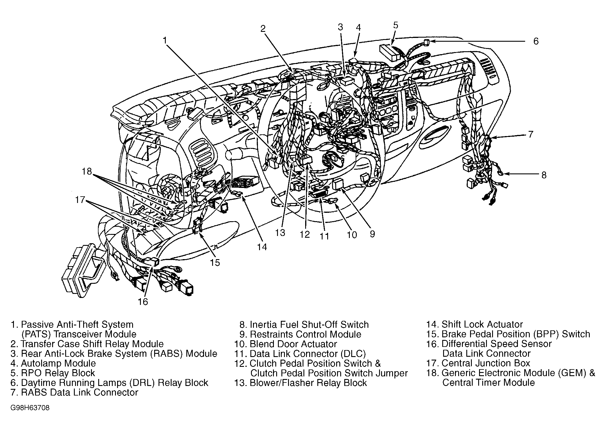

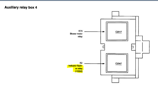

Sounds like you have a bad flasher relay. You should be able to get one for $10.00 or $15.00 from the parts shop. I am attaching an image with the location of it, but it is not particularly clear. Sorry.

It sounds like the flasher is bad here is the location in the diagram below. Check out the diagrams (Below). Please let us know what happens.

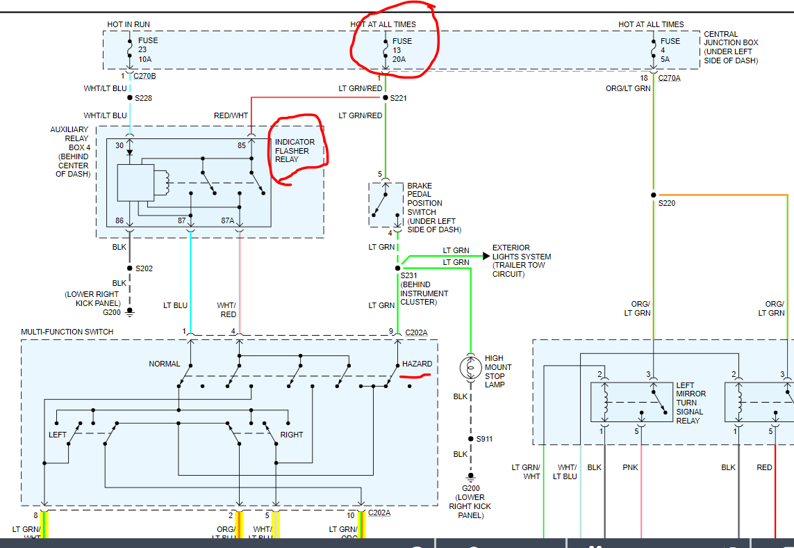

As the title says, as of this morning my turn signals quit, and I tried the flashers and still nothing. The arrows on the dash also don't light up. The taillights and ambient lights all still work but no signals at all. First thing I did was check the fuses, they all checked out. I've had a similar problem with the lights being blown and it blew the fuse to the turn signals but I've had that fixed for a good while so this issue is new and different. I'm thinking it's the multi-function switch in the steering column because I have to drive with the steering wheel adjusted all the way up in order for the lights and turn signals to work, I have no problem replacing it I'm just afraid it won't fix the problem. There shouldn't be much more that could cause this that I can think of, can you guys tell me if there's anything along the way I should check out like maybe a relay or an extra fuse under the hood and where it would be? Thanks!
Oct 14, 2020 at 2:53 PM (Merged)
  • CAR REPAIR CONTRIBUTOR
  • 110,193 POSTS

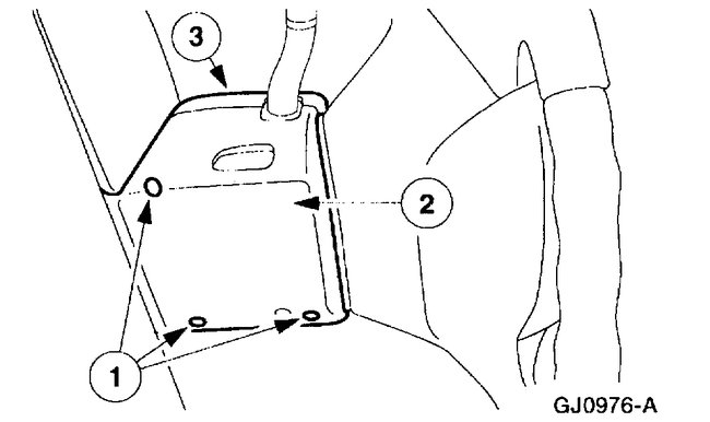

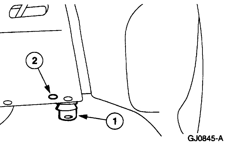

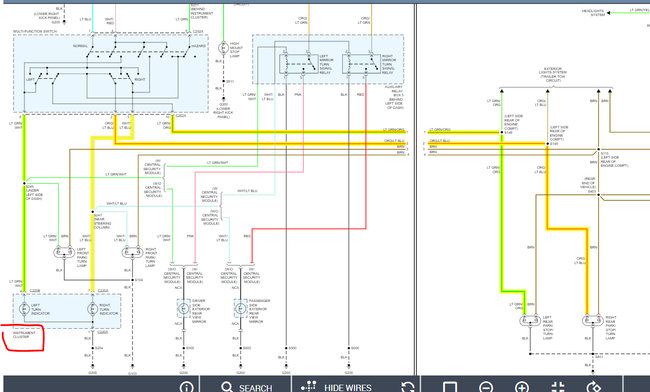

I looked through the schematics for your vehicle. Make sure the two fuses in pic 1 are good. Both are located under the dash. Check both that I indicated. If they are good, then the next step would be to check for power to the relay. There are two supplies, a red wire with a white tracer, and the other one is white with a light blue tracer. If there is power to the flasher, then confirm it makes it to the switch.

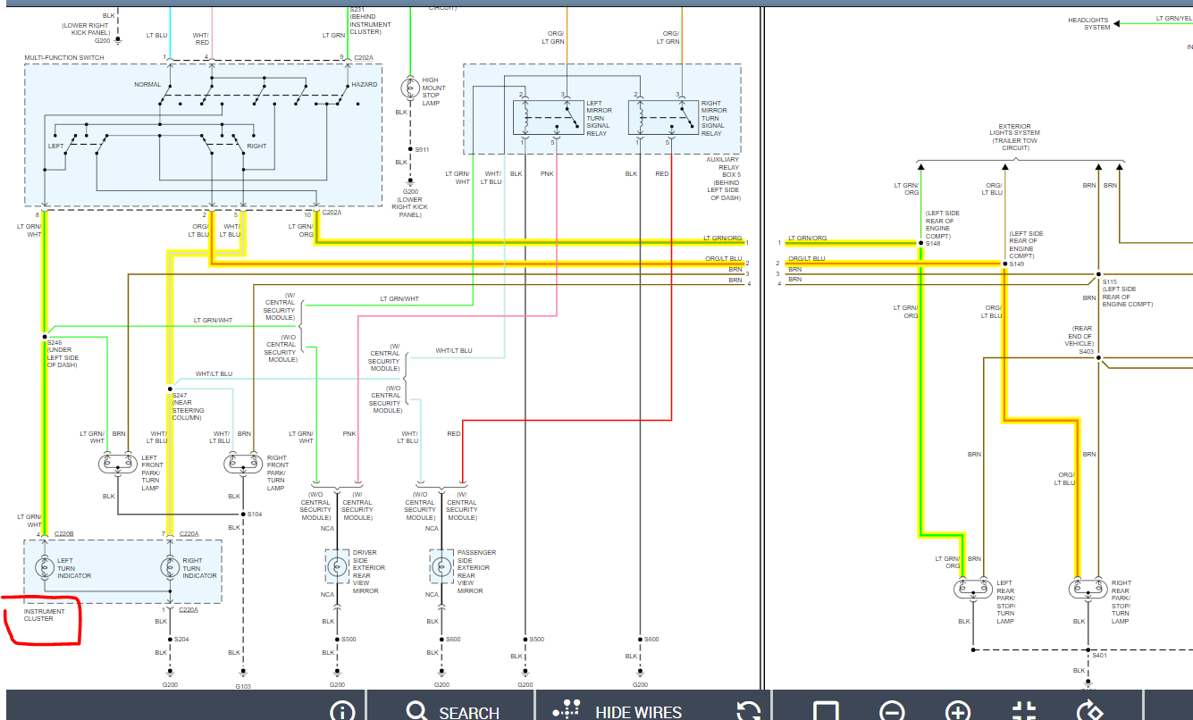

Next, if you look at pic 2, I highlighted the power supply for the signals from the switch to all lights including the instrument panel.
If power makes it to the switch and isn't coming out, the switch is the most likely suspect.

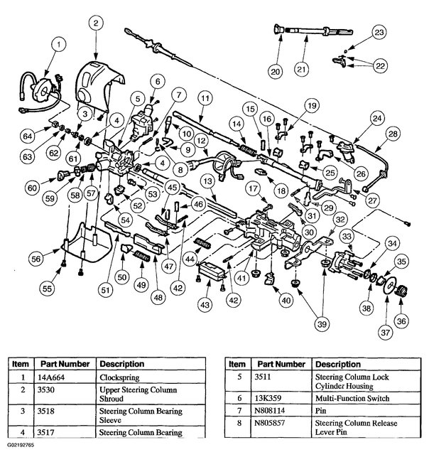

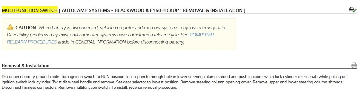

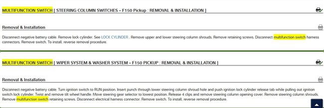

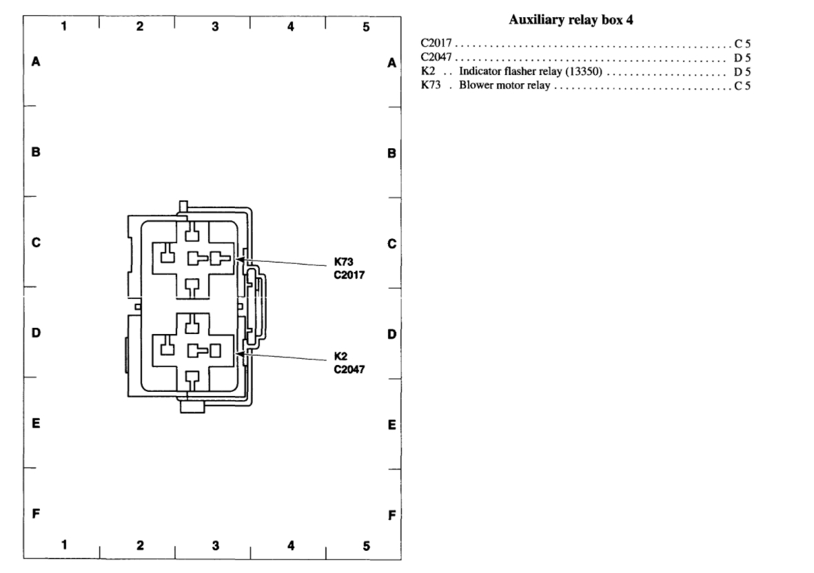

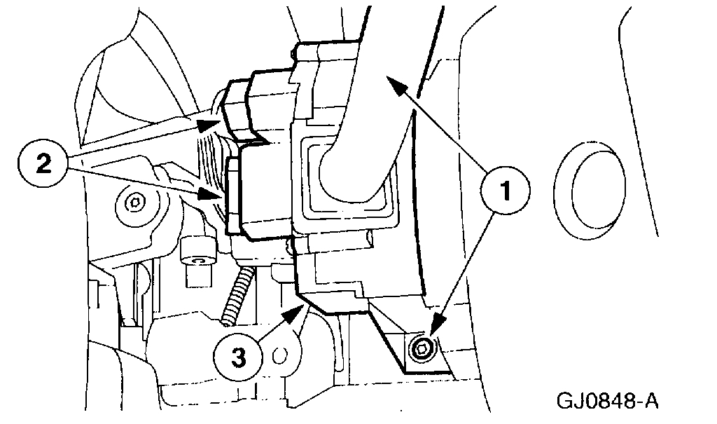

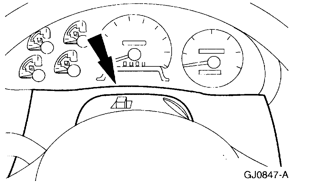

If you determine the switch is bad, here are the directions for replacement specific to your vehicle. The remaining pics correlate with the directions.
___________________________________
2002 Ford Truck F 150 4WD Pickup V8-5.4L SOHC VIN L
Multifunction Switch
Vehicle Steering and Suspension Steering Steering Column Service and Repair Procedures Steering Column Switches Multifunction Switch
MULTIFUNCTION SWITCH
Removal
1. Disconnect the battery ground cable.
2. Remove the ignition switch lock cylinder.

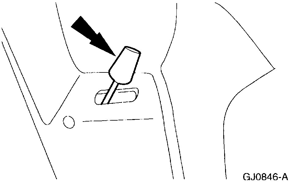

pic 3
1. Insert the ignition key into the ignition switch lock cylinder and turn to the RUN position.
2. Insert a punch through the hole in the lower steering column shroud and push the ignition switch lock cylinder release tab while pulling out the ignition switch lock cylinder.

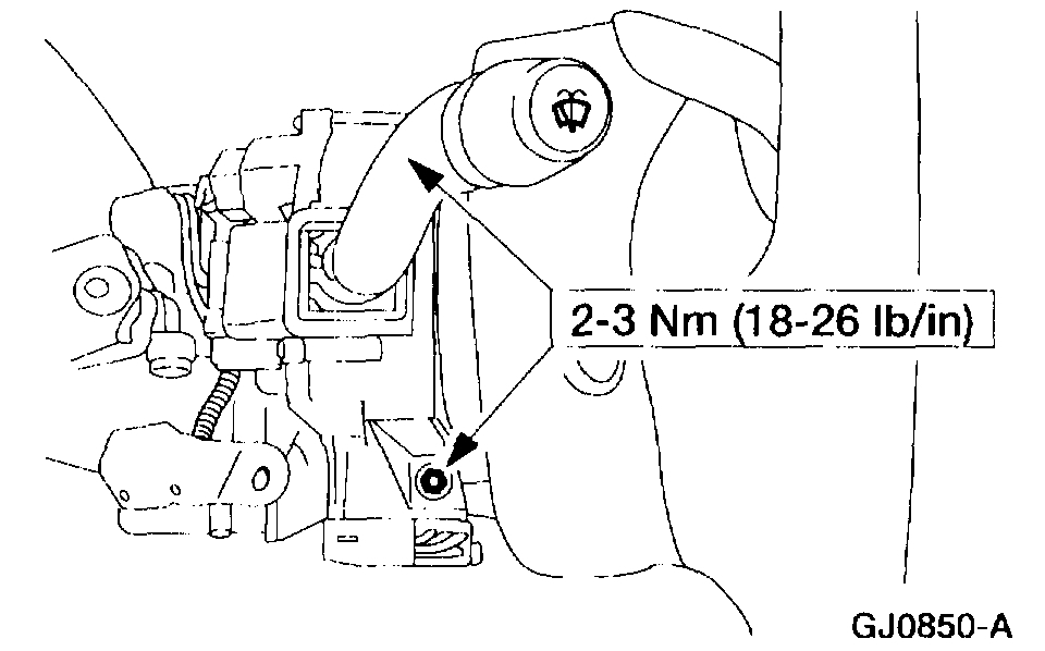

pic 4
3. Twist the tilt wheel handle and shank and remove.

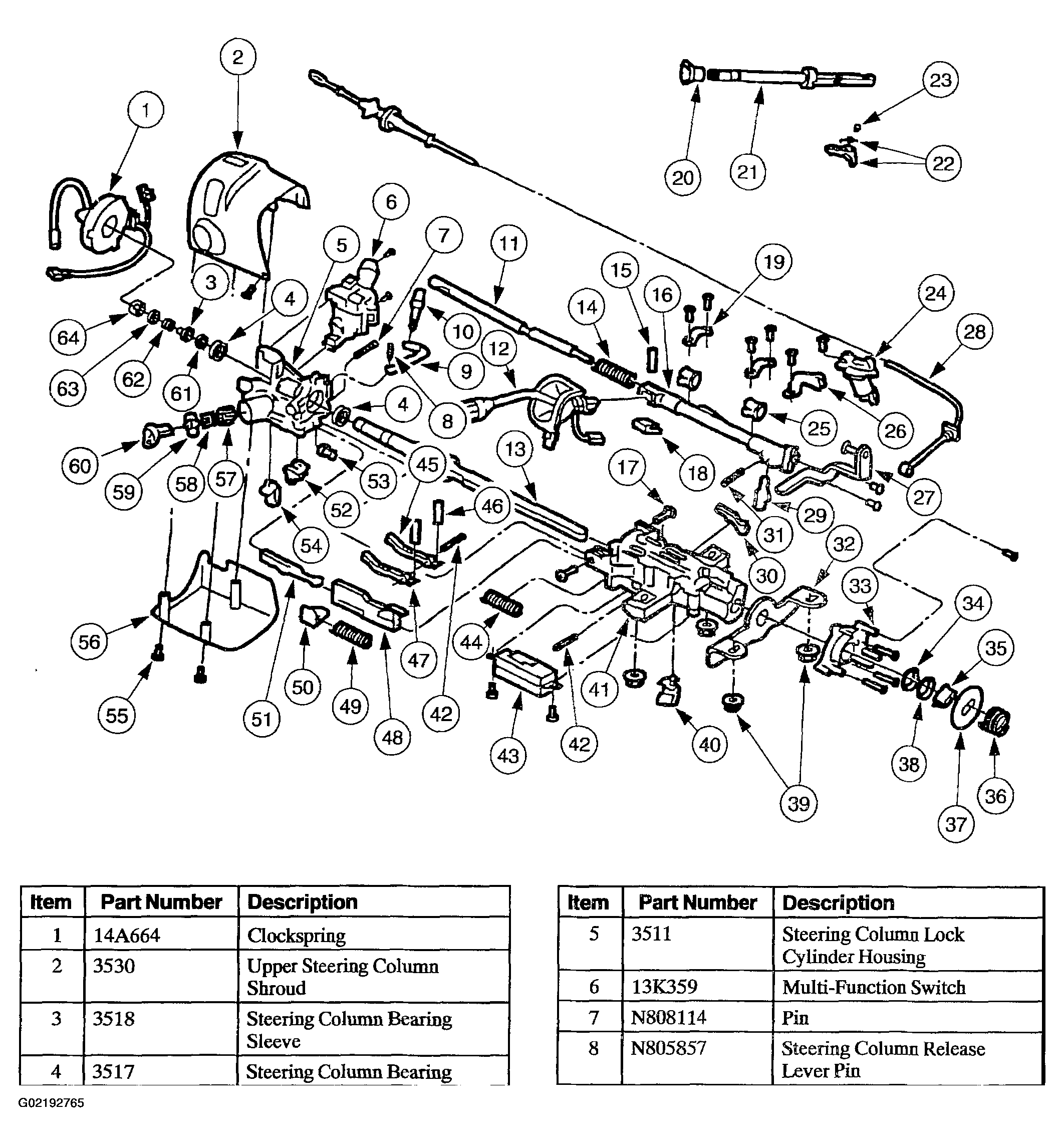

4. NOTE: Move gear selector to lowest position to access steering column opening cover.
pic 5
Release the four clips and remove the steering column opening cover.
5. Remove the upper and lower steering column shrouds.
pic 6
1. Remove the three screws.
2. Remove the lower steering column shroud.
3. Remove the upper steering column shroud.
6. Remove the multi function switch.
pic 7
1. Remove the two screws.
2. Disconnect the electrical connectors.
3. Remove the multi function switch.
Installation
1. NOTE: When the battery is disconnected and reconnected, some abnormal drive symptoms may occur while the vehicle relearns its adaptive strategy. The vehicle may need to be driven 16 km (10 mi.) or more to relearn the strategy.
pic 8
To install, reverse the removal procedure.

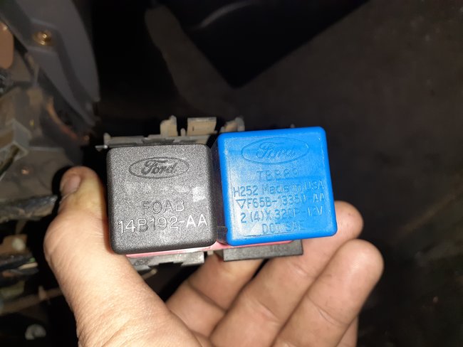

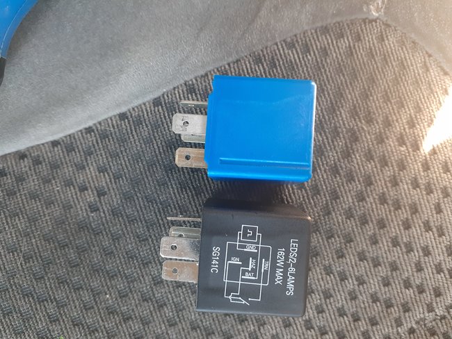

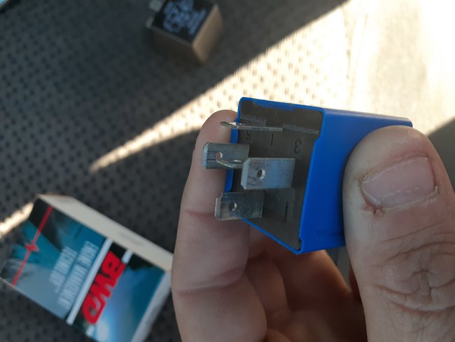

Yes, I checked every fuse on it, under the hood and both sides of the dash. As luck would have it I remembered a box underneath the steering column, it has two different color and sized relay looking components, I was getting ready to pull the blue one out and it started making a funny buzzing noise as I was moving it, I tried the turn signals as I was messing with it and wouldn't you know it they started working again! So as I could tell it seems the blue relay is actually the flasher, it was making the turn signal ticking noise, and I could feel it making the noise, but the turn signals quit again, so I jiggled the flasher and they worked again, so I found my problem. I tried to remove it but it didn't want to come out, I went ahead and bought a new one, but I'm kinda afraid of forcing this thing out, it okay or am I gonna break something if I force it?
TMCINTOSH11
  • 176 POSTS
Oh and no every time the turn signals quit working the brake lights quit too, except for the one above my rear window.

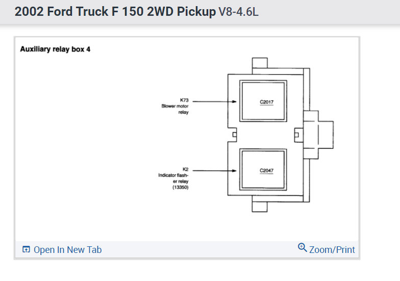

  • 110,193 POSTS

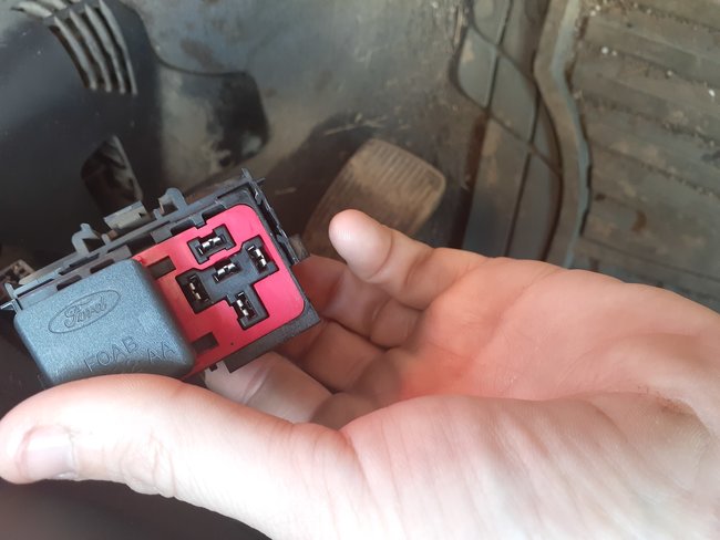

Yep, that's the signal relay. If it is tight, chances are it is corroded. Wiggle it gently when pulling. It should come out.
Once you get it out, check the connectors to make sure they are not corroded or damaged. Before you put anything into the plug to clean it, I would disconnect the battery to eliminate the chance of a short.
Take a look at the pic below. It should look familiar. At least now you know where the blower motor relay is too. LOL
Let me know if you get it out and if it takes care of the issue.

TMCINTOSH11
  • 176 POSTS
Awesome, I was wondering what the other one was. I'm going to work with it best I can, I got some crc electronic connection cleaner I'm going to spray in it before I put the new one in. I'm just so glad it's in an easy to get to location. worse case scenario I can replace the box itself if I have to. I'll let you know how it goes.thanks for all your help!
TMCINTOSH11
  • 176 POSTS
I was able to get the old relay out and the new one in, so far everything's working good. I'm going to keep the relay box within reaching distance encase it acts up again. I also sprayed the connections with crc (with the battery disconnected) let it dry and popped it in. thanks for all your help. if anything happens I'll let you know.
