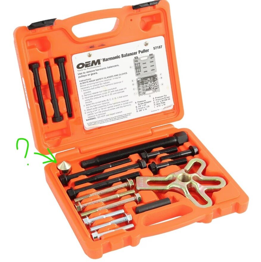

I rented a harmonic balancer removal tool from auto zone. I have the tool connected with the pointed end cap pointed inside the bolt hole and began turning the center bolt. After some turning of the center bolt i am hearing a cracking noise about one per revolution. After about 3-4 times hearing that, I stopped, disconnected tool and now the center cover tip piece is stuck about 1/2 in the center hole. I am worried about continuing tightening the puller incase I am damaging threads, but cannot get cap out to reinstall Crank bolt to use. Any suggestions? I do not know if the pulley has come out at all so far.

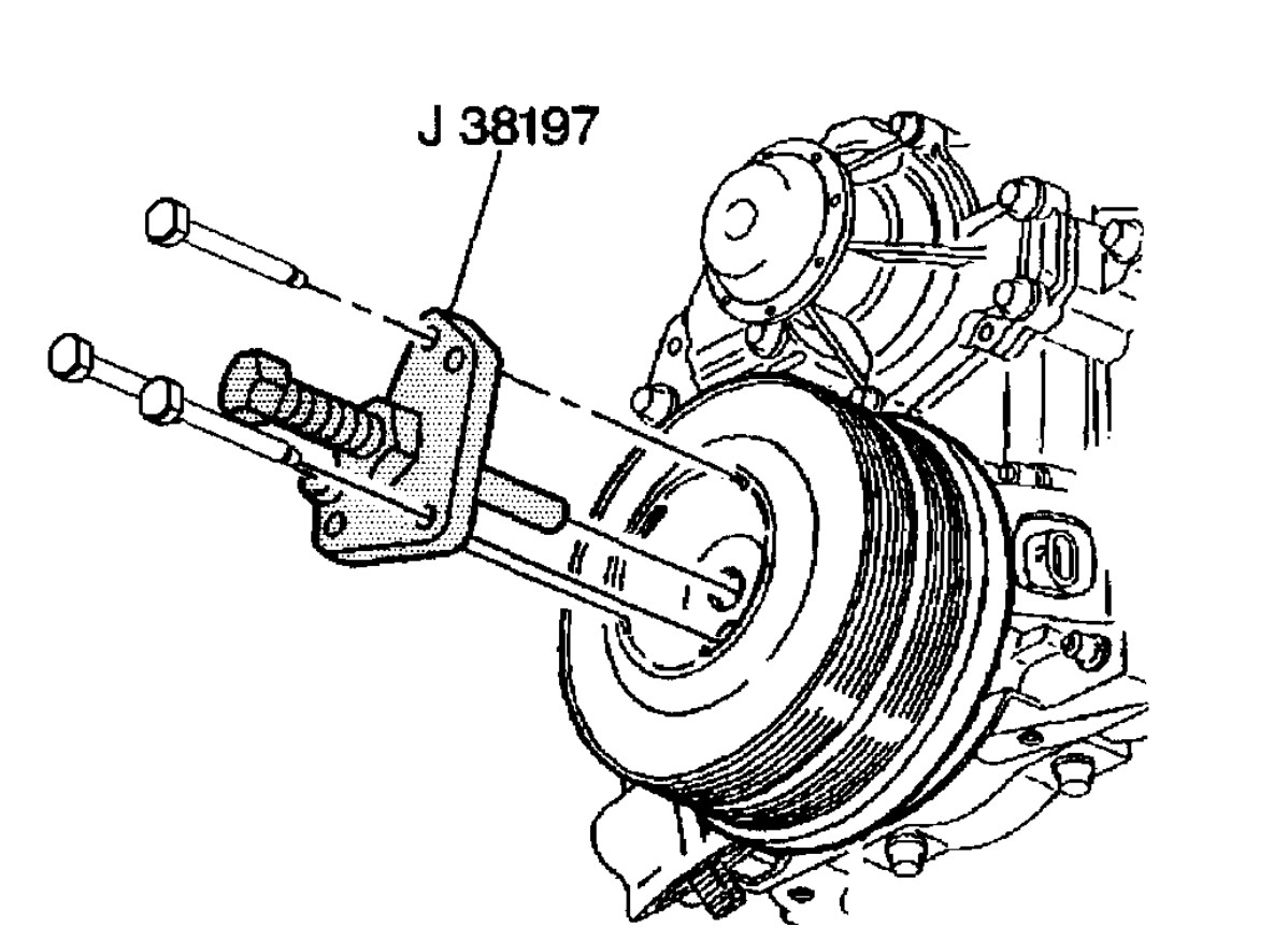

From the description it sounds like you have damaged the internal threads in the crank snout because the conical nose was too small for the bolt hole. Normally when I use that style of puller I will put a spacer bushing in the hole after the crank bolt comes out. That gives you a solid item to push on the crank snout with. What I would probably do in this case is to put something like a socket in there that can fit around the nose cap and gives you something to push against. Might even be able to use something like a plumbing end cap. Then push on that to get the balancer off. Then you can access the piece that is stuck and might be able to use the pushing ram to stick into it and rock it enough to get it out. The factory puller uses a long unthreaded section to push on the crank inside the threads. I'm guessing you have one like the second image and the green is pointing at the cap? Or is it something else?

Yes, that second picture is what I used, and the highlighted piece is what I was saying was stuck. I thought it was jammed into the threads, so I just ran an impact on the center bolt and balancer came off and the tip was just at the snout, not inside the threads thankfully. So all is good and nothing was damaged. I just saw it what looked like the tip was pushed too far in and it was stuck and thought the worst. Thank you for the reply.
