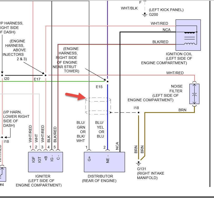

Sir, the wire from the brain box to the distributor is four with this colors black, red, blue and yellow now the female socket got broken. How do I know I fix this wires to another socket with different wire color? How do I time the two? The car is also hard starting.

This is what we show for a 2.2L 1996 Camry in US. Blue wire to crank sensor arrow points to ECM wire.
